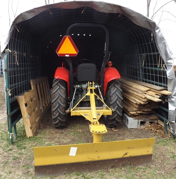

So then yesterday I had to take the afternoon off work to actually get the tent shed erected and completed, in order to get some things stored inside it before a winter storm of snow/rain/freeze/WIND is hitting right now as I type.
It was kind of a real bear to assemble this thing by my lonesome, not gonna lie. But it went ok to get the poles together, and then I could use my front loader to help pick up half the weight and allow me to position it atop the foundation walls.
A couple things I did to hopefully help lengthen the lifetime of this structure: Added a spare tarp over the midsection of the poles, to effectively serve as a second covering layer. Another flaw with these structures is that the span between the horizontal poles (ridge/peak to side bars) is too wide, so any snow/rain makes the cover sag horribly, and eventually fail. An easy thing to help is just to run a pair of ratchet straps near the middle of this free span - they can be tightened enough to help hold up the cover without distorting the frame.
Pulling the top cover over by myself was also tough, but working the front/rear ends back and forth, and she came over. A lot heavier duty that their smaller 10x17 shed cover.
Then it got dark but I still needed to shuffle my things around to make use of it. It was a lovely calm 35 degree evening to keep working into the night a bit.
I gathered up all my tractor 3-pt and SSQA implements/attachments that I don't need during the winter, and placed them on my 20' car hauler. Then used my SSQA trailer hitch to ease the whole load into the shed! Now the trailer is like a rolling drawer for storage, haha. Worked out pretty slick.
