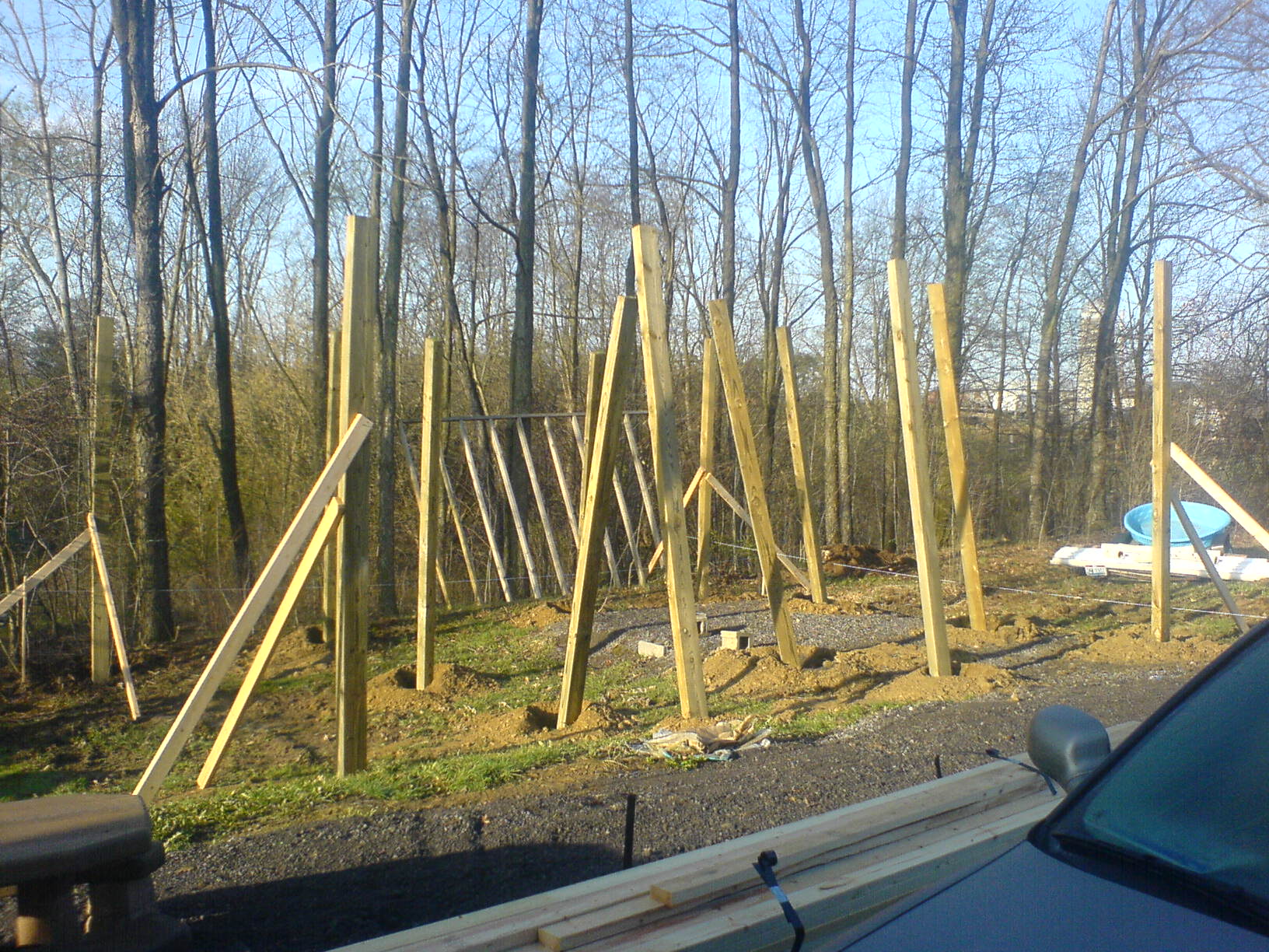

Your right, I had the post holes dug out on Saturday. I dropped the 13 posts by sunset. It rained Saturday night so Sunday morning was spent using the manual post hole digger to pull up about a foot of mud from the bottom of each hole... well at least the first 8 then it dawned on me that I could leave the muck there and just reposition them with a sledge and a sloppy golf swing . :D
By the end of the day yesterday I had the four corners plum, square and braced. I should of got more done but I had a few other side jobs to contend with like cleaning out the chicken coop (which was way overdue). :(

Something just dawned on me... the footprint is going to be 24 x 24. Depth I made the posts 22' so the 24' trusses would have 1' overhang each side.
From one gable end to the other though I didn't think about overhang... the posts are 24' outside edge to outside edge. Is this going to be an issue later?

A framing nail gun works fine on a small compressor. The guys building crates that sound like machine gunners need more compressor. You won't. Just keep all body parts more than a nail length in any direction from the barrel. The nail gun will not stress the already built part like hammering does.
The ends should overhang beyond the trusses to protect the ends of the building from the weather. The posts are in place so you will need a little more roofing.

Tonight was not a good night... I remeasured all the sides and diagonal and one of the poles shifted quite a bit. :mad:
Of course we've had rain and the hole has partially filled in. Trying to reposition it with it like it was wasn't working... using the post hole digger around the post was a pain... ended up pulling it out.
Of course I spent 30 minutes trying to do so manually... using the tractor didn't dawn on me to I was pretty worn out. Then I ended up nailing a 6" 2x4 to the post (about two feet up), slid the lip of the bucket under it, raise it a foot or two, then used a cinch strap over the FEL arms under the bucket and around the post to keep it from tipping. Then it lifted right up with no effort. :eek:
I cleared back out the hole with the manual post hole digger (did I mention I was already worn out BEFORE starting this...:() then set back in the post.
After all that I still can't get it right where I want it. :mad:
I called it quits for the evening... here's a quick photo from Sunday.

Sorry to hear about the tough time getting the posts where you want them. For tamped posts you pretty much have to be able to accept a 1" position tolerance. You can brace a post in a clean hole and pour concrete to get more accurate or do concrete piers and brackets to bolt the posts to them.
I like a chain around a post for pulling it. For setting them too when I do power pole posts.
Your site does not look level. Are you planning on a raised floor? If not and it's really not level I would pull the posts, level the site, and start over (Yikes!) You will never be happy with a sloping floor.
