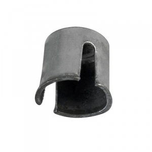

2009 Infiniti G37 coupe, 35K miles. Battery dead this morning. It is warm here. Battery is a year old. Will turn the starter over once or twice but no start. Battery has water in it. Moderate corrosion around terminals. Notice that terminal clamps are loose on terminals but are as tight as they will go. Clean terminals and terminal clamps. Get ride of corrosion.
Still no start. Can't jump it because it is at bottom of driveway. Will have help to push it up driveway in about an hour. I'll jump it then.
That does not solve the loose clamp issue. Rant #1: why in the )~*&$%)*~%$_&*@$^ would clamps not tighten on to terminal posts?????? I think this might be what drained the battery. Question #1: What the $(*#%_(@% can I do about it? Do they make spacers? Replacing the OEM clamps is absolutely out of the question. The positive terminal looks like something from a nuclear power plant or the Starship Enterprise.

You can buy shims that fit over the battery posts. Check AutoZone, etc.

As far as terminal clamps being tightened, I'd wrap them with some copper or lead shim stock and be done with it. You have a tractor, jump it with that or push it to your starting grid.

We got it up the driveway and jumped. Wife has gone to get the shims you showed above. Same company that makes the battery makes the shims. Go figure.
