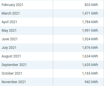

Will have our first full month on the books here in a few days. Will post production vs estimates. This month and Jan will be our lowest production months. I'm seeing a daily production low of 16 kWh on a heavy full cloud day and 100kWh on a full sun day.
/ A newbies DIY solar install #182
Is that 16kWh and 100kWh totals for the day?
#183
Yes. My estimates prior to install for December was 2180 kWh for the month. My highest month should be July at just over 3600 kWh for the month.
/ A newbies DIY solar install #184
