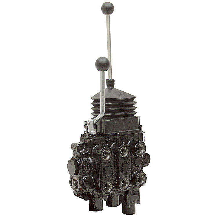

JJ I want to be certain I've understood you correctly.
In my case I have a Kioti NX6010 which is open center. Coming off of the joystick I have a tank hose that goes to my tank and I have power beyond. If I've understood you correctly, I do not want to T into power beyond as a parallel, I want to tap into the power beyond in series using an open center valve like the 9-6136. From the joystick into the P on the sub plate and from the T on the sub plate to the (formerly same hose) that in my case is chasing off to spool valve for the rear remote, thus make a series circuit without tapping into the tank line whatsoever.
Is the series circuit I've described above, correct? Originally, I had thought I'd tap into power beyond in parallel with a T fitting, go through the sub plate and closed center valve and then tap a T into the tank hose to return extra fluid.
If series circuit is right, with the open center valve like the 9-6136, which sub plate do I want to use? In other words, with an open center valve, do I also need the open center DO3 sub plate like the 9-5883-1?
Or, because the DO3 subplate like the 9-5883-1 is open center (this flowing fluid to the spools and rear 3PT before dumping into the tank), should I not use an open center valve and use a close center valve like the 9-6138?
Thanks, JJ.
/ Installing 3rd Function Hydraulics - Electric over Hydaulic #82
If your tractor is open center, you do not want anything CC.
Everything else you said is correct.

I want to use and open center sub plate with an open center valve?
Or
Do i want to use an open center sub plate with a closed center valve?
/ Installing 3rd Function Hydraulics - Electric over Hydaulic #84
Use open center valve and open center subplate.
/ Installing 3rd Function Hydraulics - Electric over Hydaulic #85
Thanks, JJ.
Now all I need to do is find an open center three position spring centered valve that is open center and flows more than 10.5gpm and an open center sub plate than can take the equivalent of 3/8 or 1/2" fittings. The application flows 17.9 gpm and I don't think i should restrict the flow between the power beyond on the joystick and the three point.

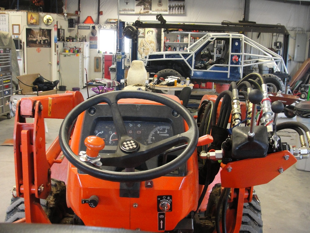

Is your tractor open center hyd?
Do you have any hyd at the back now except for the 3pt?
Do you have a hose going to the back for the 3pt?
You could add a remote to the back with PB and use the PB from the remote valve to power the BH
It might be as simple as adding the valve in series with the 3rd function valve and putting a QD on the remote valve PB line. Your BH would then plug into the PB QD.
When not using the BH, the QD would connect to the 3pt.
Show some pictures of the right side and back side.
The JD750 is open center and I do not have any hydraulics in the back. I included some pictures. So the easiest thing is to add a QD and then loop it when I don't have the BH connected. I don't need any special remote valves or splitters or anything like that?
