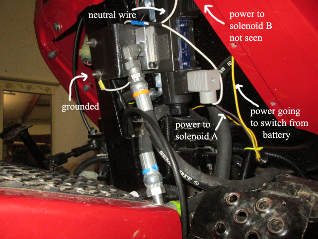

It is described in post 3. You first need to identify your power beyond hose on your loader valve. Mine went to my 3 pt lift in the rear. You simply insert your solenoid valve in-line with this hose. So it goes like this:
Power Beyond>>>>>Solenoid valve>>>>>>3 Pt

It looks right but you have to get the right valve for your tractor's hydraulic system. If yours is open center then, yes. All D03 subplates fit D03 valves so no issue there. J_J or MtnViewRanch were great at answering my questions. You can go to my first post of this thread for a link to all my dumb questions before I started. I posted this and my other thread because I noticed everyone was asking the same questions over and over. Its usually a fundamental misunderstanding about how a hydraulic system works.
