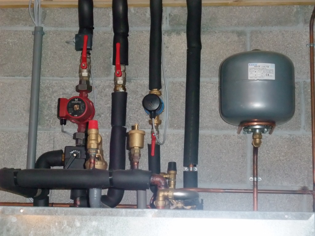

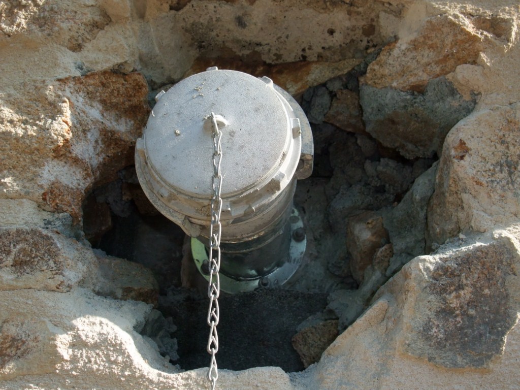

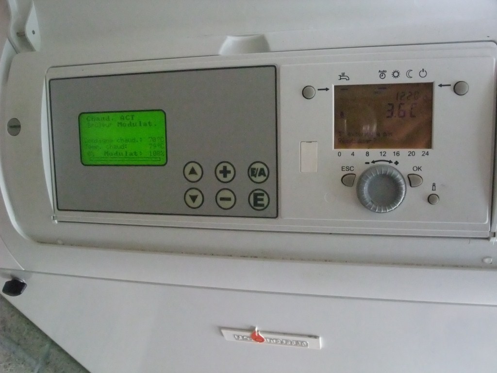

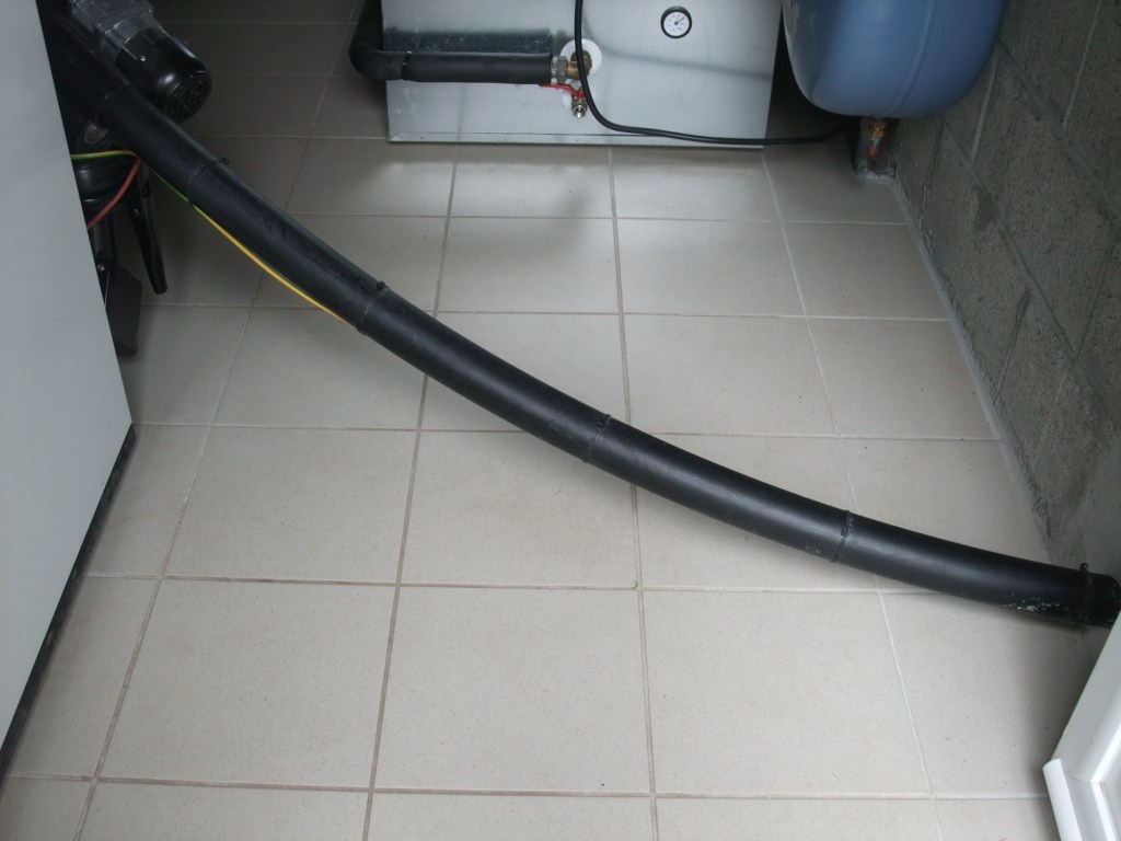

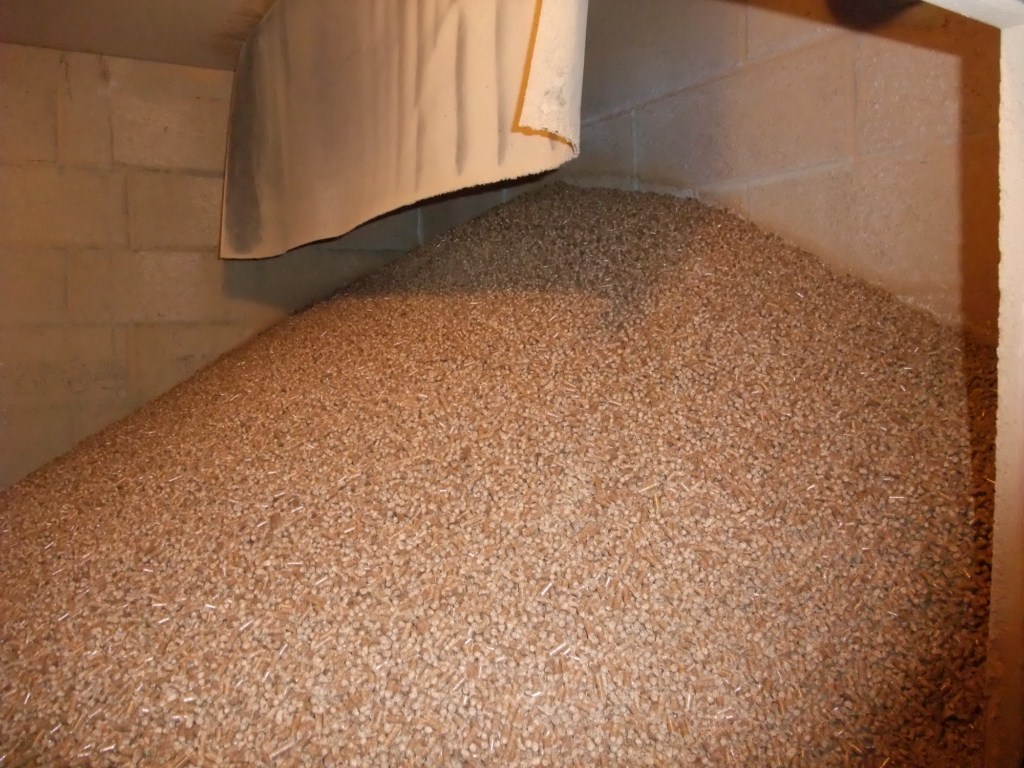

I used to heat the house with electric radiators in each room. I didn't go geothermal because I didn't know enough about it and the regulation to preserve the environment is too complicated. This summer I installed a pellet burner with ample storage space and hot water heating with heaters in each room. No need to handle pellets, they are blown into the silo then taken to the burner by a worm conveyor. Lots of hot water for the bathrooms too. Very comfortable, almost silent and much smaller electric bills.
