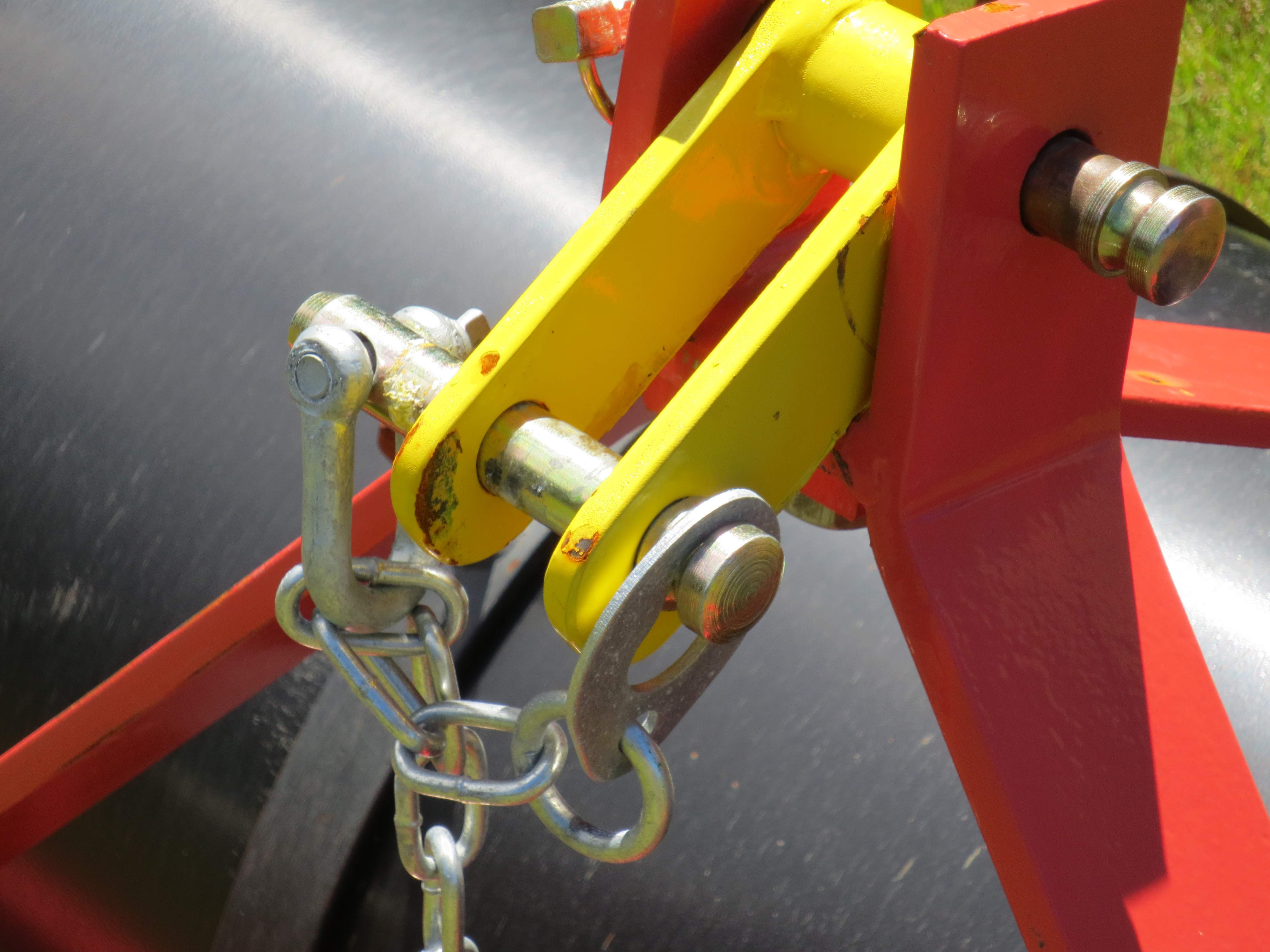

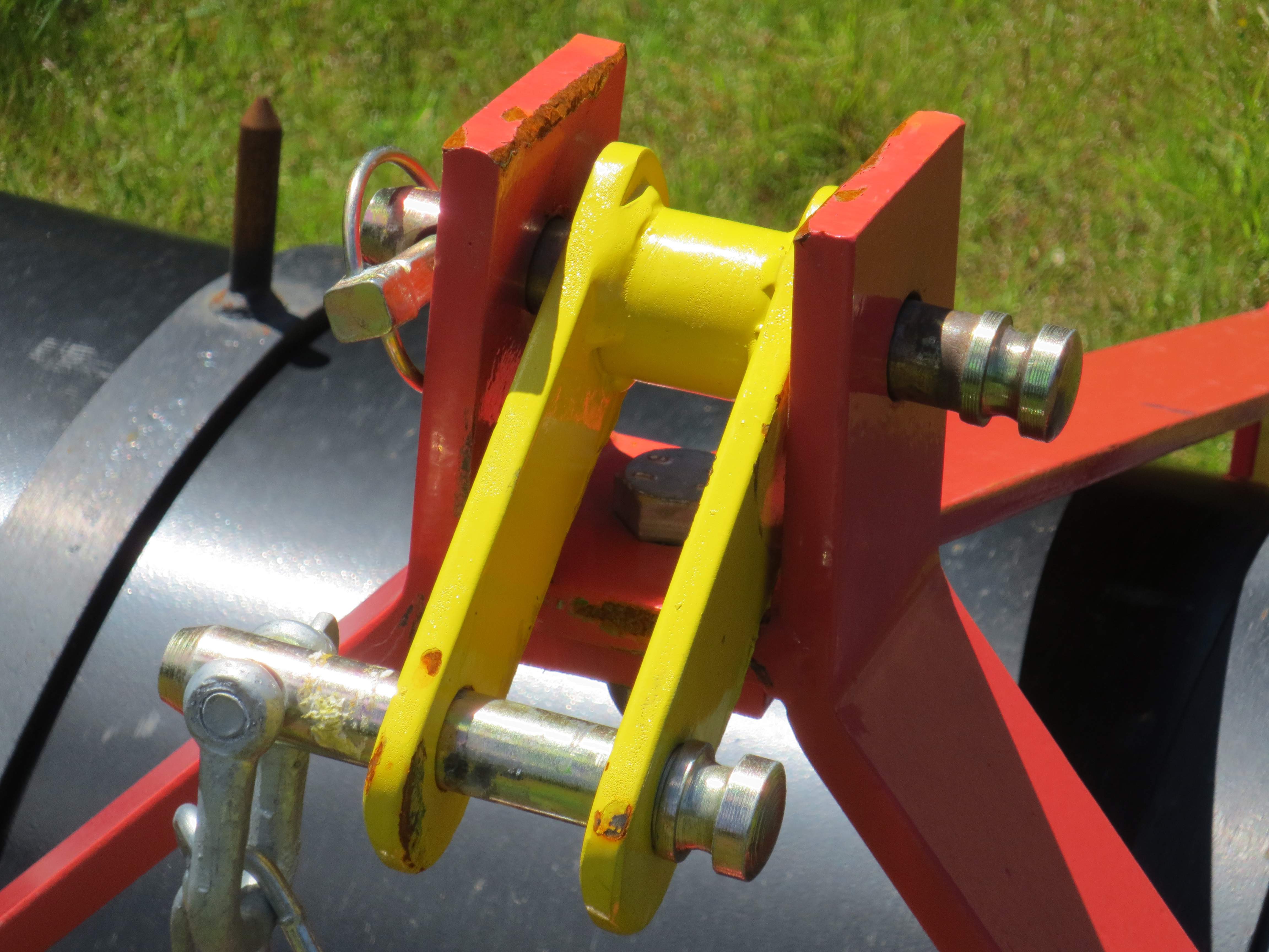

I have an 'older style' iMatch with the non-adjustable top hook. As BRMyers & TractorGuy say, there are adaptors available to extend the top of an implement so that fits in the 'hook' so that it won't bounce out.
I went one further, to ensure that the adaptor didn't 'pop out', and fashioned a "curb chain". I used a fence-gate chain with a drop/slot attachment (I hope I'm describing it properly). They're readily available, here in Australia. Should be in the US.
