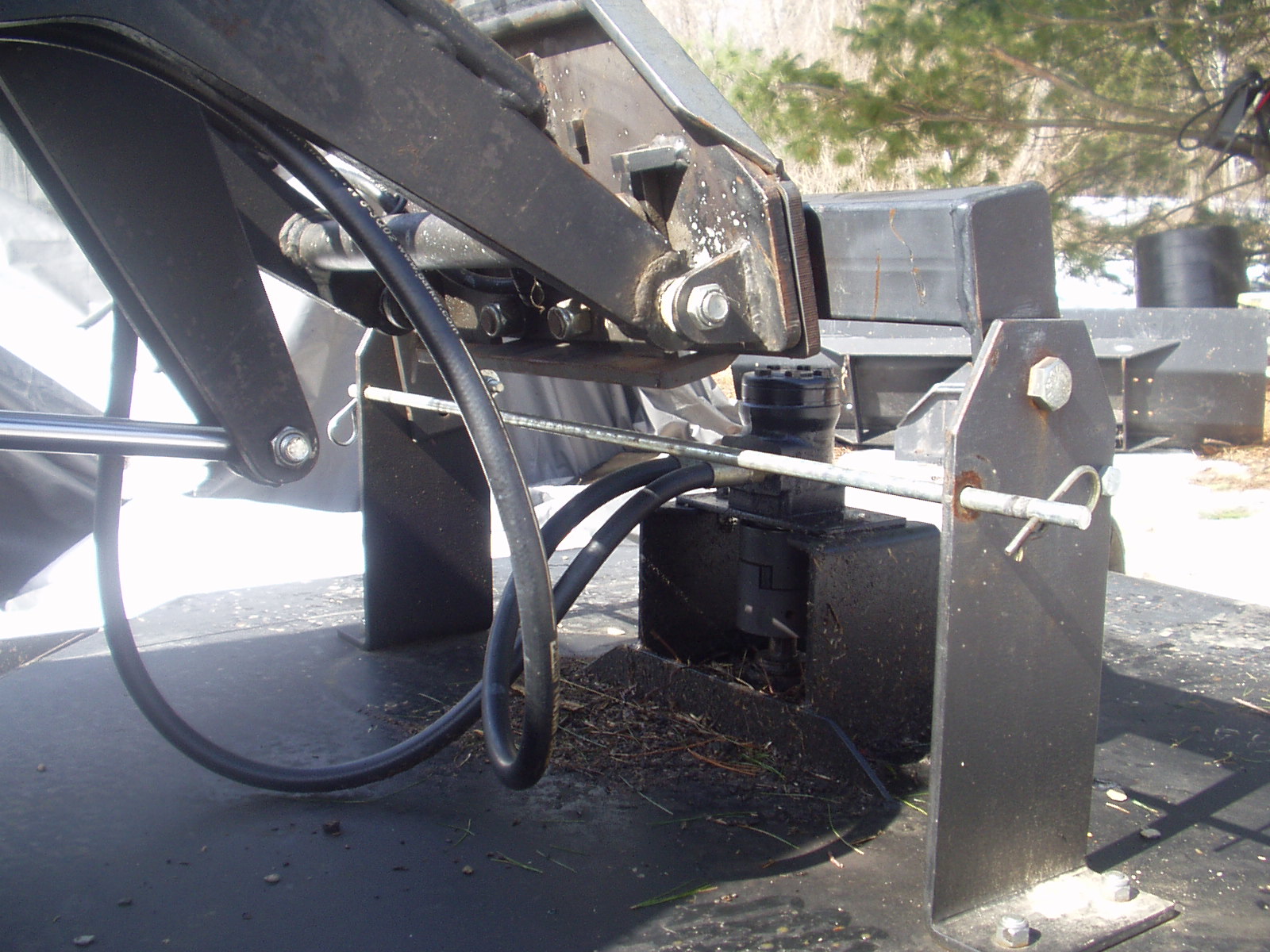

Carl, this is my solution. I replaced the two back stop bolts and nuts with a steel rod, drilled out on the ends for linchpins. If I line up the holes in the pivoting arms with the holes for the stop bolts, I can run the rod all the way through and lock the deck so I can curl the deck to almost vertical. when I want the deck to pivot front to back like normal, I just run the rod through the stop bolt holes as you should be able to see in the pic.
