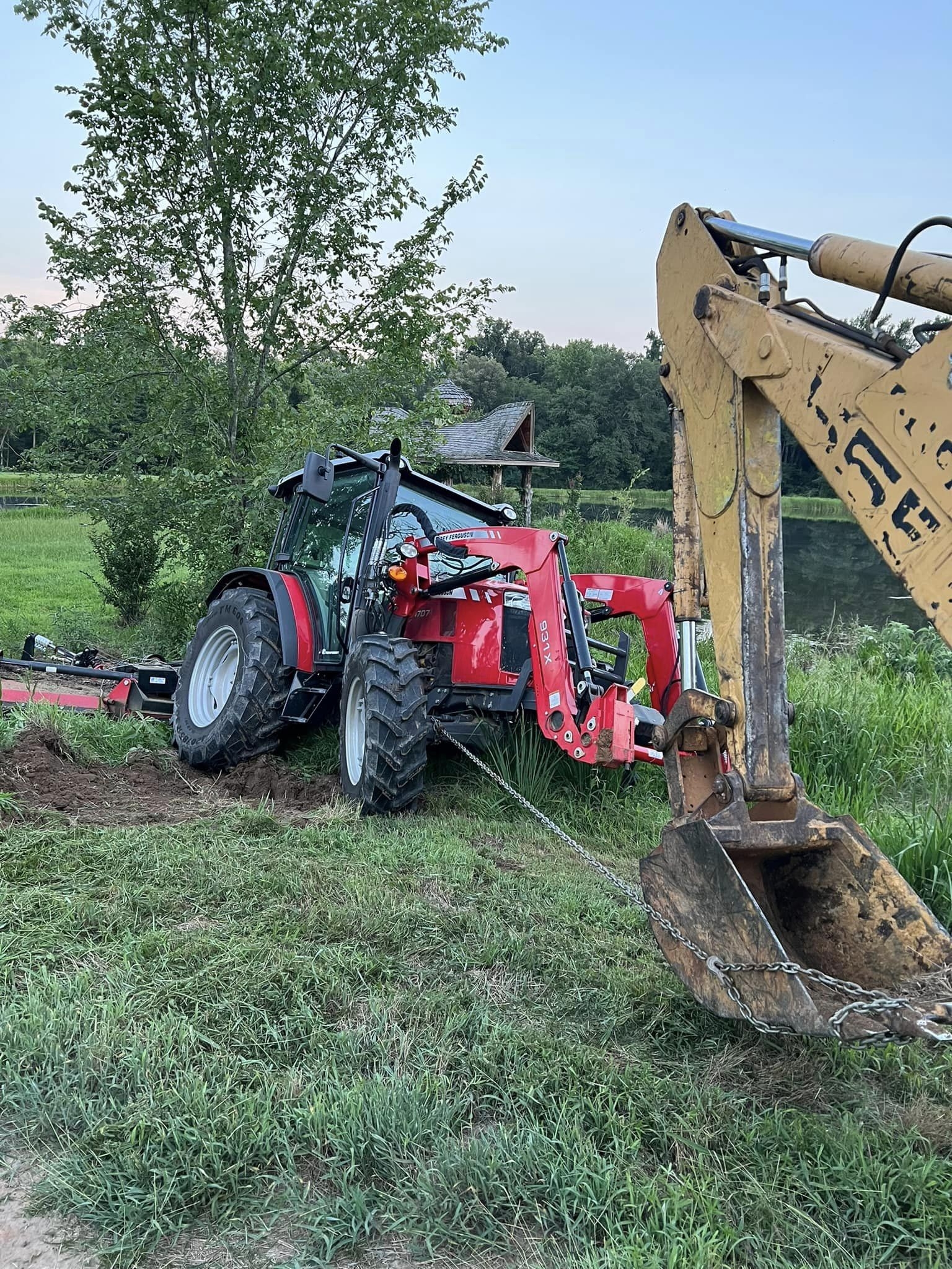

Hello Stephen D, No you are not being paranoid. Once bitten twice shy.
Experience is a blunt teacher, AND you only had a bad fright and NO injury. Fortunatly a relatively low cost learning experience.
You ALWAYS have several things coming togather to cause an accident.
In this case, in a hurry, not looking,ran over a heap of dirt, NARROW track(width).
This combination WILL arise in the future so you need to break the incident chain.
Practically, this means increasing the track(width) of the tractor so an abrupt shift of the centre-of-gravity does not tip the tractor over.To do this with your existing rims you have 2 options
1) get wheel spacers, steel or aluminium. These are low cost and you will be surprised how a small increase in track has a large increase in stable "feel". Other members will tell you what they use and where to find them.
2) Dual wheels, massive difference in stable "feel" a much larger width (can you fit every where you currrently go?) Generally you will slide of the hillside instead of roll off the hillside. In your case backing over a heap of dirt,you better have your seat belt on as you are likely to be tossed into the door instead off rolling the tractor.
NOTE :
1)Your stability comes from the back axle. Making it wider gains stability. The front axle is on a pivot and by the time it hits the travel stop you are past the point of no return.
2) In your photo you have the loader down low. EXCELLENT, that is where it should be(curl bucket right back so if you hit the ground it slides instead of digging in). And when you are loading a trailer etc, keep the loader low UNTIL you are approaching the trailer to tip into it. A common mistake is to lift up high WHILE MANUVERING. This is a classic roll over senario.
3) Ballast: Are your rear tyre filled (partly) with liquid?
You will find a 3ph couterweight to be a good safty invest ment. Ask other members how they made/setup theirs to see what would work best for you.
4)Is there a company that does tractor saftey near you? Possibly state Ag saftey? Some formal trainig may be the best way for you to grow your confidence back.
Some food for thought.
Good Luck.

If it does not feel right then pause. You mentioned you were not looking for strategies, probably because you have read and studied and know what you need. It was not likely the 15° that got you, but 15° or more, plus bucket load high, plus one wheel high or low, plus motion/turning. Reducing any one of these may have made the difference .
I watched a bunch of safety videos when I first purchased and scared myself. Here is what has helped me.
My 1300 lb counter weight is always on except when using another 3pt attachment. It sure does make a big difference for stability. My tractor literally squats when I raise it! Size it to 60 or 75% of your loader capacity.
My wheels have adjustable centres and so my wheels are set wide and the tires are loaded.
I have a cheap liquid inclinometer with a ball inside. When I get nervous and look it is typically above 10°. I put my hand on the loader control (if it is not already there) and inch along or back out to safety.
I have specific turn around spots on my slopes that keep me at 10° or less.
Continue to use your tractor and get comfortable again with front and rear slopes before trying side slopes.

Your problem was the pile of dirt you backed over . Sudden shift of balance . Kevin .
I agree. I don't believe an inclinometer or alarm would have helped in this case as it was too sudden.
Tractors give a totally different and foreign feeling while driving due to the lack of suspension and the operator's elevated seating in respect to what you're used to.
Your attachments also change your center of gravity. I often use my Lane Shark raised high on my FEL while trimming the paths, a sudden dip on the side could potentially cause me to fall over so I use my ROBB as low as possible as a counterweight and I try to run the paths first to see if the rain has cut any groves or channels.

I have two Deere 5 series. Essentially the same except new one has loaded tires. Tire size was the same between tractors. New tractor was very tippy compared to old machine.
Stability was massively increased by increasing the rear tire width to match the old tractor. A difference of 7 inches total.
Point of this post is how much difference in stability, rear tire spacing makes. Much more than Loaded tires.

honestly.... it comes down to this.... speed, reverse, cab, height of fel and rear weight.
if you didn't have a backhoe, block, wheel weights or balist in the tires these rear tires are basically lightly loaded with a loaded FEL.
cab moves weight up than no cab tractor and the rear tire lightly loaded hit a bump and pushed you over and the cab helped push you in the wrong direction. think of the tire hitting that
I was working on a small tight yard with large piles of dirt from digging trenches and moving slowly. I was able to maneuver at severe angles slowly, at angles that would freak most out but I had no cab, backhoe on
moving slowly around as any place not a ditch was covered in big piles of dirt and I couldn't back fill yet sewer and water line install. no way I could do it at any speed over those piles.
so speed and cog is epic.. yours looks high in both regards.
