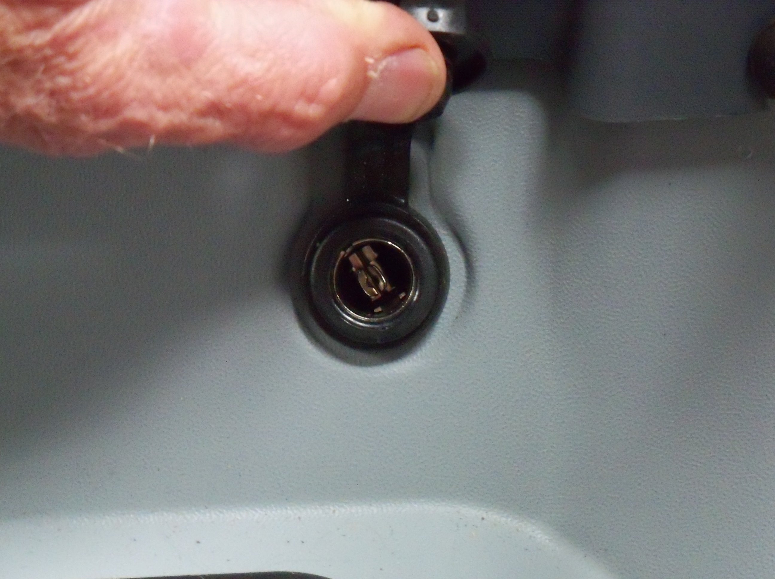

Hello, Can someone tell me the correct name for the male plug I need to fit the socket pictured below? The socket is in my NH T4.75 within 2 feet of where I want to mount my backup camera in the rear window. The tractor manual just calls it a "single-pole electrical connector 8A". It is smaller than a cigarette lighter socket and measures 1/2" diameter. When I place my electrical meter positive lead to the center bottom and negative lead to ground I get 12V with the ignition key off. I have typed "single-pole electrical connector 8A" into Google and get nothing that looks similar and I need to find a male part that fits this socket. Thanks....
Why don't you simply cut it away and install something that you can get as a pair.
Since it as always hot a fuse or breaker should be included.
Whatever connector it is it will be pricier than the replacement pair.
On the other hand from the pic It almost looks like the type used to push onto the stud of a cigar lighter.

Could always contact your dealer and see if they have a pig tail. If they do and it's reasonable ok, but the idea of removing it and installing a standard 12 volt outlet.

I will install something else if necessary. I am just wondering what I am missing here as to the name. I find it hard to believe NH is installing these plugs on some of their cabbed tractors if they are not common parts. If I don't get any replies by tomorrow I'll phone the dealership. Near the seat I have a cigarette lighter, the receptacle mentioned above, a 4 prong receptacle, a six prong receptacle and on the back a 7 pin receptacle for trailer brakes and lights. There are plenty of electrical receptacles near the rear window and the one I am trying to find a name for would be the most convenient for me to use.

What is the inner diameter of the metal sleeve? If its 5.5mm, a standard 12v power plug (like for a router or a security camera) probably fits into it.

Inner diameter appears to be 1/2" as far as I can tell....
Ah, now that you mention that, someone ran into one of those on here a while back. It appears to be a ISO 4165 socket. Also known as a DIN Hella, Powerlet or a BMW/Euro-Style plug. Common on European motorcycles where there isnt space for a full on cigarette lighter socket.

Thanks for the information!

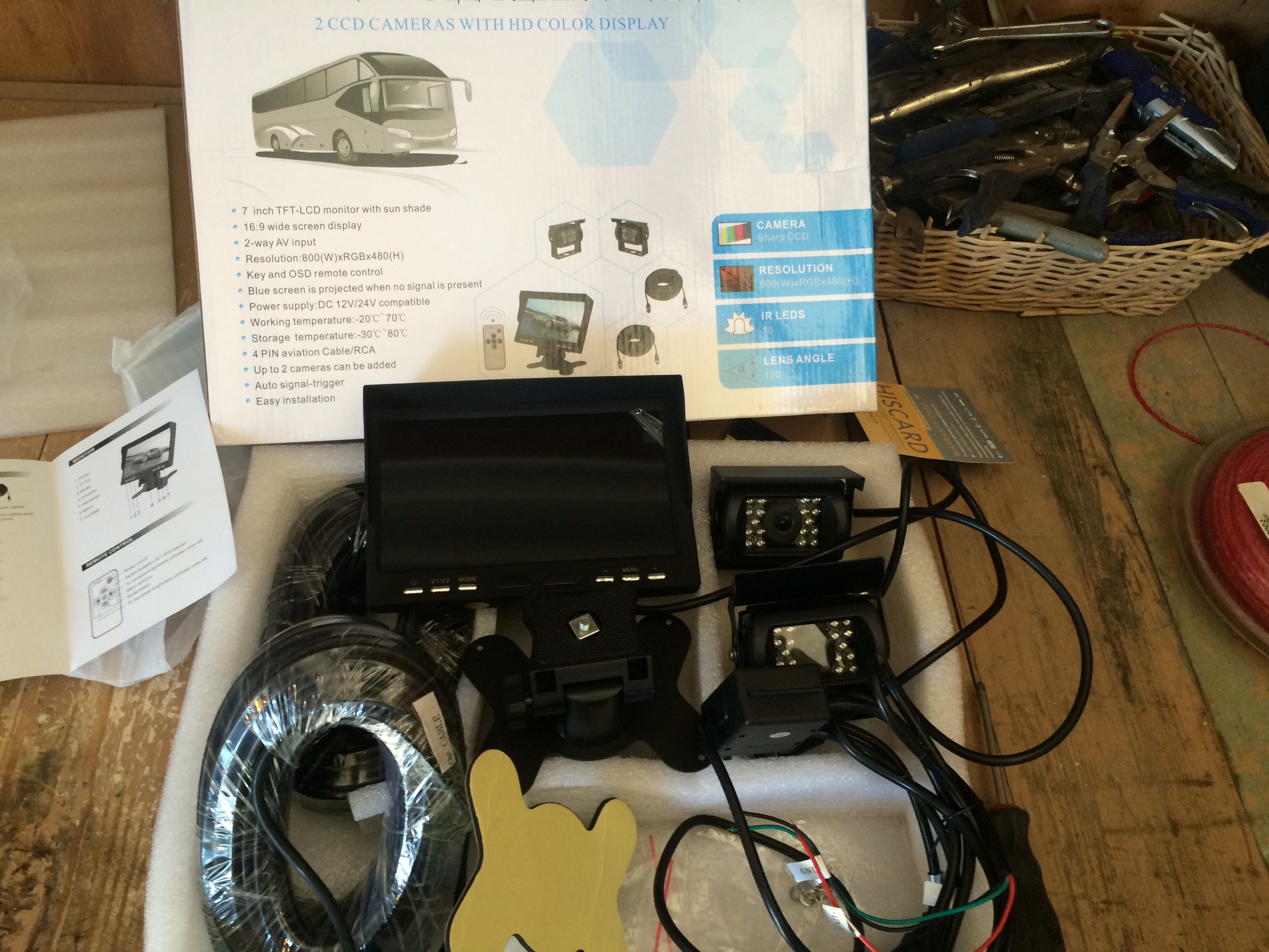

The kit came in today. This is what was in the box. The installation instructions consisted of a list of what is in the box.

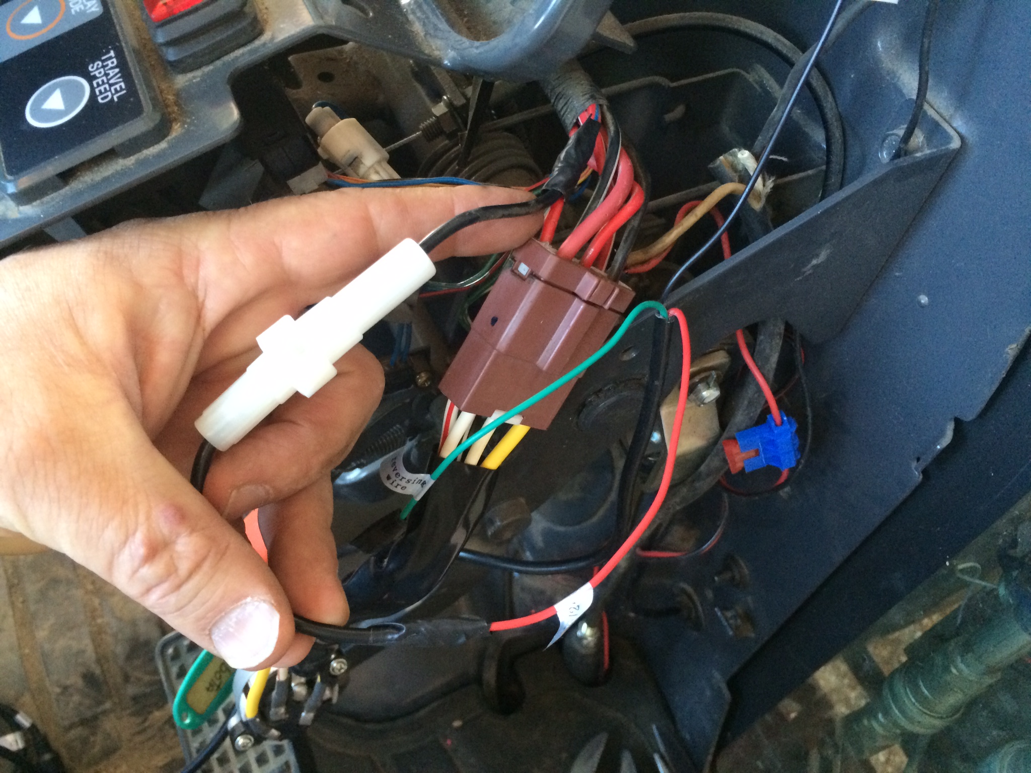

My most difficult task was finding a place to get power. There is a plug available under the dash, but I already have 2 other items running off that plug. I ended up skinning a wire and putting a 1 amp fuse to get power.

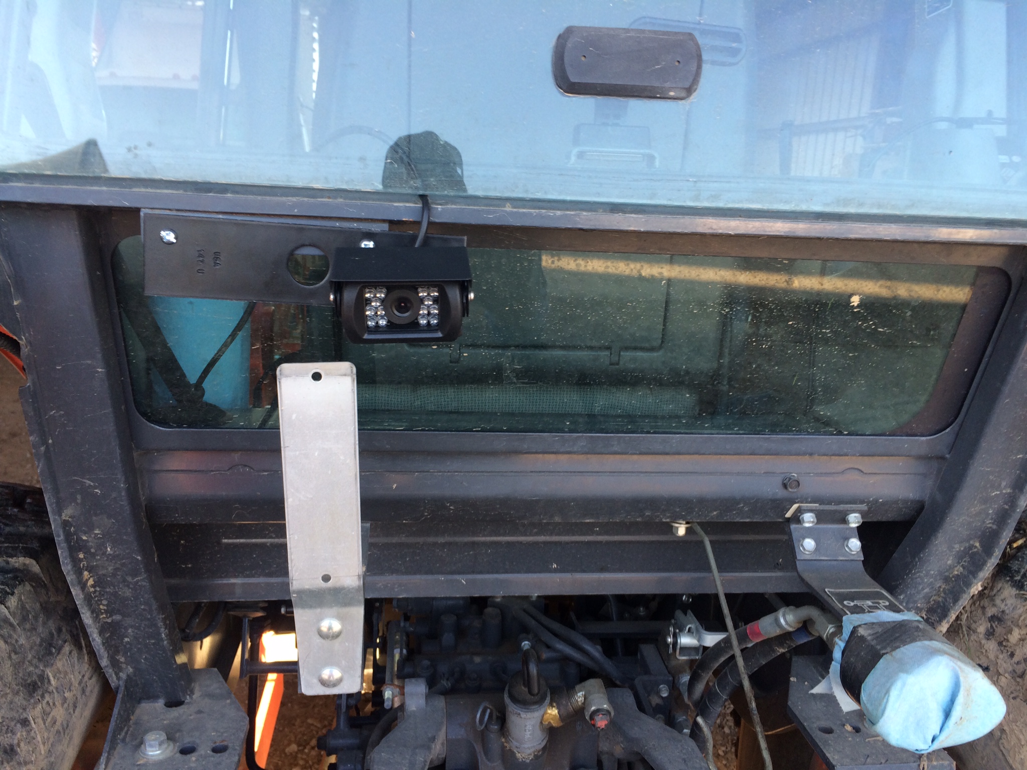

I drilled a few holes in an edger blade to mount the rear camera. It seems to have worked out well.

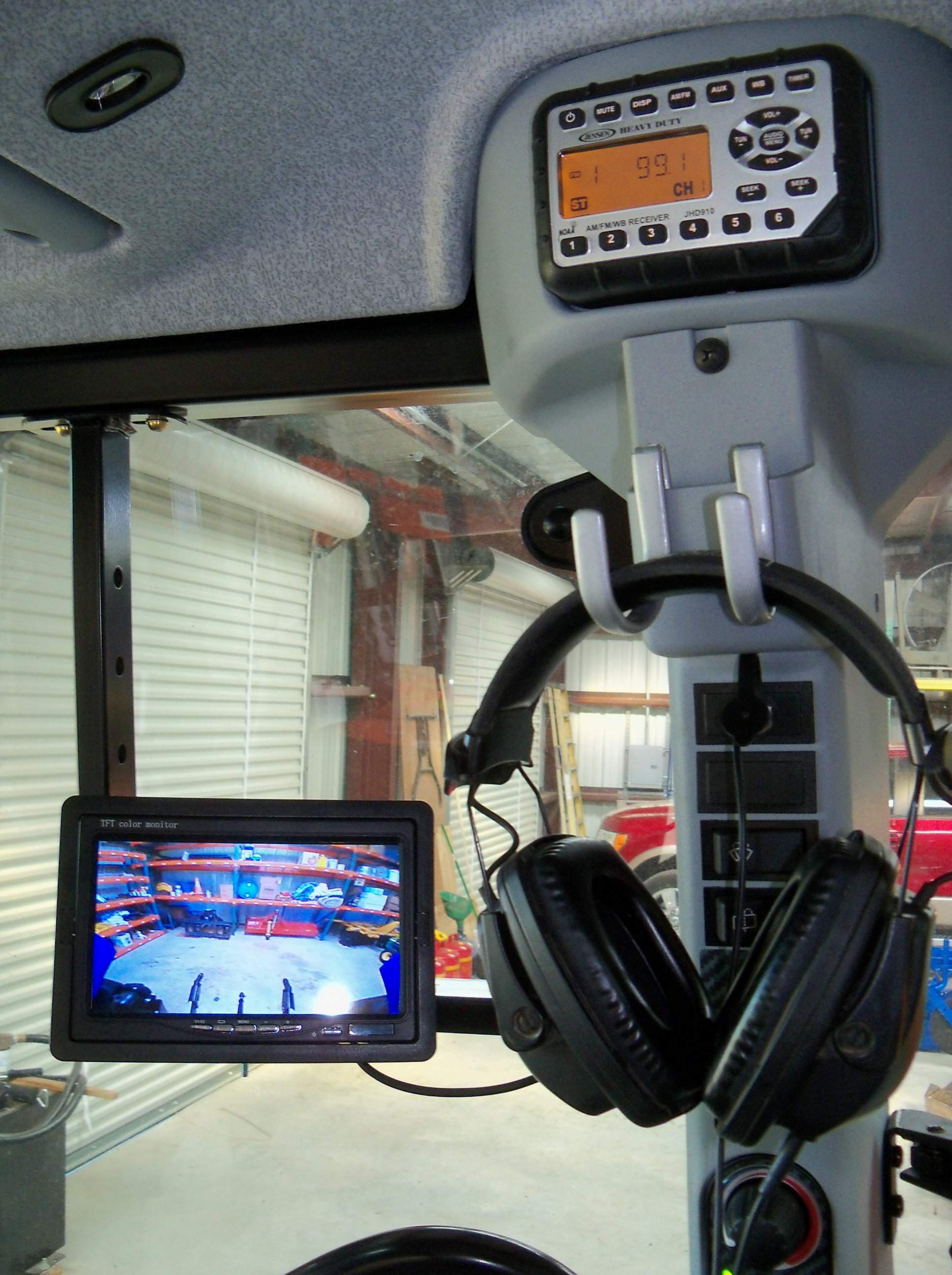

Here is a short video of some of the options on the monitor. This is with only the rear camera hooked up.

I thought I would update that my camera and monitor are still going strong. They are on anytime the key is on. The camera comes in handy when I am on the road. I can look down and see if there is traffic behind me. One day this week I was in tight area in the woods between a bunch of trees. The camera made it easier to navigate through them. It has been very handy when I am loading the truck, I can just look down and back up. In some cases I can see my implements good enough while I am working them that I don't have to turn around to watch them.
