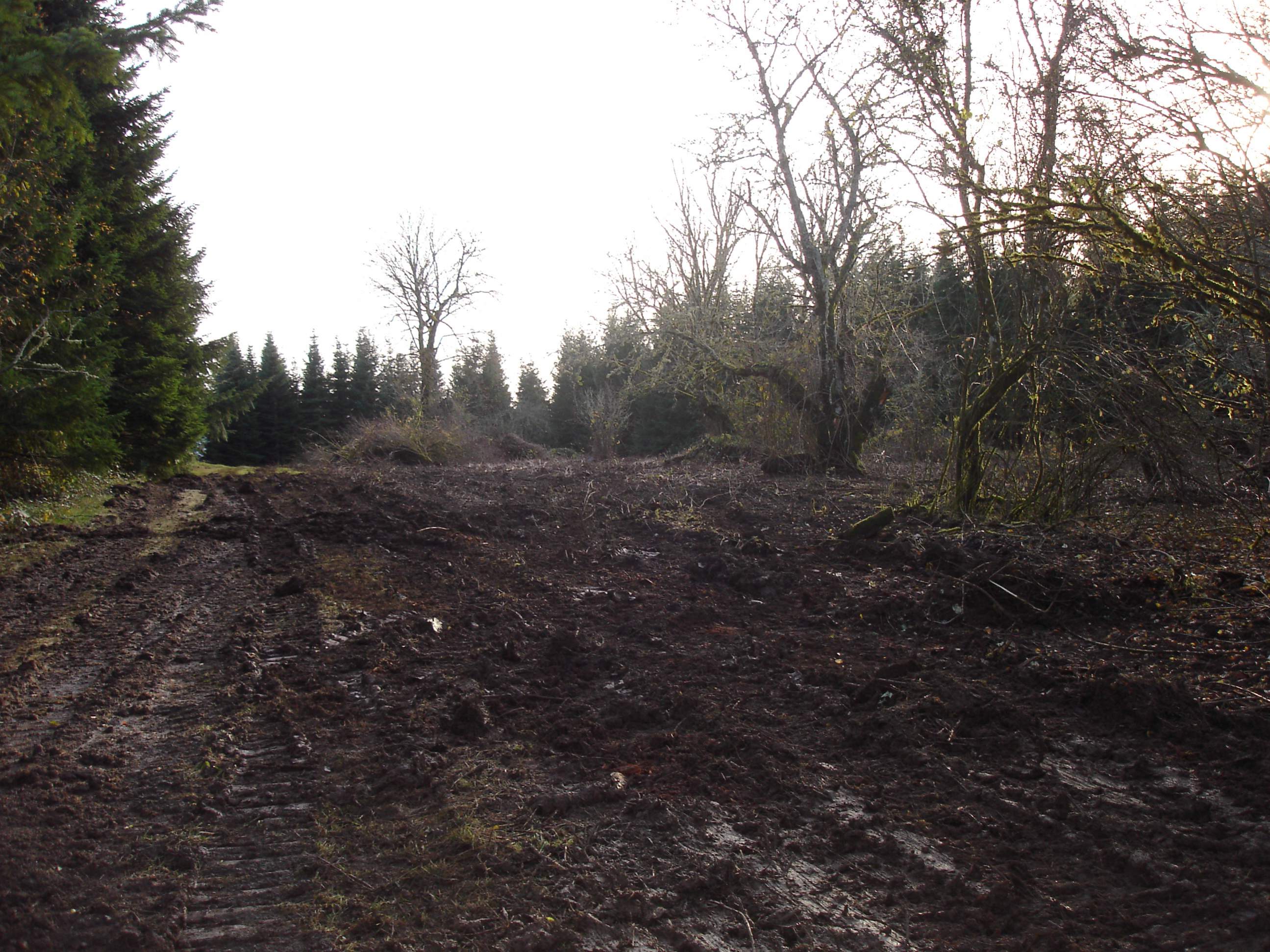

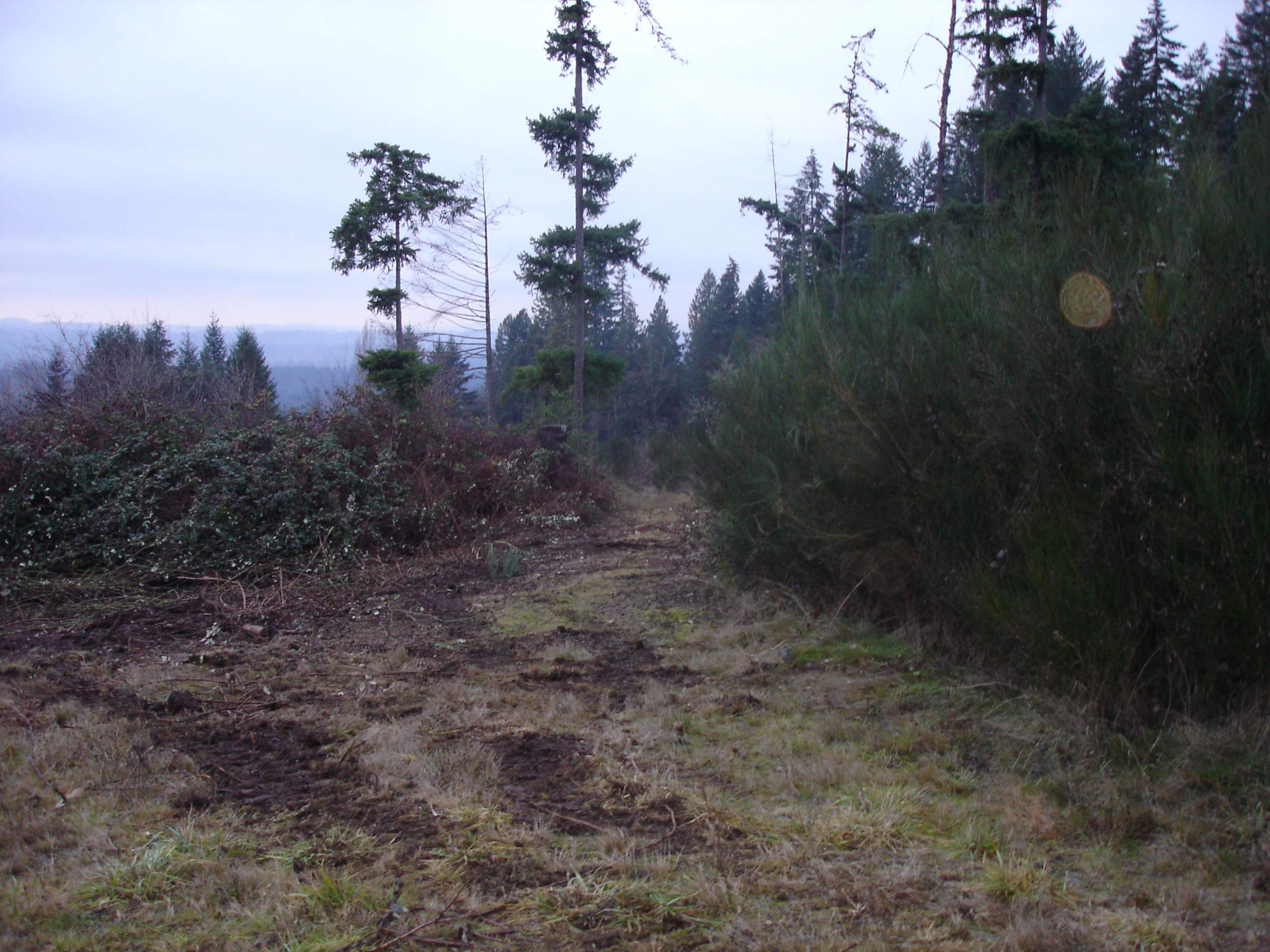

So while we've been waiting for the houseplans I finished cleaning up a section of field cut out in the trees. It will be where the future food plot will be. This is the area where I have seen the most consistent wildlife activity on the camera, Elk, Deer, and Bear. There are 5 mature apple trees, I thought there was 8 but looking closer at three of them they are actually Walnut trees. Just kept thinking they were weird looking apples cause they are green.
Then to my surprise underneath blackberries there is an old foundation, looks to me like it burned down. Weird part is the county has no record of a residence there.

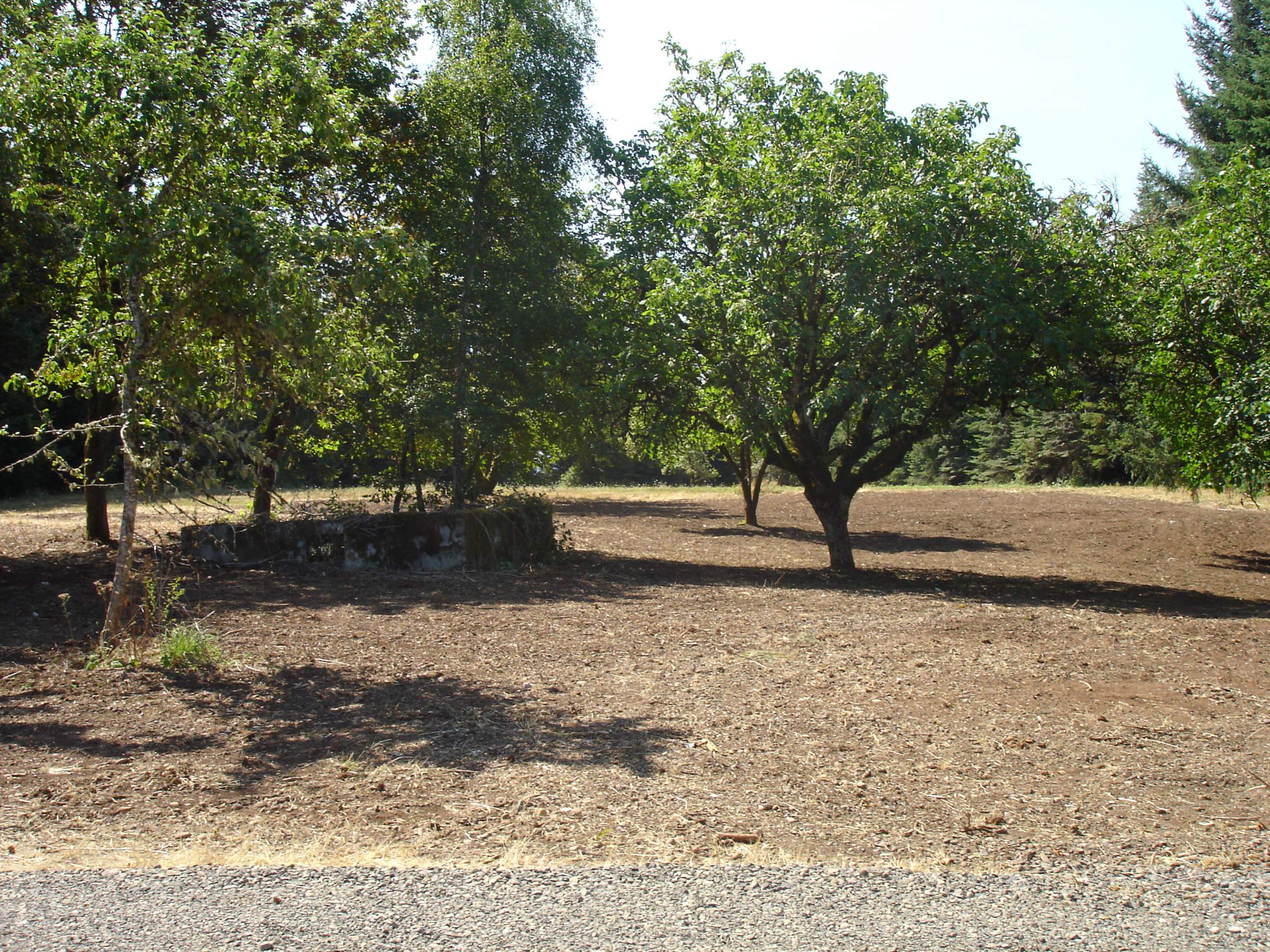

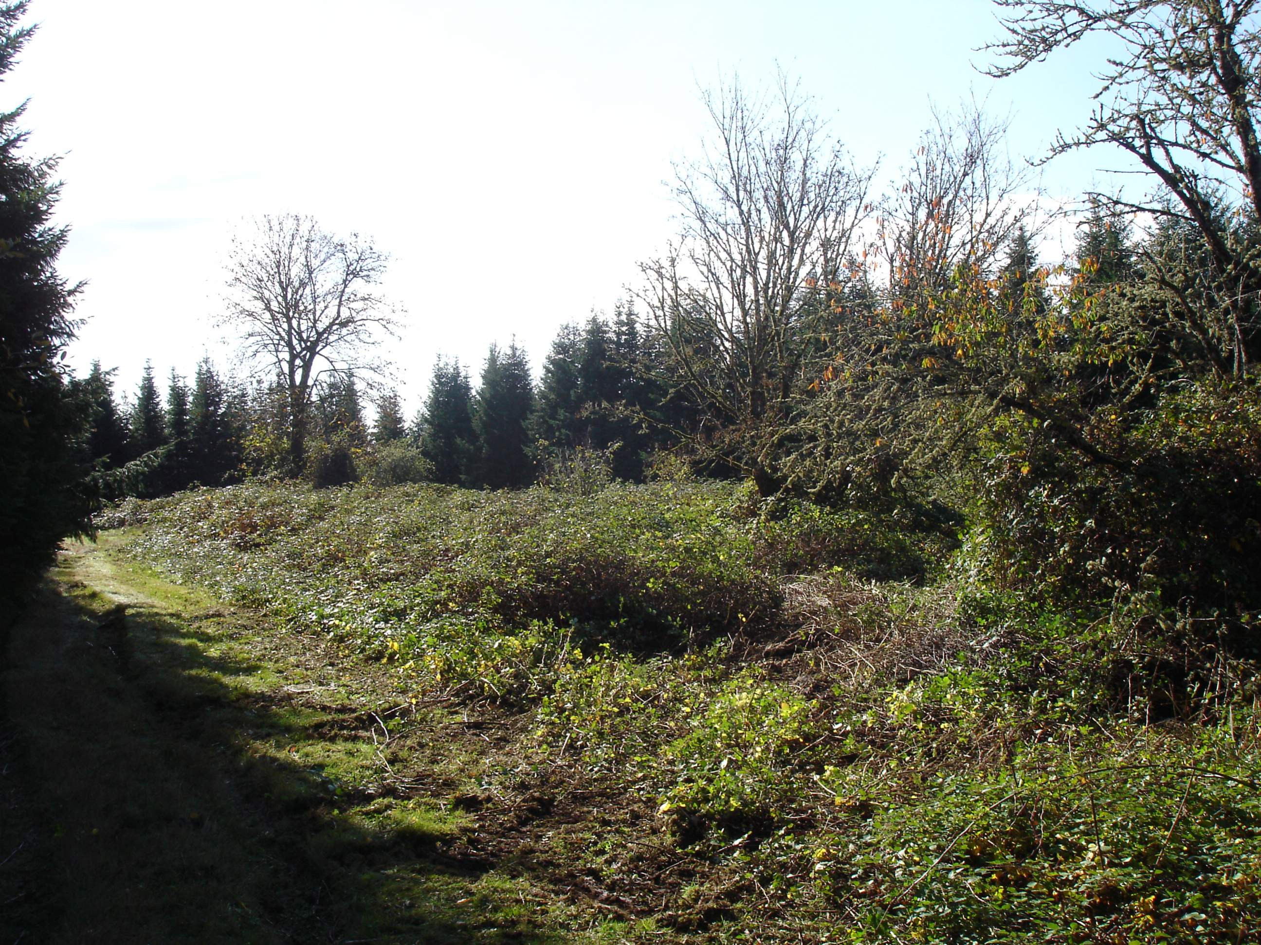

For some reason I can't upload new photos, tried for an hour last night and half hour just now... I'll get them up ASAP.

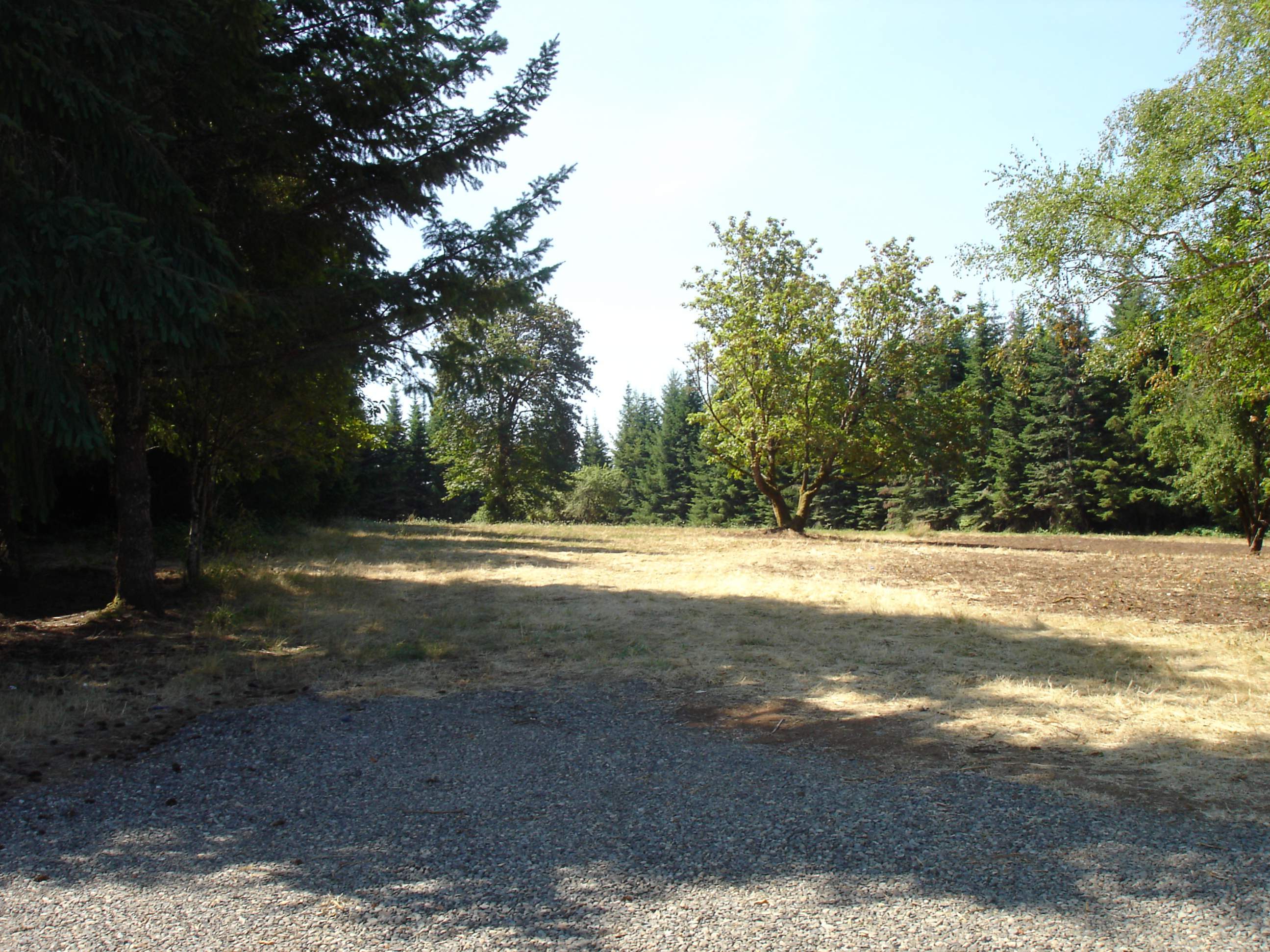

Back in action - First two are before's and second two are after's not quite from the same angle but hopefully close enough.

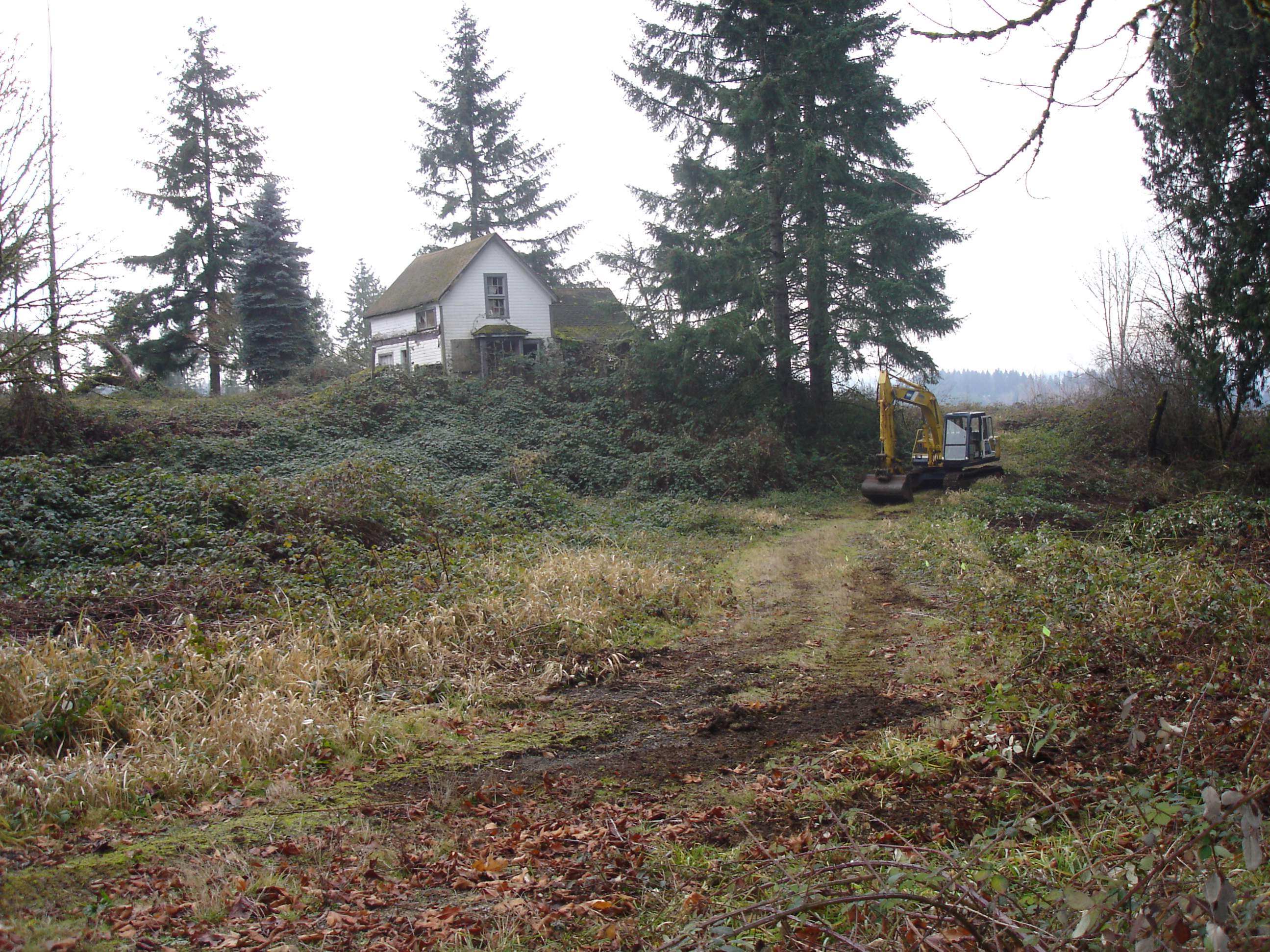

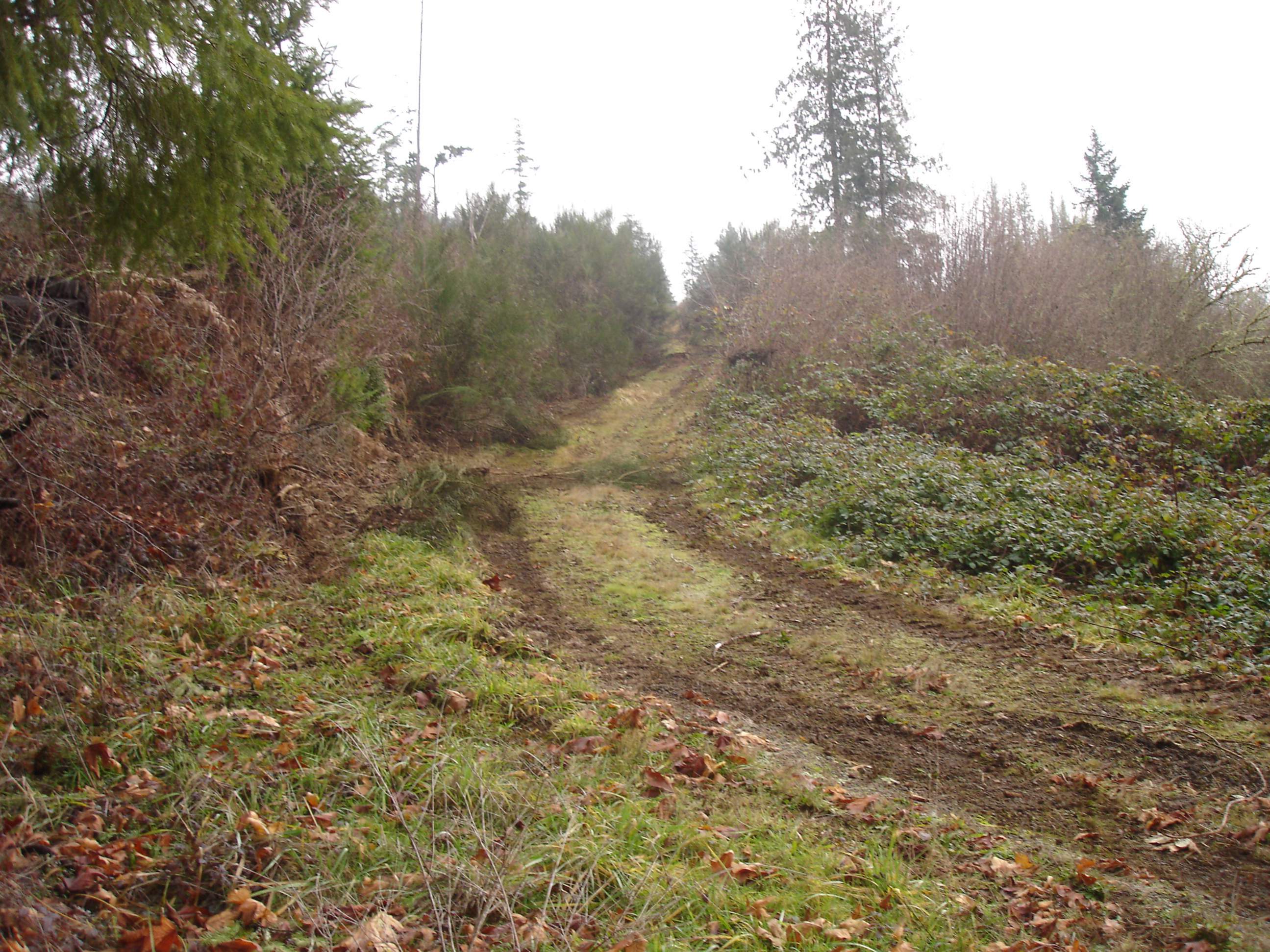

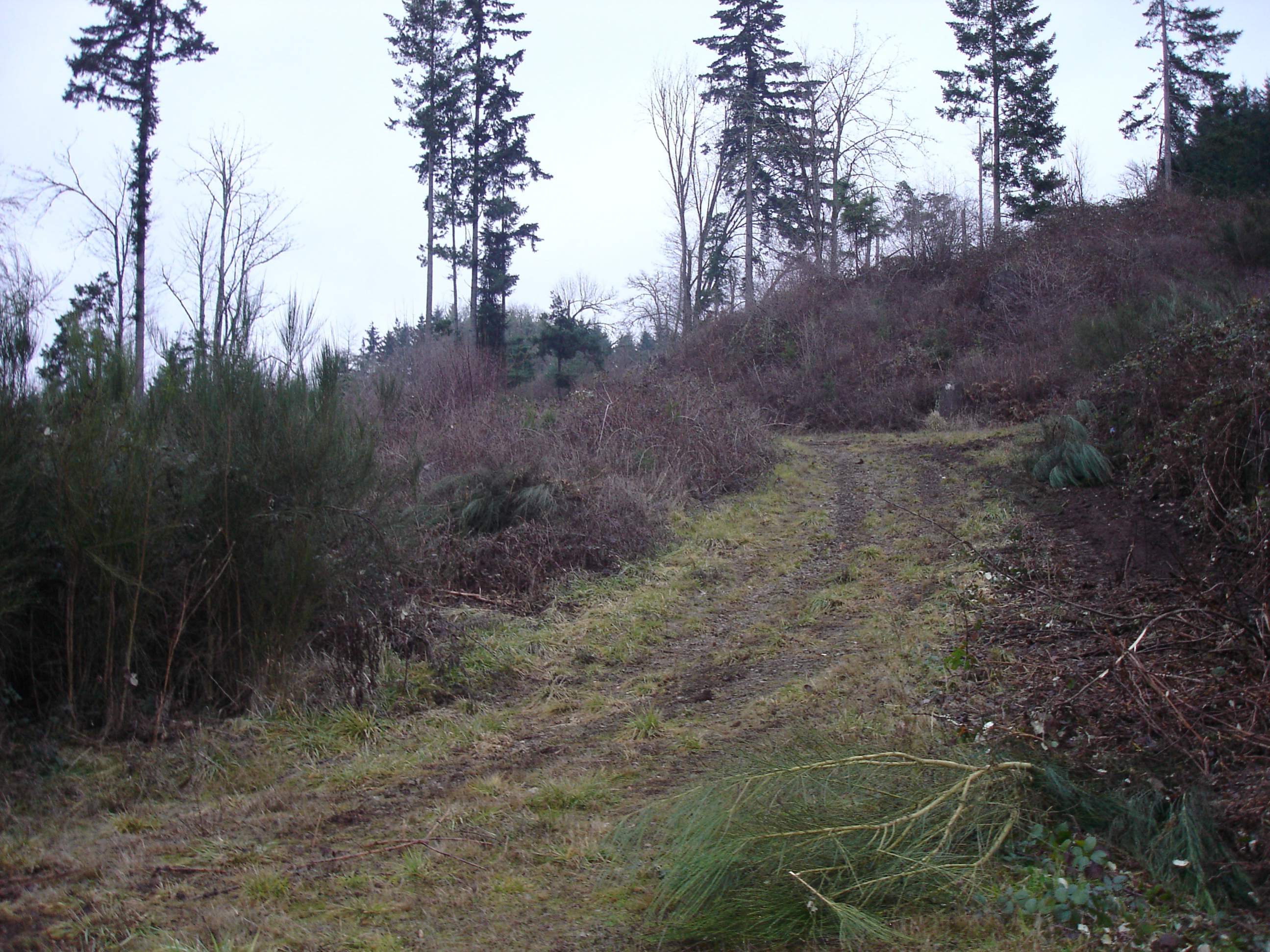

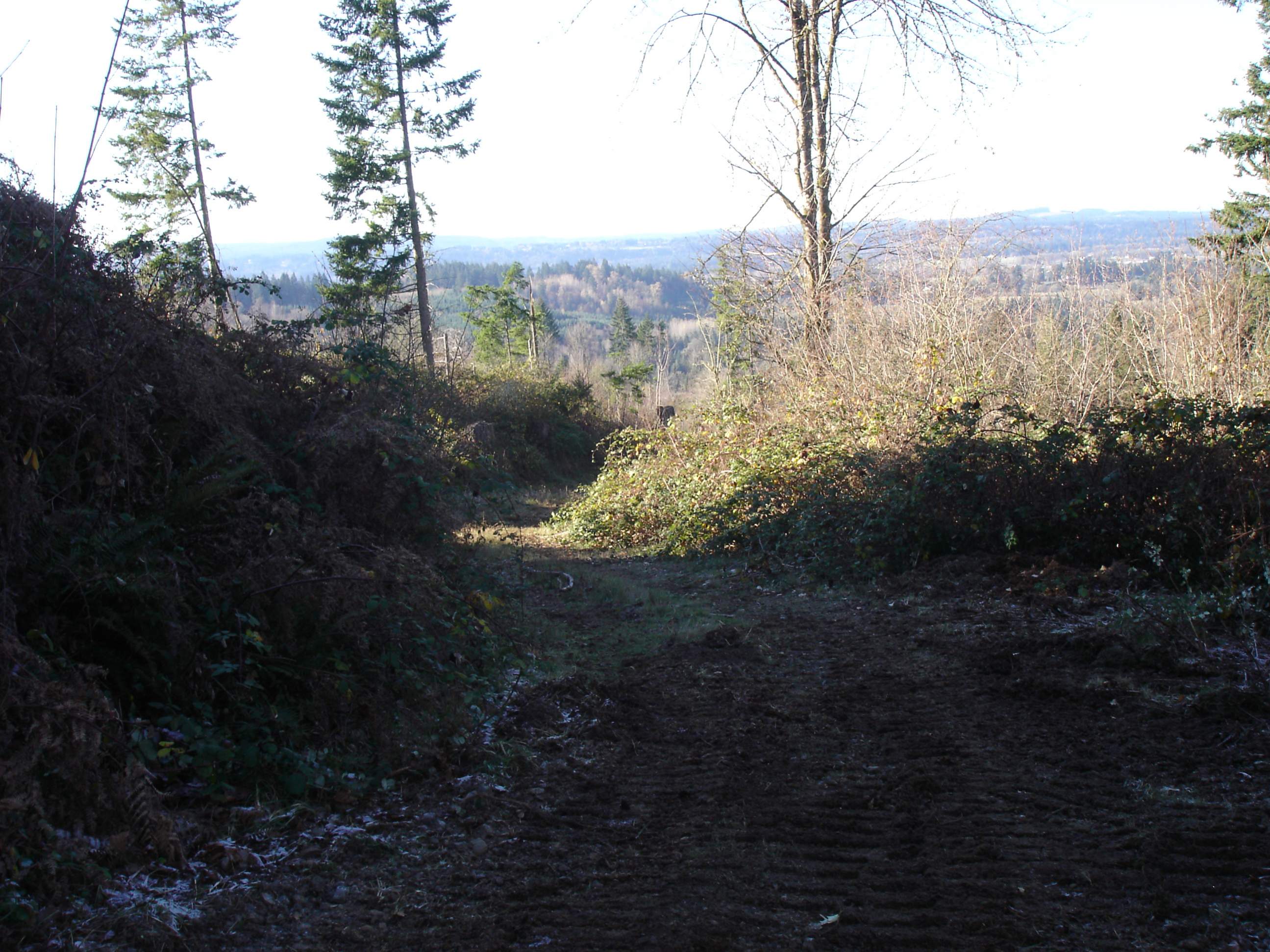

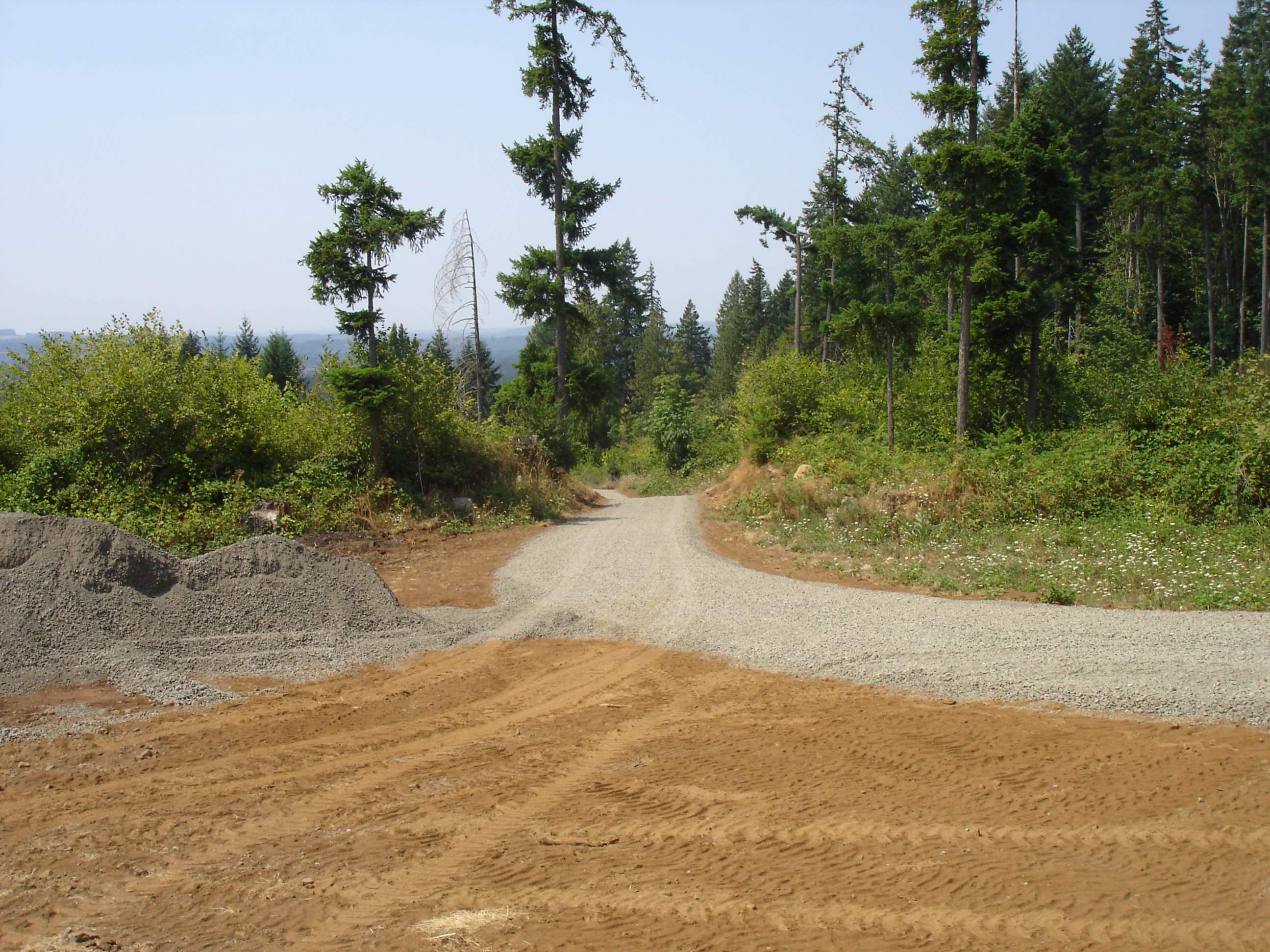

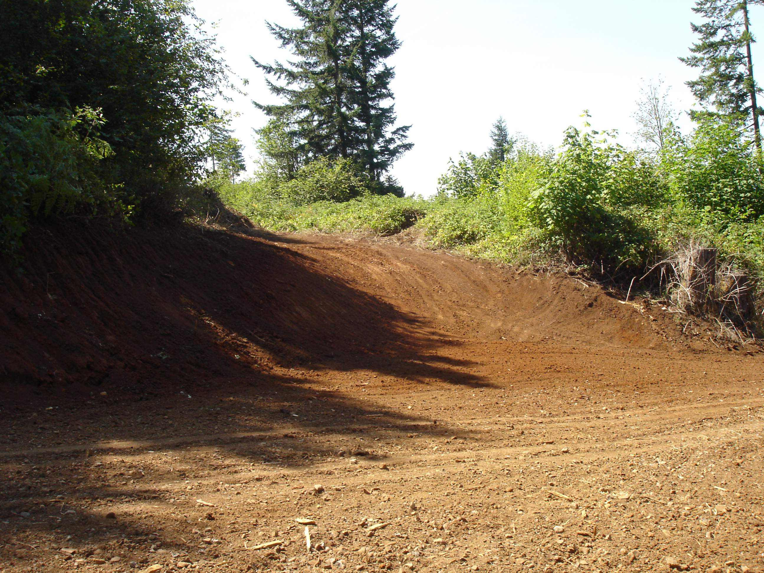

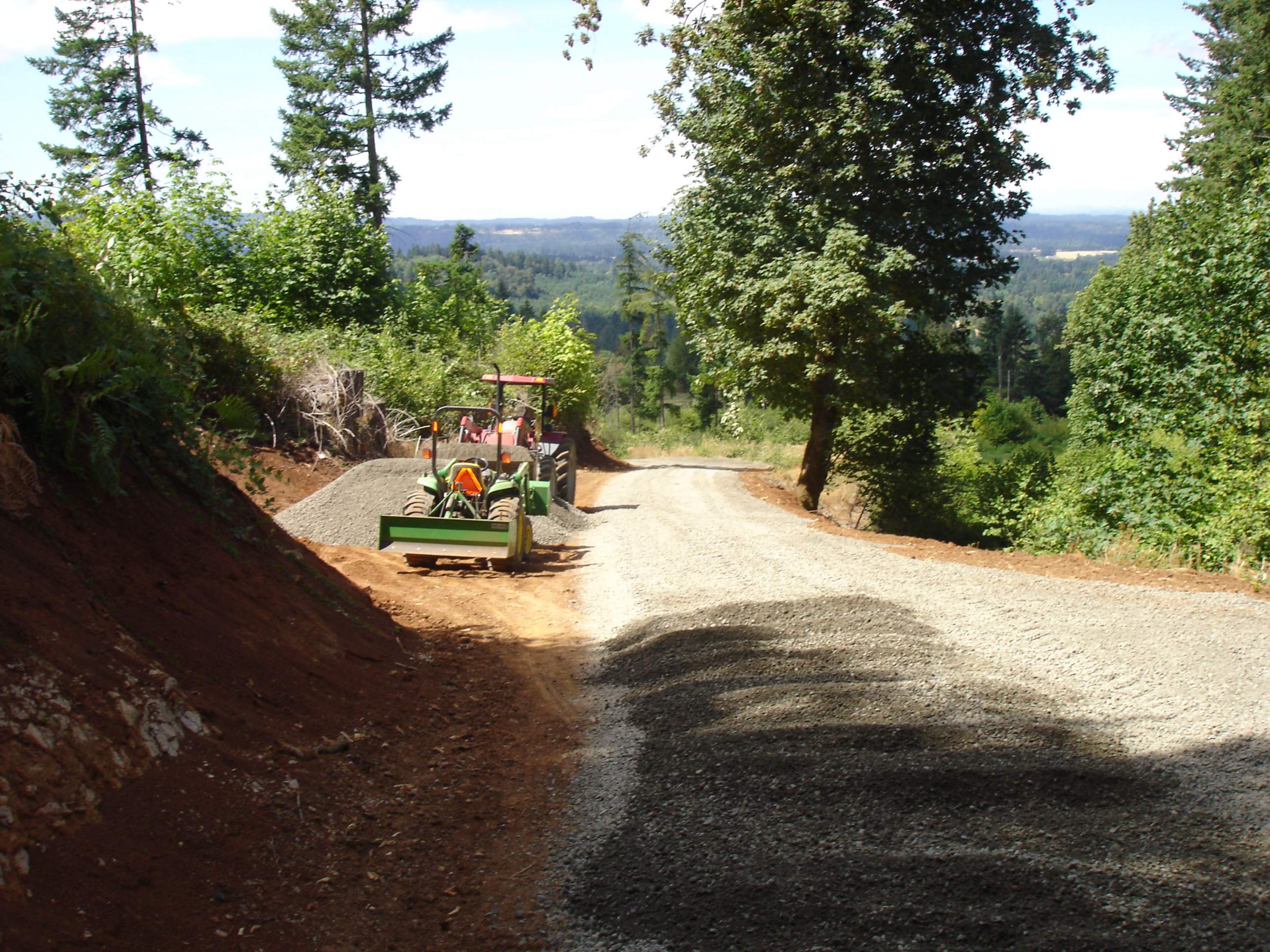

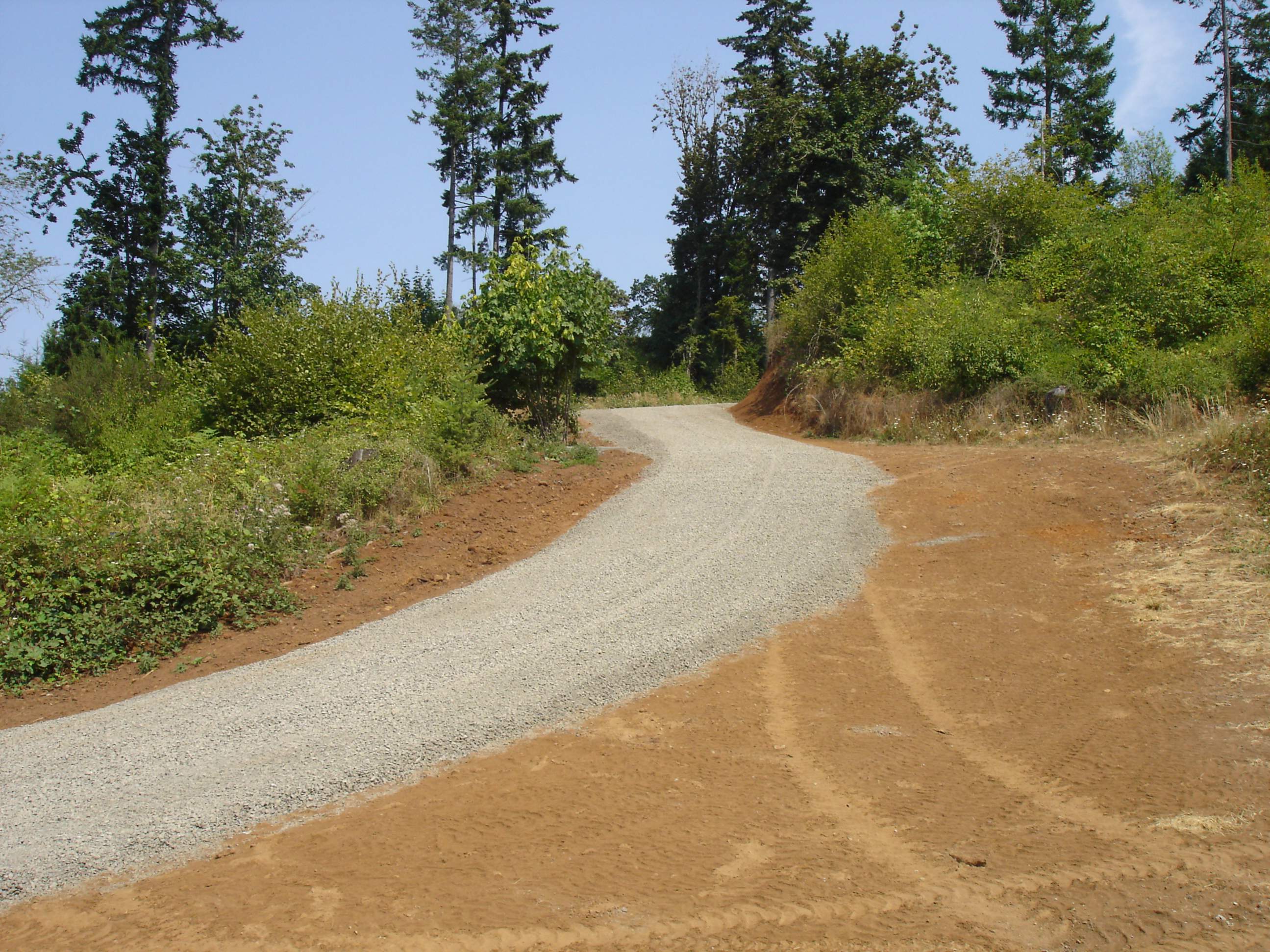

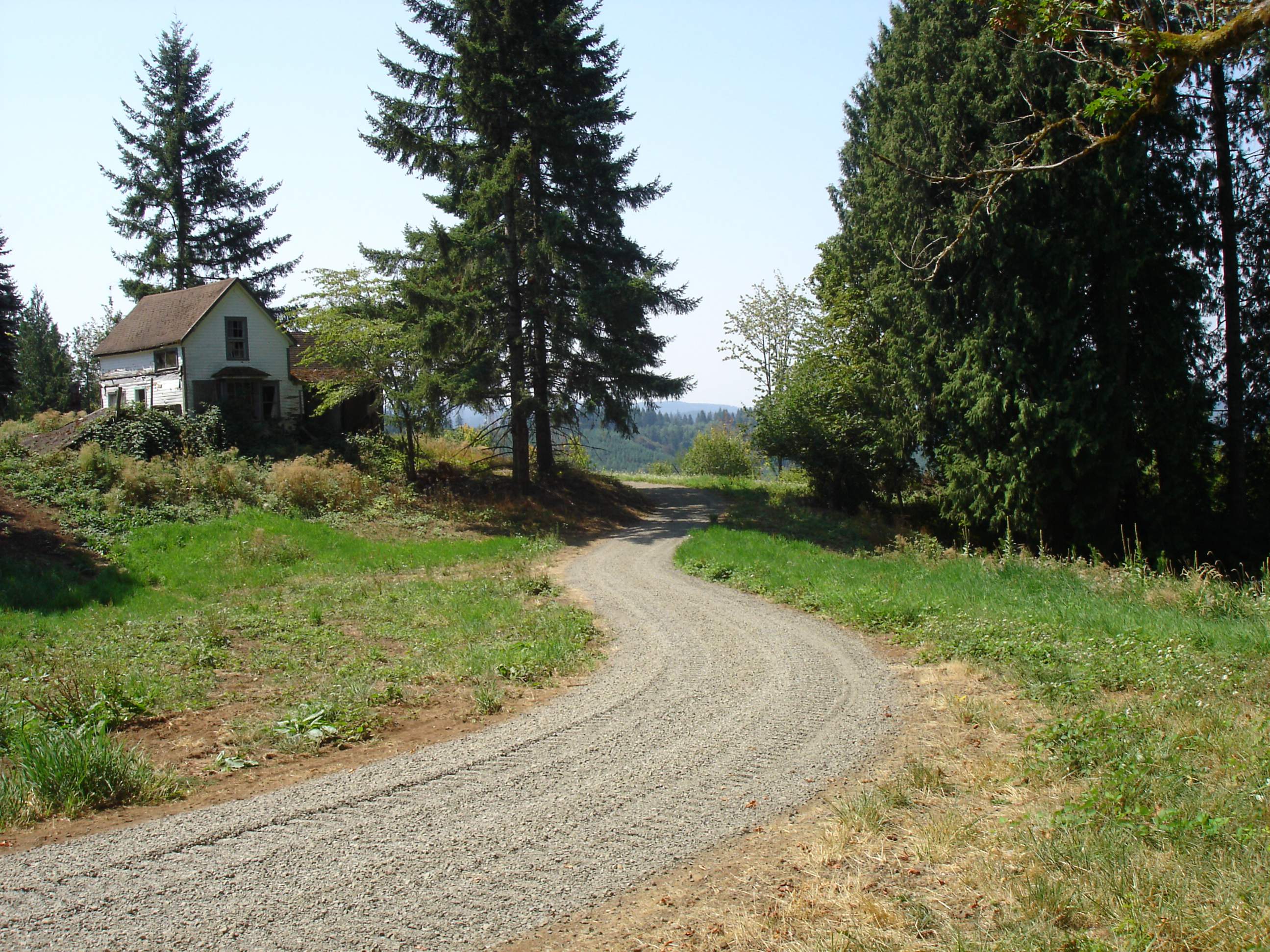

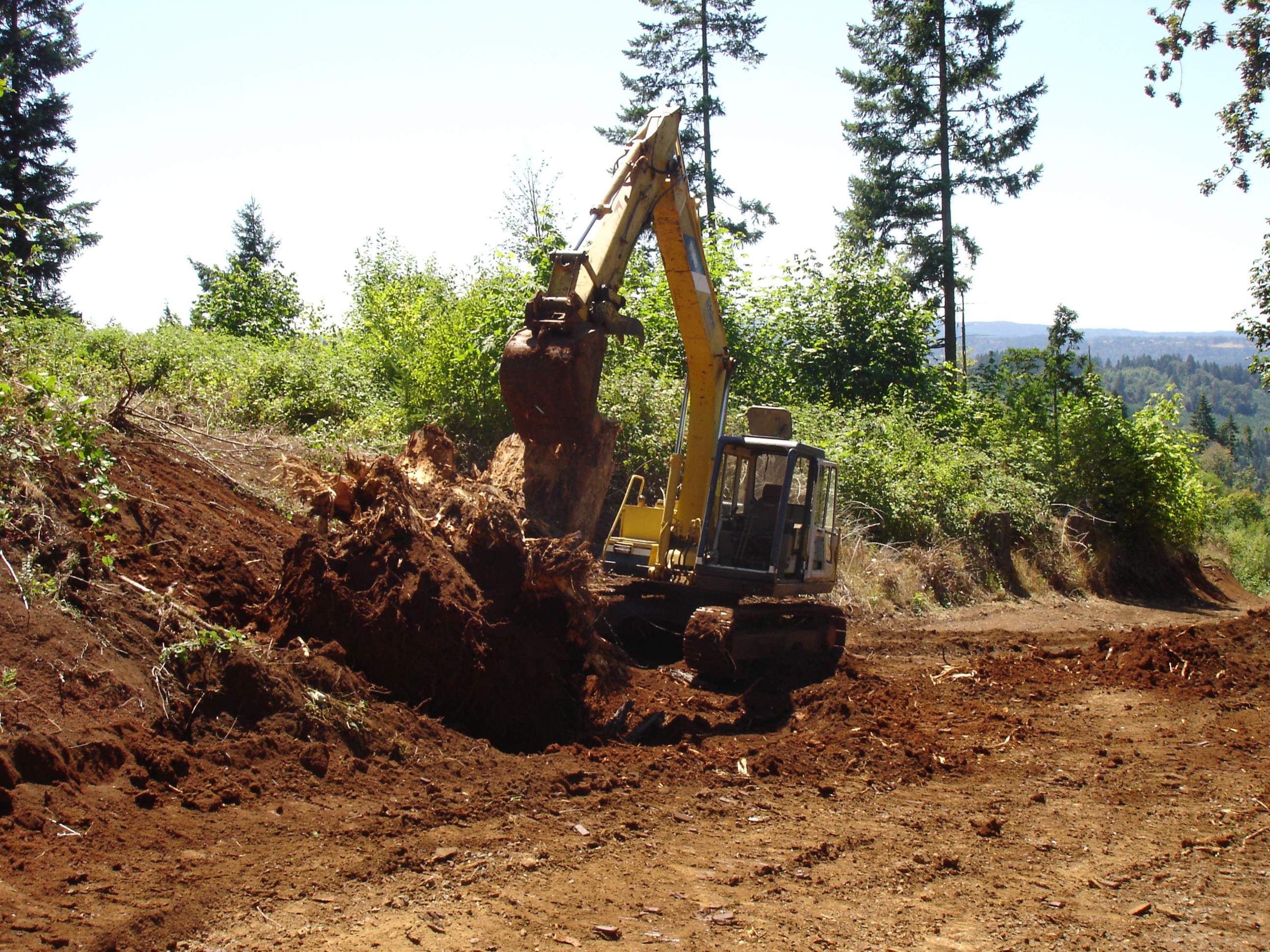

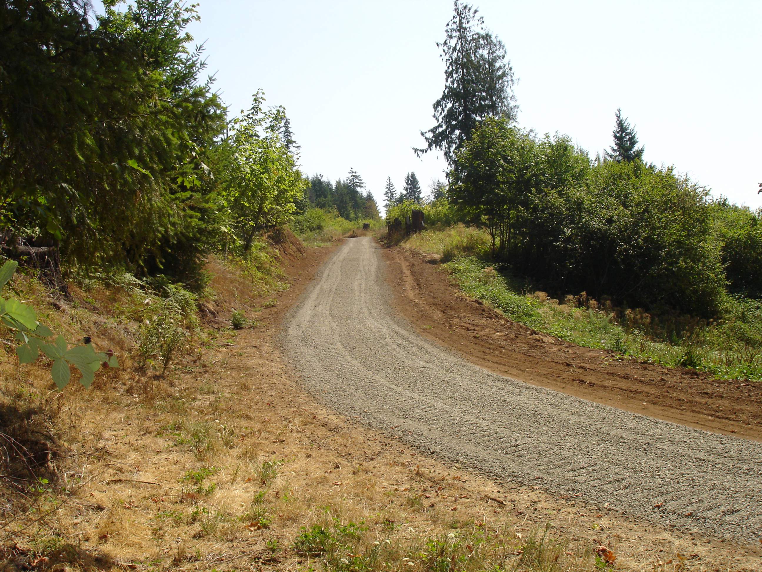

I have pretty much finished the driveway finally. There will be some touch-ups and some minor grading but at least I can get to the building site year round. I'm just going to post up the second half of the driveway as I didn't do anything else to the first half. I ended up taking out a couple more stumps from the uphill side and took some dirt out to fill the downhill side, wasn't real happy with the little turns in it so now it's a little straighter.

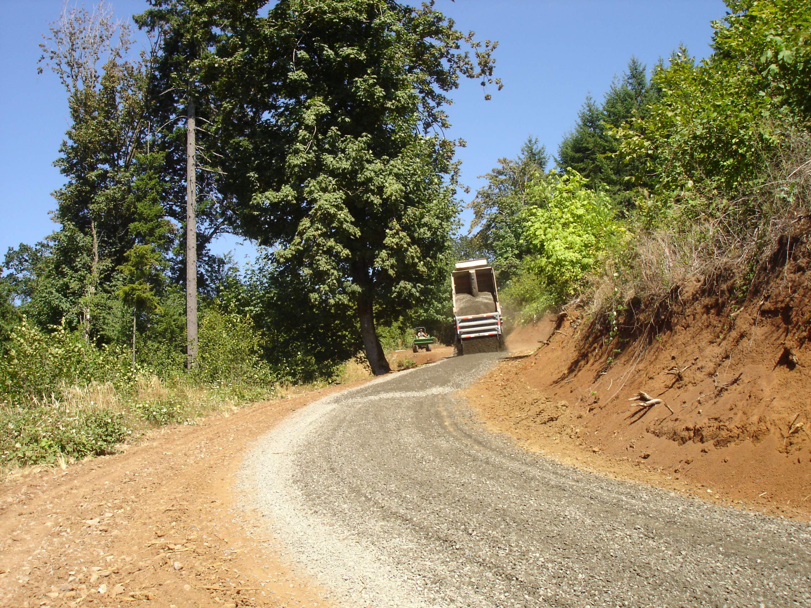

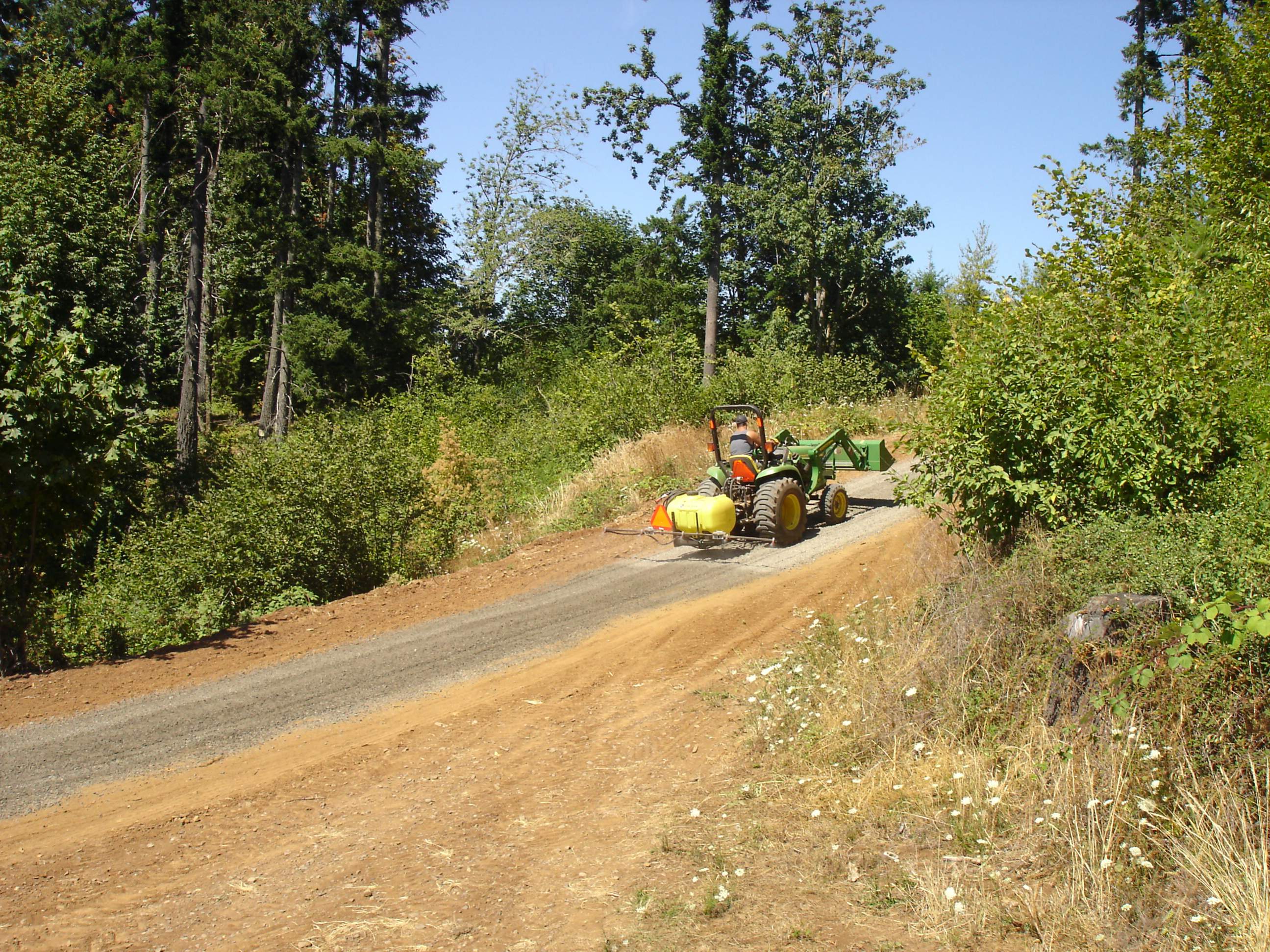

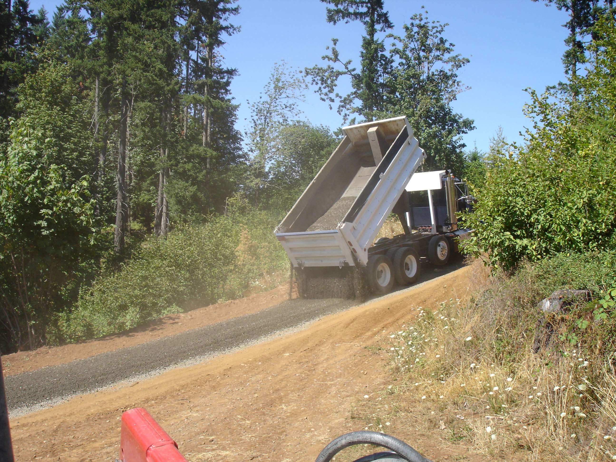

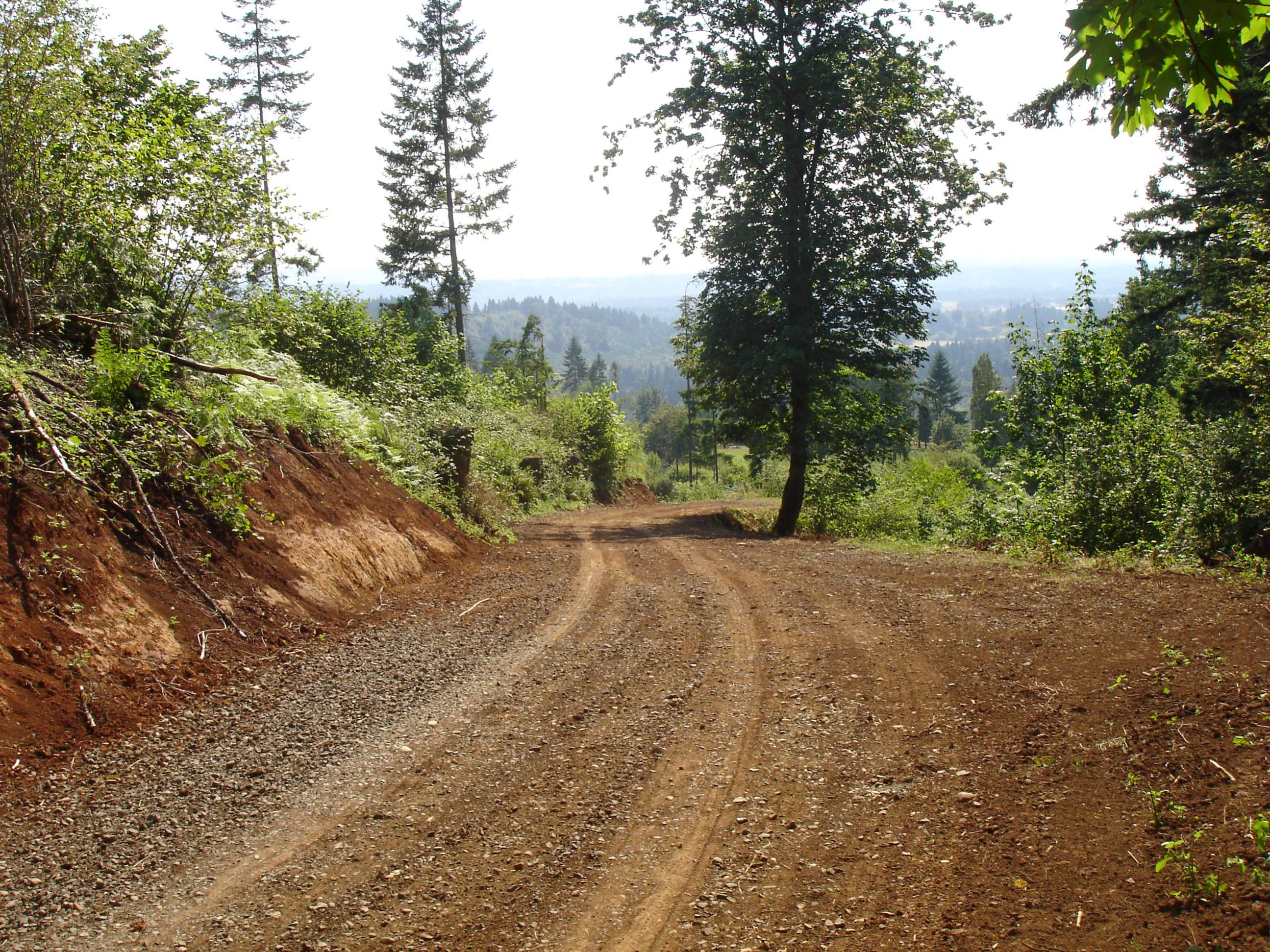

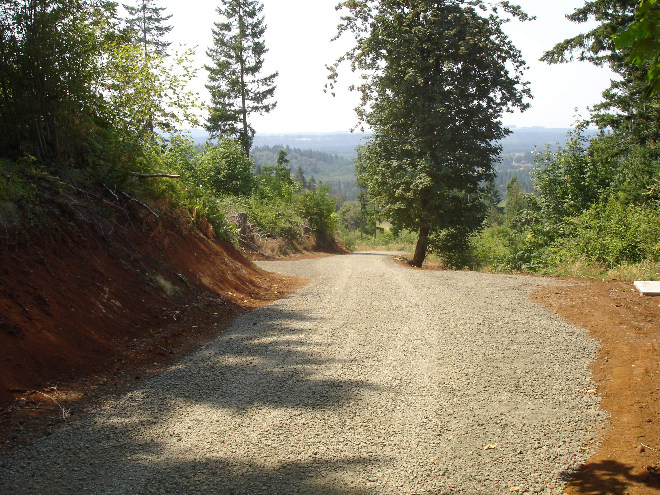

Can't quite figure out how to do text, pictures, text so i'll just do it in sections. The hill was pretty tough for the trucks to get up after laying fresh gravel so they had to drive in, spread on the way out. Then I'd water before the next truck came in so he'd pack it down, got it done without anyone getting stuck. I've got extra to fill in some low spots. Out of all the equipment the John Deere 3038e with the box blade got the most use putting the gravel down. I bought the sprayer about a year ago to battle the blackberries, more on that coming up.

Really your road it much wider and better built than what I had graveled... looking good!!!
/ 80 Acres- Eagle Creek, Oregon #92
Very nice. That is a ton of gravel (or rather many hundred tons...)

During the whole process I just kept in my mind that I had to make sure I could get up and down this with Trailers. The long straight sections are around 10- 14 ft wide and the corners 16-20. I'm pretty certain i can get a full size tractor trailer along the entire length. Before i started the gravel i drove up and down it with the 13ft flail and didn't have any problems. Who knows what kind of equipment and crops I'll end up with in the future.

590 to be exact, 40 trucks. Any where from 4-12 inches depending what was underneath. Some may think overkill but what I've noticed is when I started the first 500 ft I went 8", then I was thinking that was too much so the next 350' I went 4". After driving over this section for 1 1/2 years I have not had to touch the first 500' but the 350' that was only 4" constantly gets washboarded and rough, the entire 850' is all on the same angle of incline. So the second half is all 8" and on the 350' steeper incline is 12" deep. It should compact and bind to hold well.

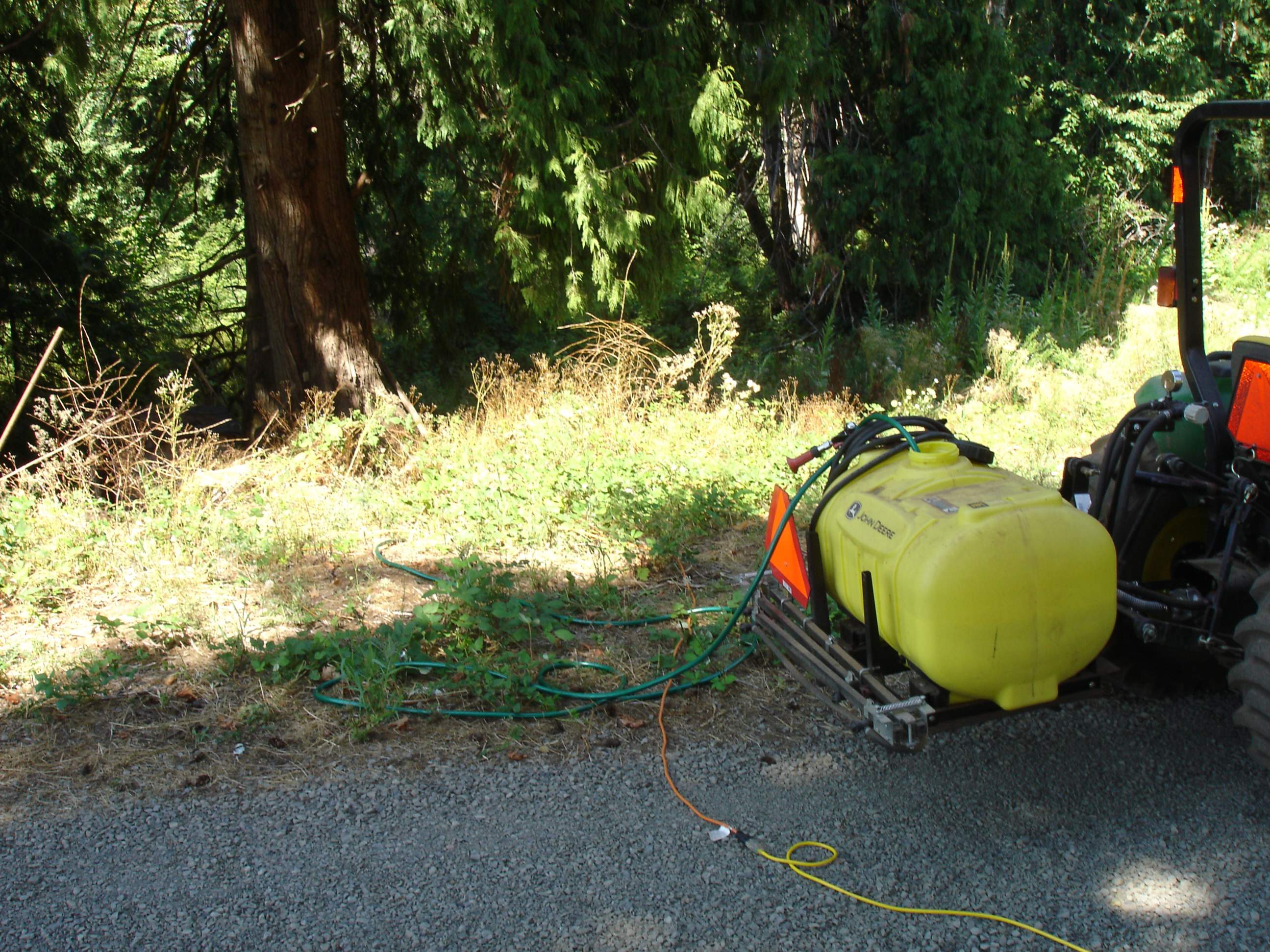

I would find it best to get as many of big the root crowns out with the rake on your dozer. I would spray any new shoots with Crossbow once they are around 18" to 24" long and leave them for 3 weeks or so. I would then brush hog and repeat once any new shoots get to the 18" to 24" range again. Every time you should have fewer shoots. Some will be from dormant seed waiting to grow. Some will be from root fragments and some will be from missed root crowns. The ones from the crowns are the hardest to kill since there is so much mass to the root. The ones from the fragments and seed should be easier to kill with the Crossbow since there is less root mass. Mix the Crossbow at the recommended concentration and apply it with surficant so it sticks. The reason I like 18" to 24" length is so there is enough surface area for the herbicide to adhear to and transport itself to the root. Closer to the root is better. I would burn the berry canes over the previous growth area so that you kill any roots there (might as well). I would prepare the soil and seed with grass as soon as possible to help choke out the berries. Crossbow does not kill grass. Keep us posted please. Good luck, you CAN do it. It will take a few years, then forever maintenance spraying, but even that will go down.
I've been following your advise and agree 100% this is the best way to combat them, some areas are now blackberry free. I tried some cheaper products than crossbow but a waste of money, crossbow is the best for blackberries. I have found also it works better on the big crowns when you spray closer to fall and into it when they are pulling nutrients back to the crown after all the berries have dropped. I did end up buying a sprayer that holds 60 gals, has a 12' collapsible width with a pressure gauge and adjustment to control pressure in the tank, and a wand with 30' hose, and the best part is a see through tank so I can see the water level. Usually only run about 30 psi for the bar to get the correct application rate, came with a book that had different pressures with different tips already calculated out - money saver. The wand is awesome cause I can crank the pressure up to 70-80 and this thing will spray close to 100' feet, over if the wind is up. Nice for some of the steeper areas. I also have been using it for a fire watch when open burning is permitted.

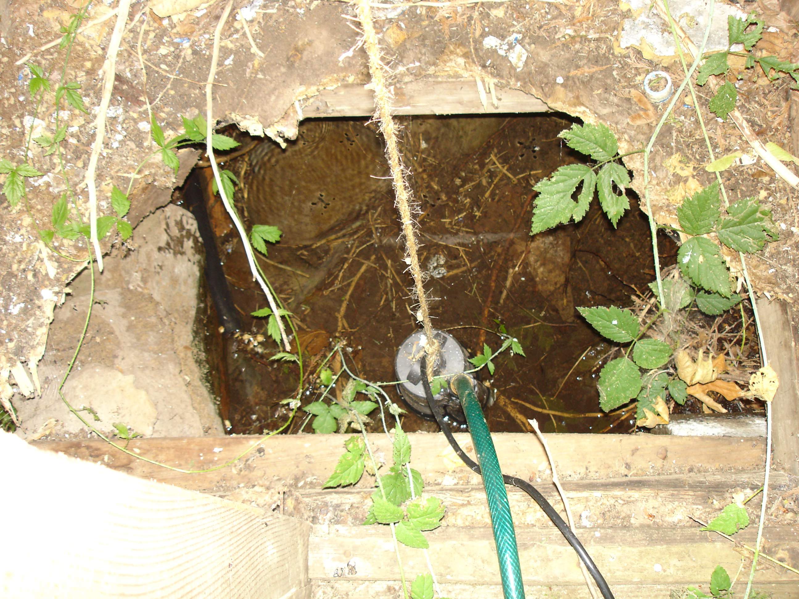

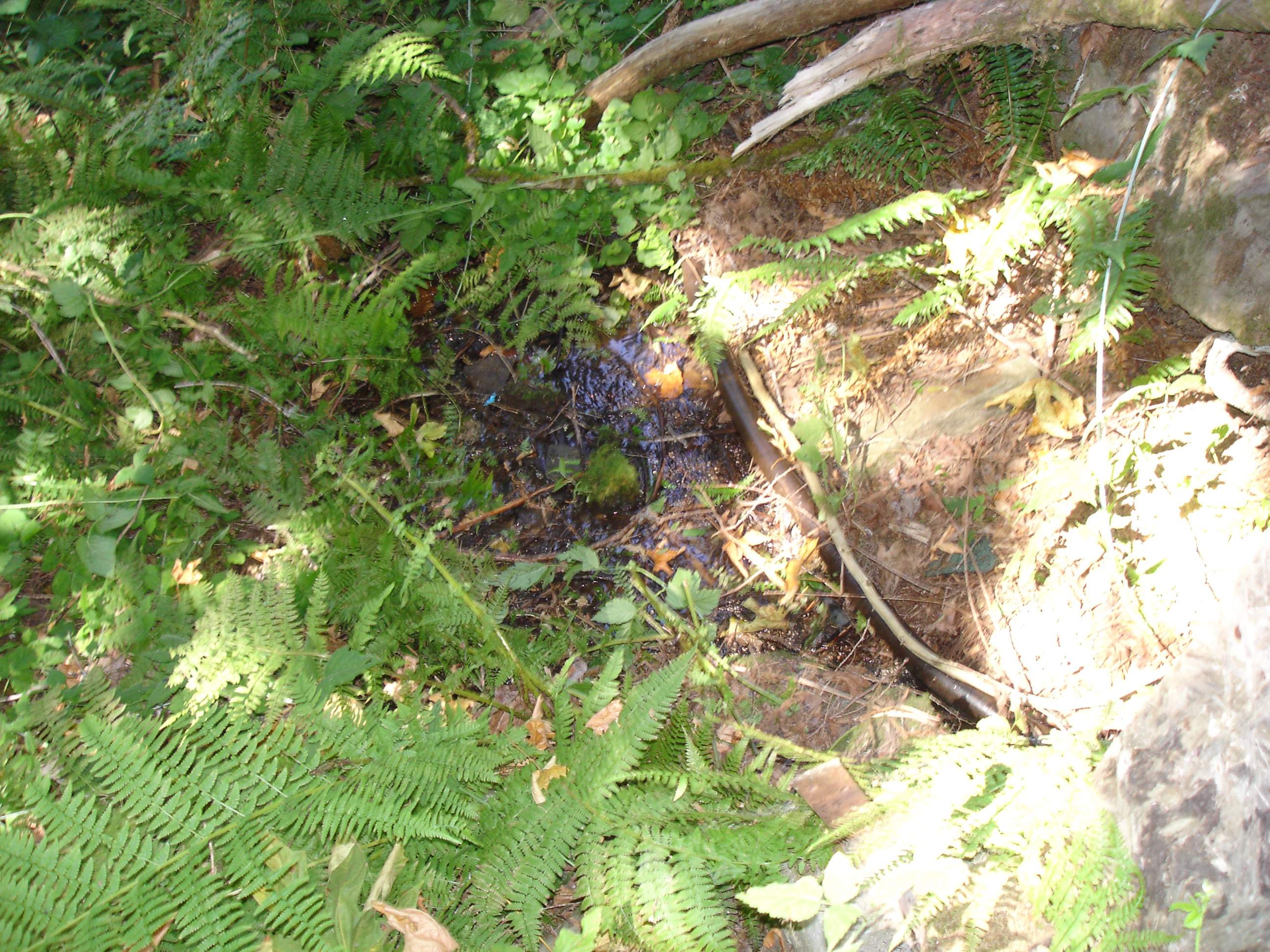

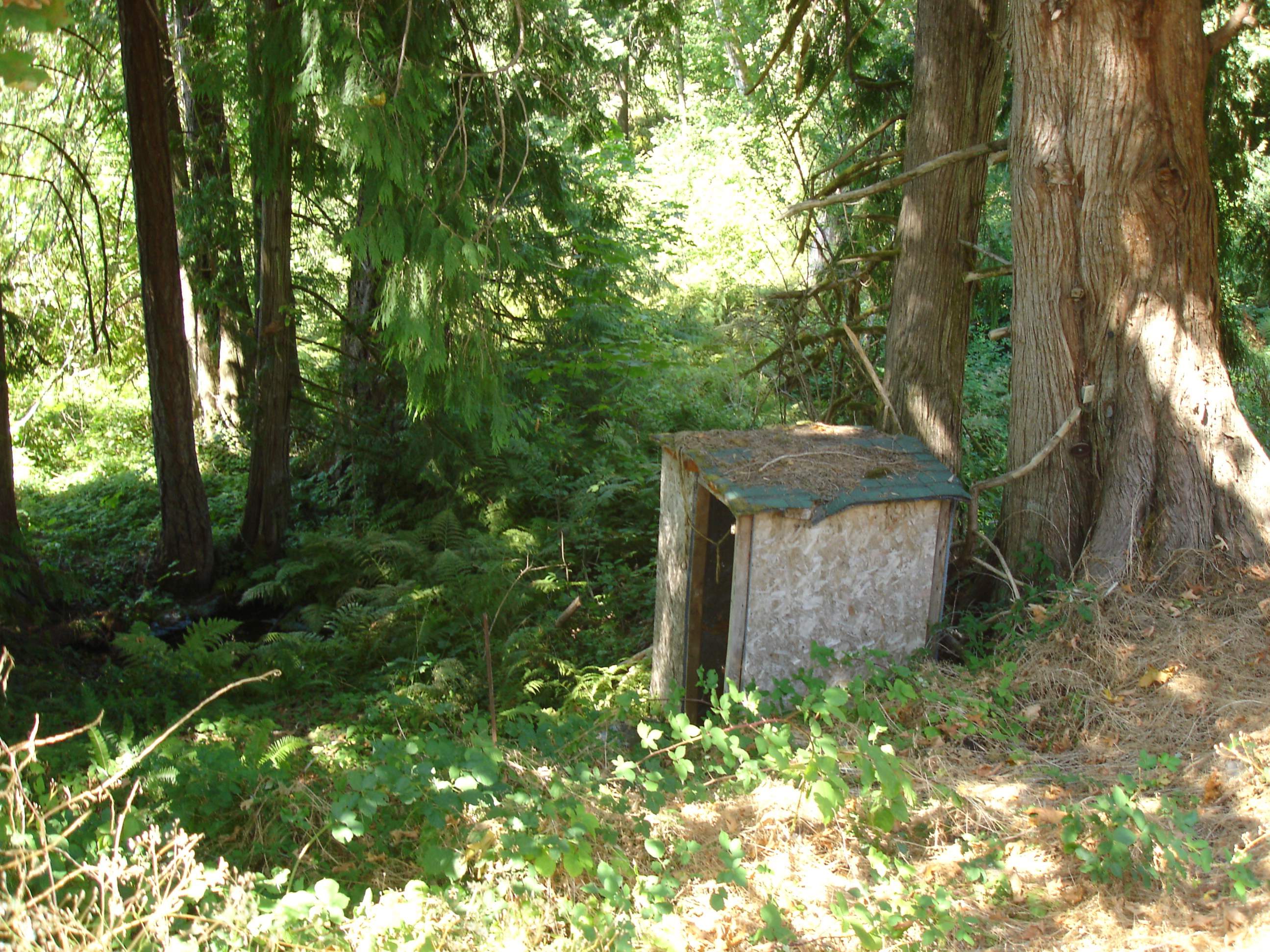

Been using the spring for water and it's nice now that the power is in, not having to drag the generator around. The little shack was already there that someone built over a pool they made right where it comes out of the ground. Picked up a submersible pump from Harbor Freight and hung it high enough that it just gets clean water. Eventually I'll make a bigger holding pond so I can pump more in a shorter amount of time. I haven't noticed any drop in volume even during this drought, sticking a 5 gal bucket in the stream fills up in about 10-15 seconds. Must note that the stream is only as wide as the bucket, so i'm not dipping it in standing water, the stream is about 7-8" wide and 3" deep.
