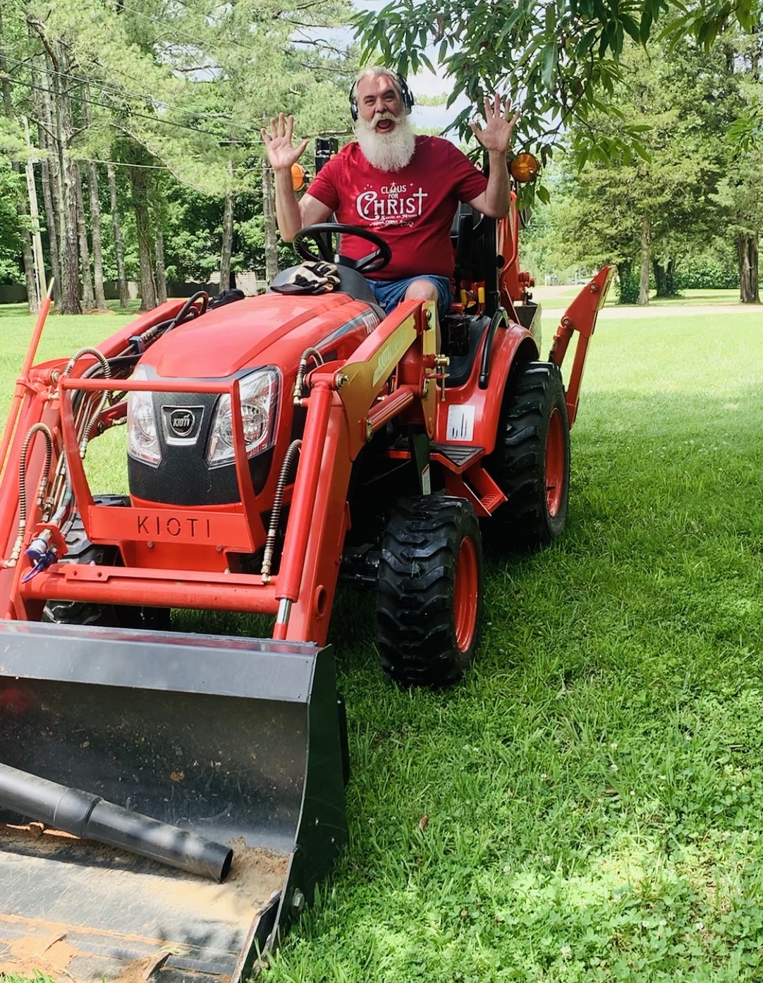

I’m in the process of purchasing 50 acres of land to build on. It’s a mix of overgrown fields, trees, and medium slope. A lot of what’s under canopy and in the field is quickly being overrun with small evergreens. I know my current CX2510 TLB is likely undersized for the property but it’s what I have to start. I also have a land plane. It also has 3rd function installed but I currently don’t have anything that uses it.
I’m going to need some more attachments. Right off the bat I’m going to need a brush cutter so that I can mow and get a better feel for possible homesites, as there are several on the property. I’m thinking I may want a post hole digger too but that can probably wait a few months.
I’ve not yet acquired any attachments that the dealer didn’t sell me with my tractor and I’m really not super experienced with them, but I will most likely be buying them used. I grew up around tractors but minimal first hand experience owning/operating. How do I know what will fit my tractor and whether the hydraulic system is capable of handling it?
For example on the brush hog I could see getting a larger size to mow the field but a 4’-5’ one to mow around treed areas, but how big can my little tractor handle? Also wondering about getting a cutter that attaches to the loader instead, if that’s possible with the third function?
(Pic of me and my tractor for interest. Approaching my first 50 hour service. Prior to this I had a Ford 881 but never used it much for anything except pulling stuff.)
