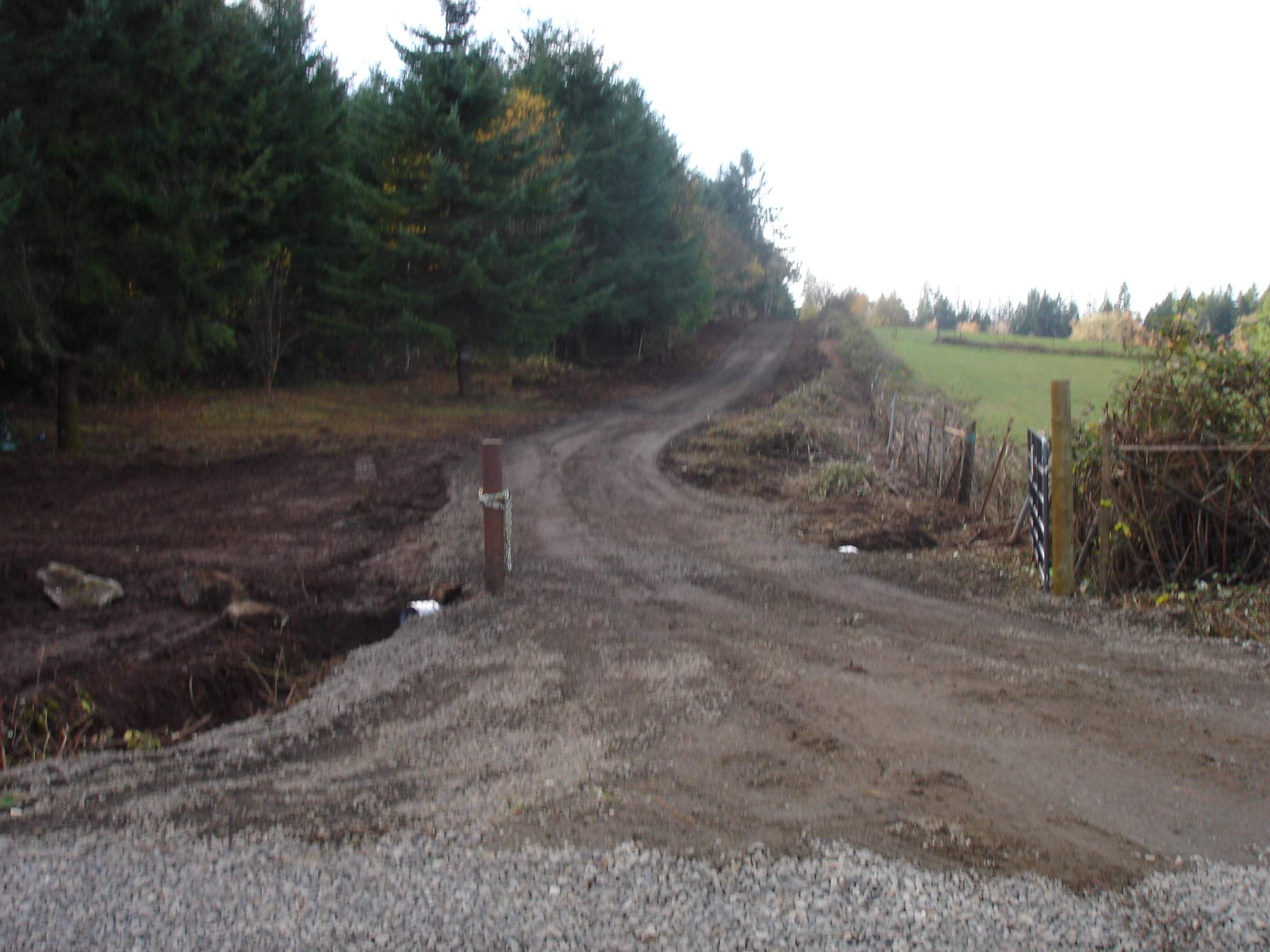

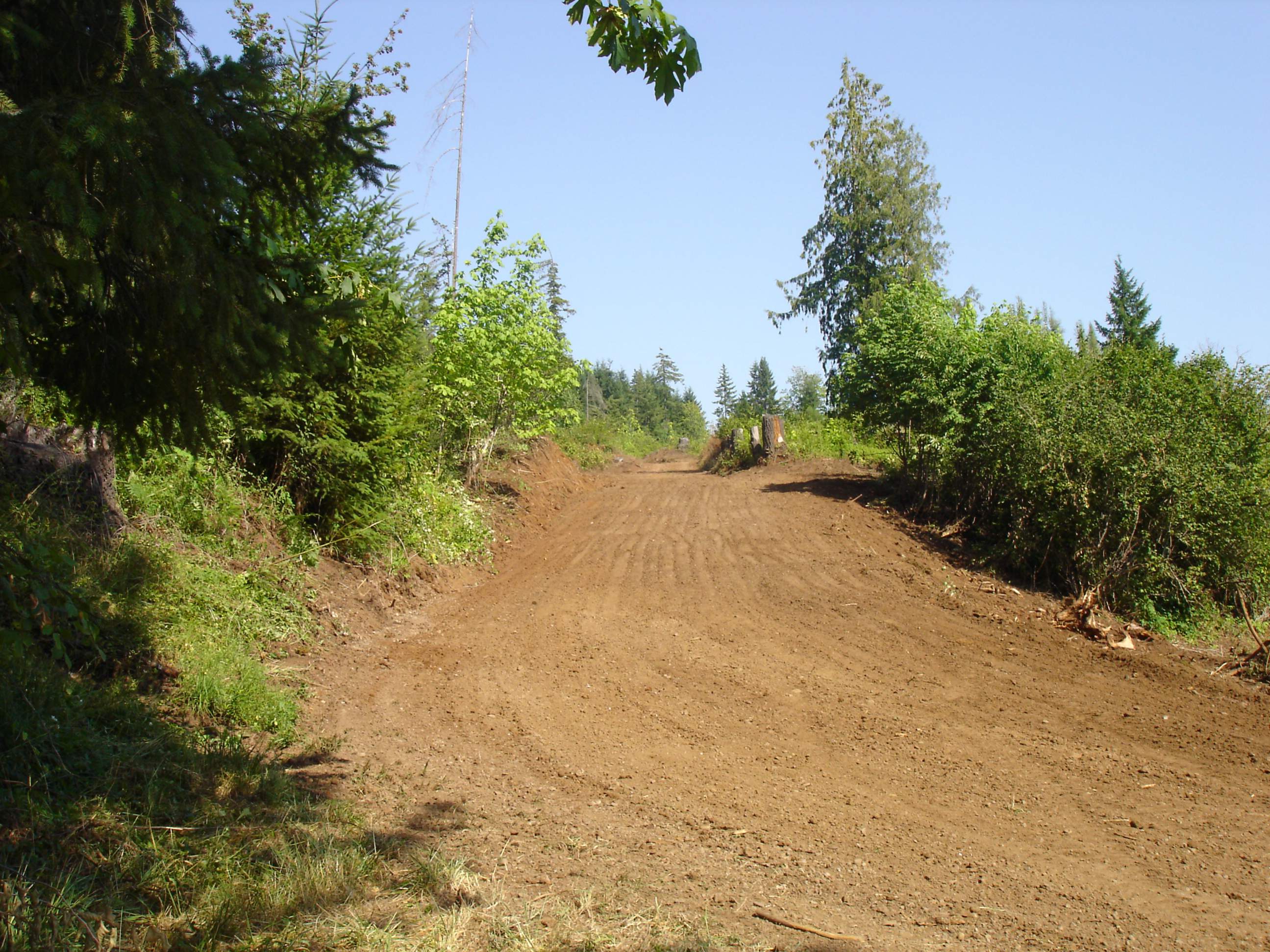

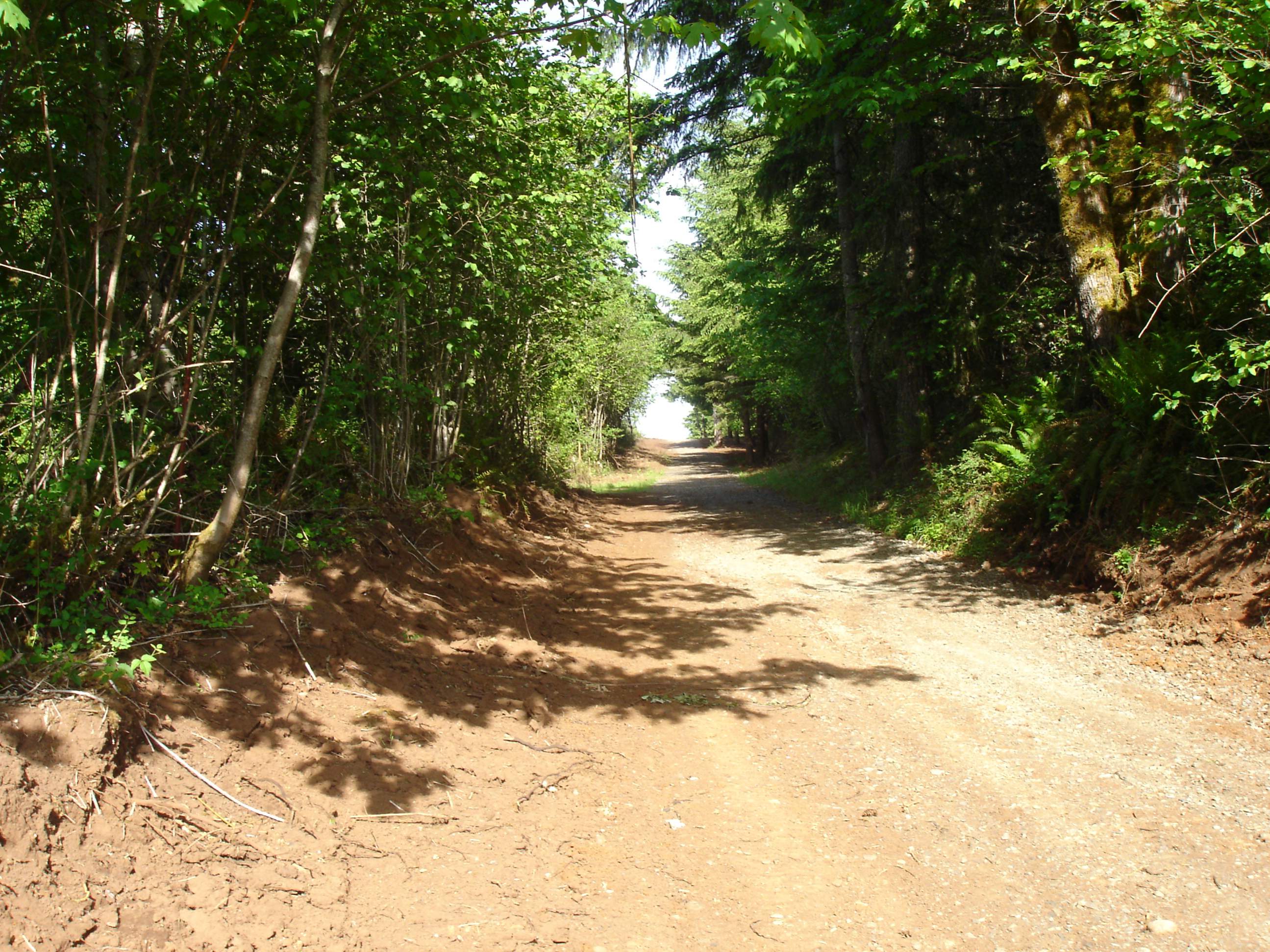

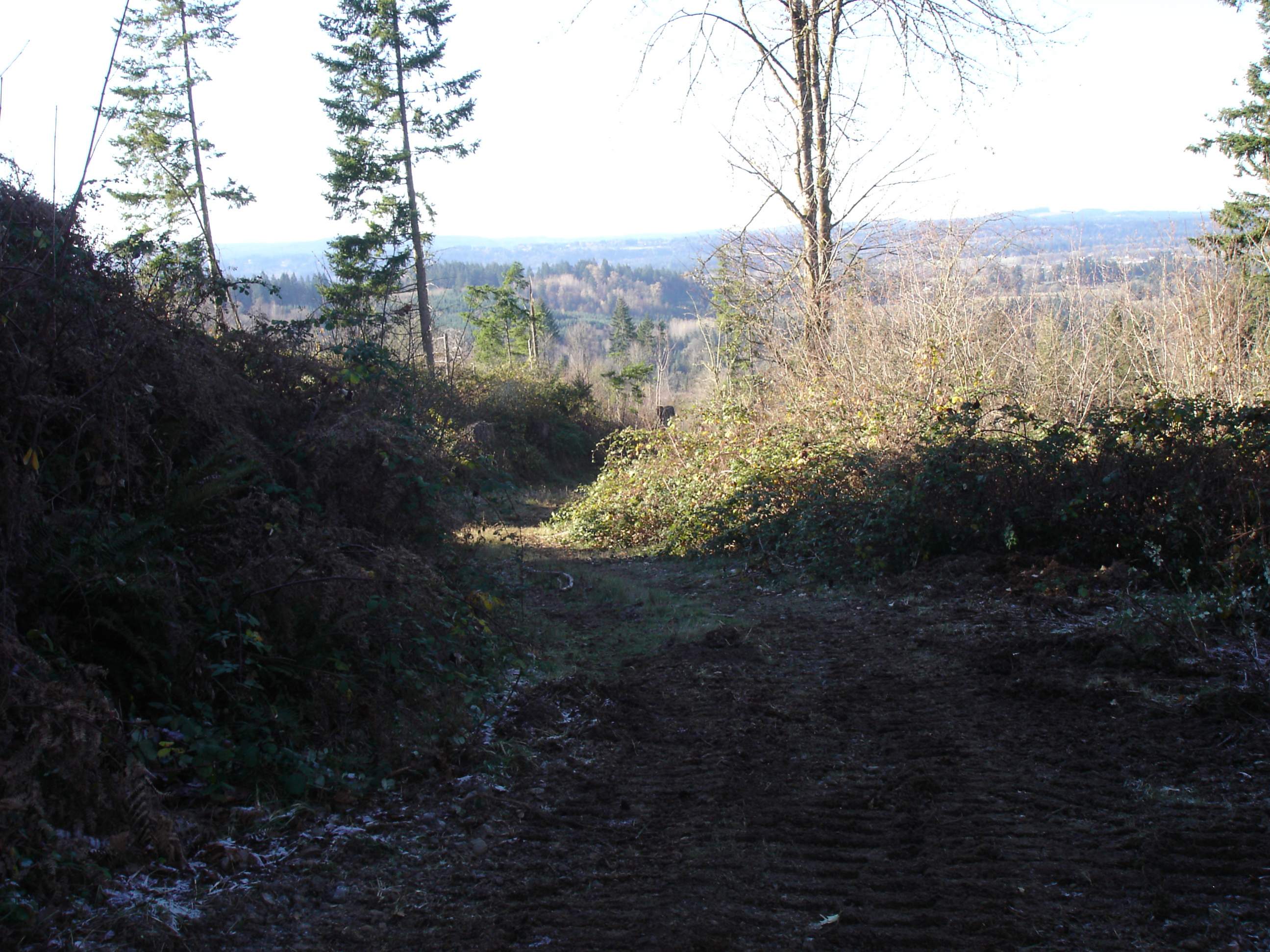

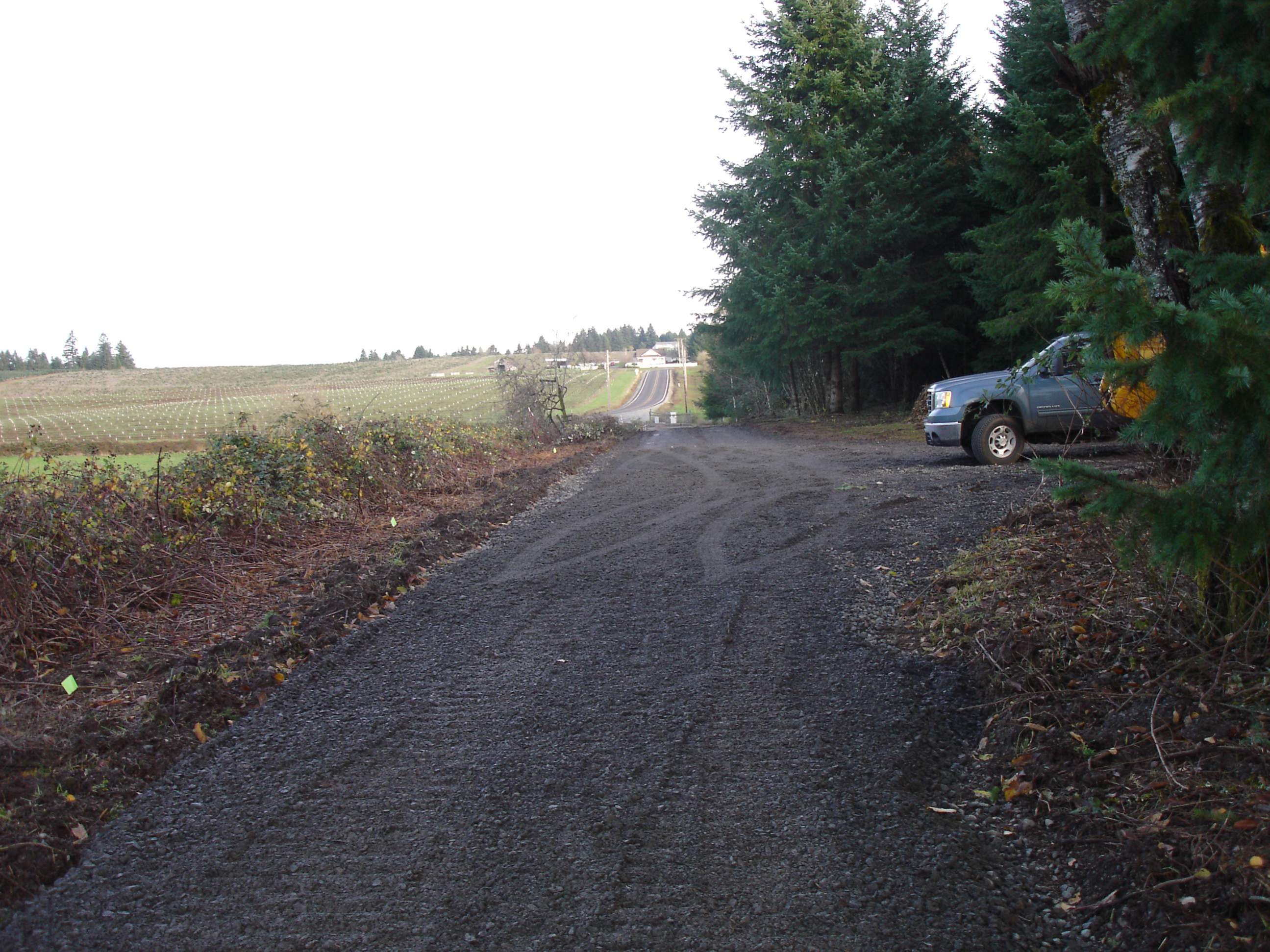

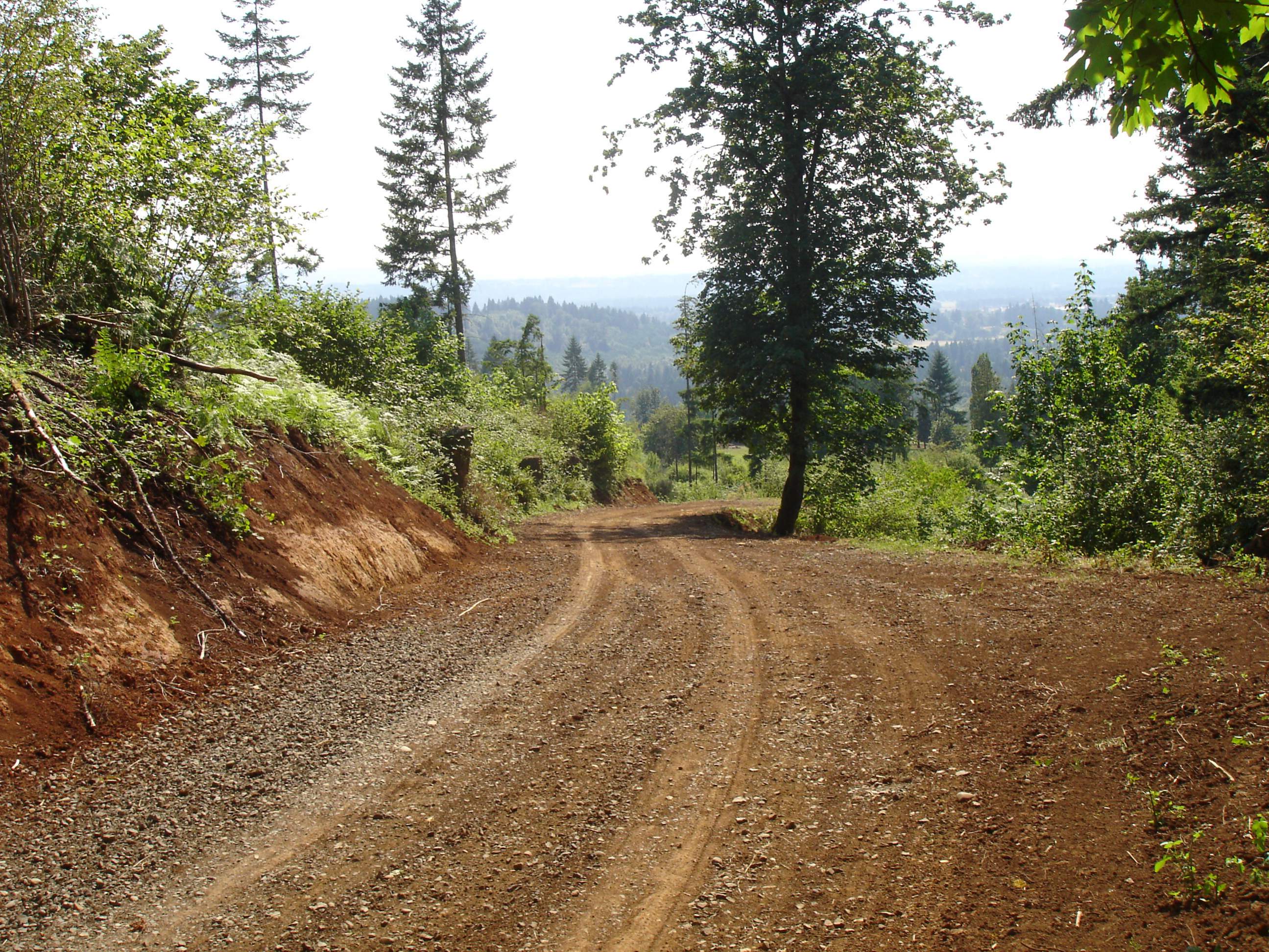

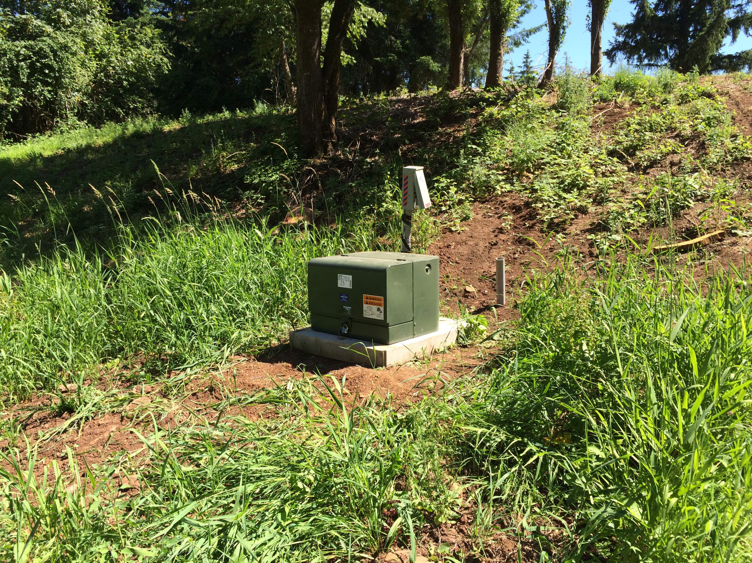

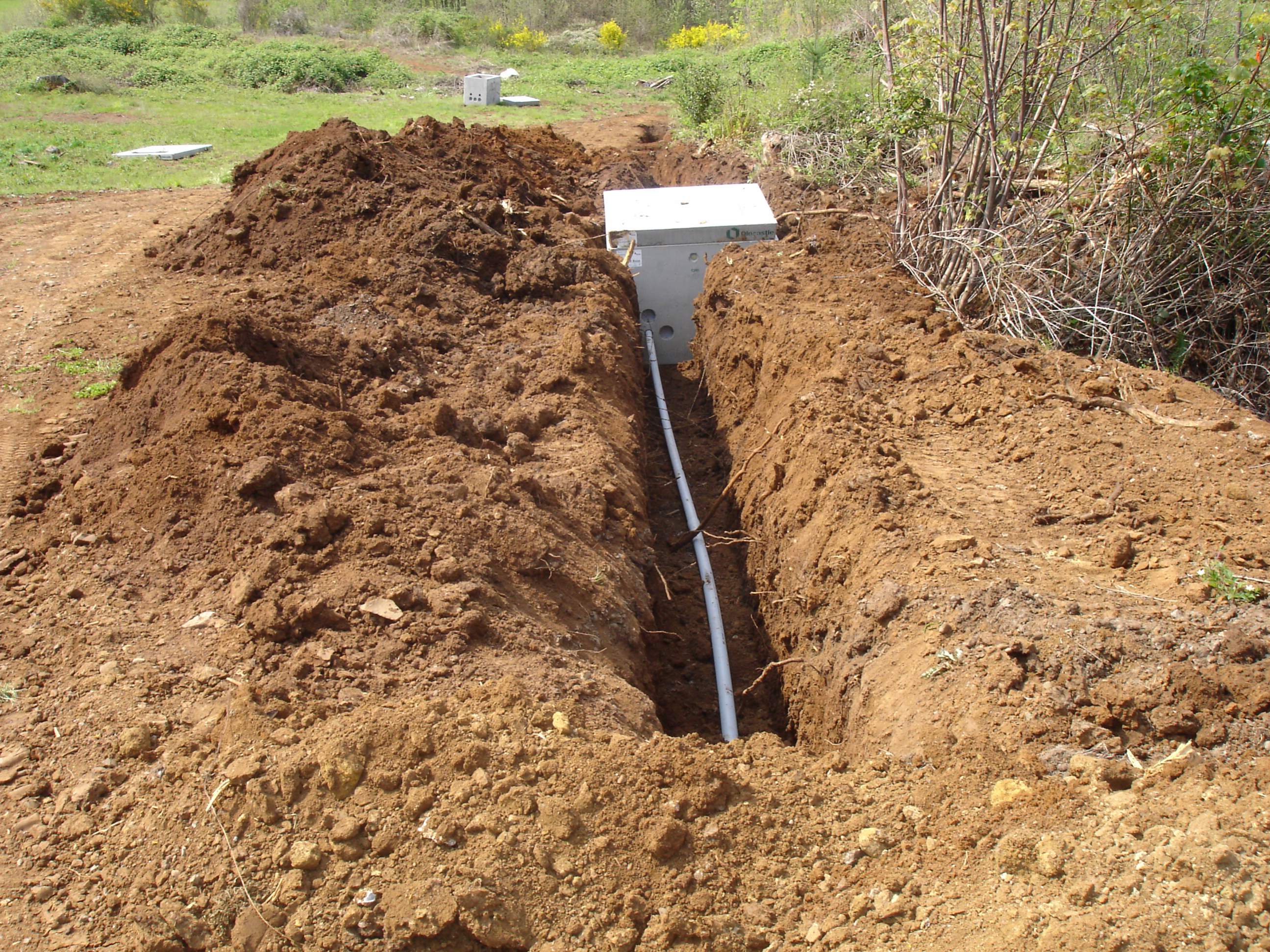

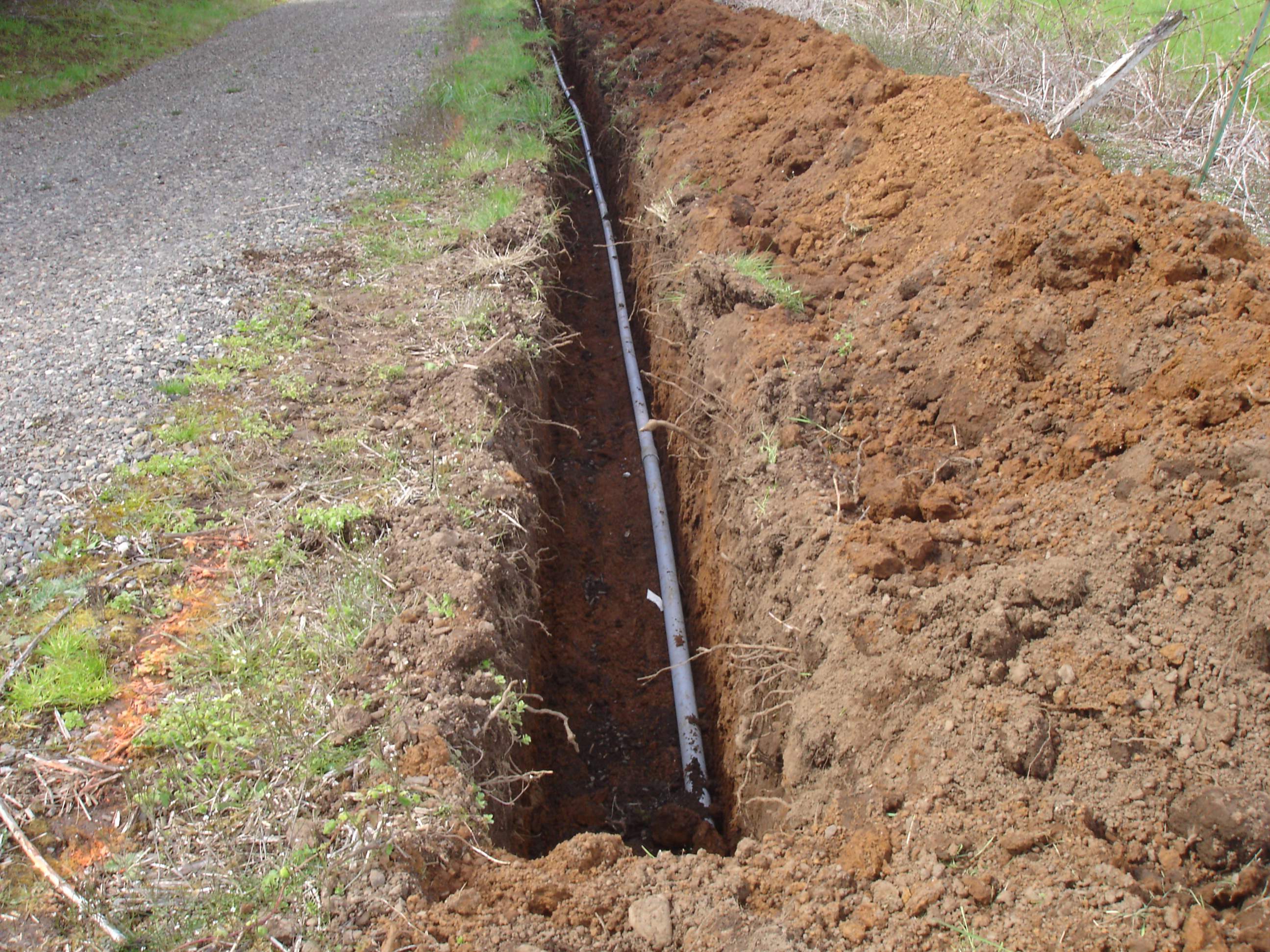

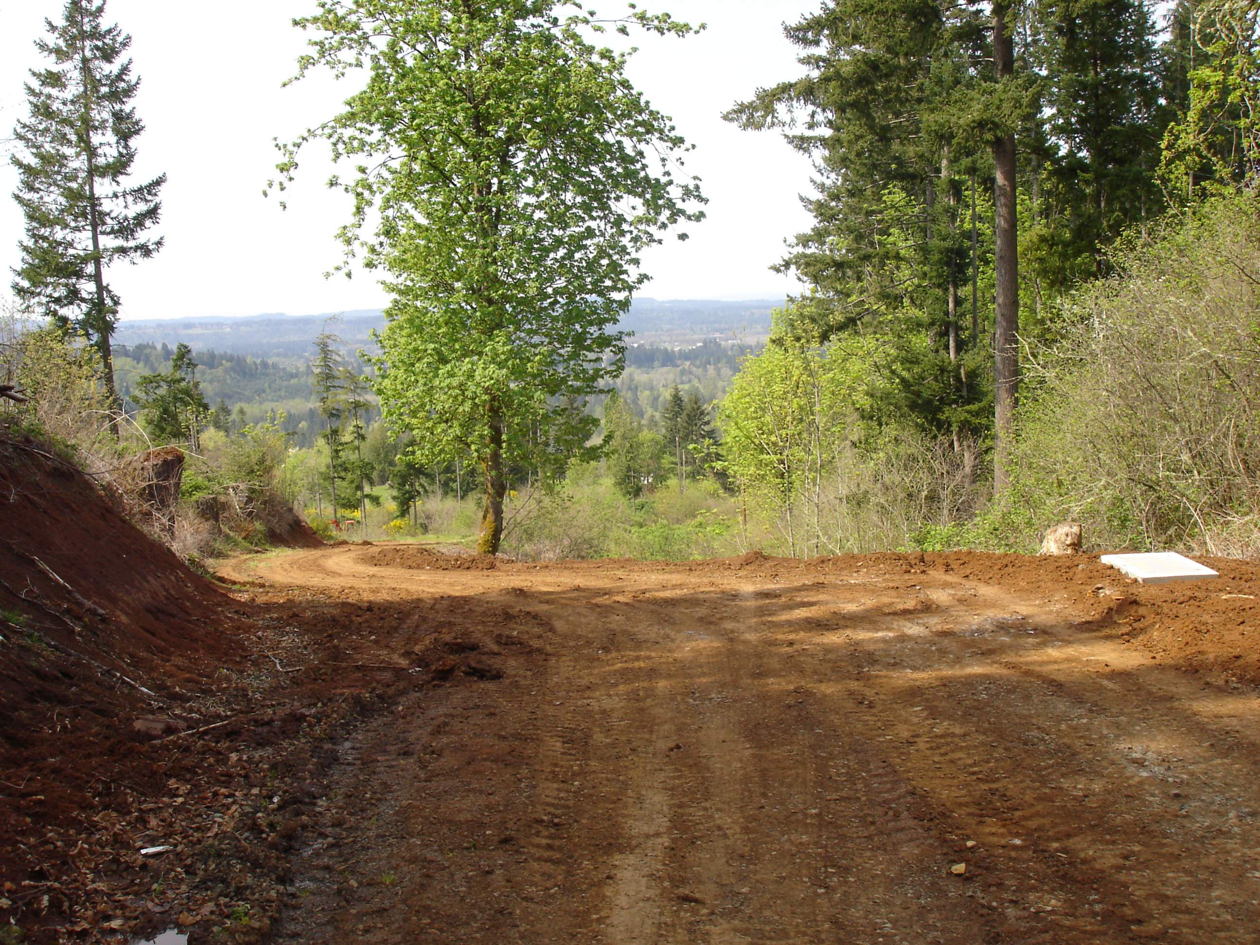

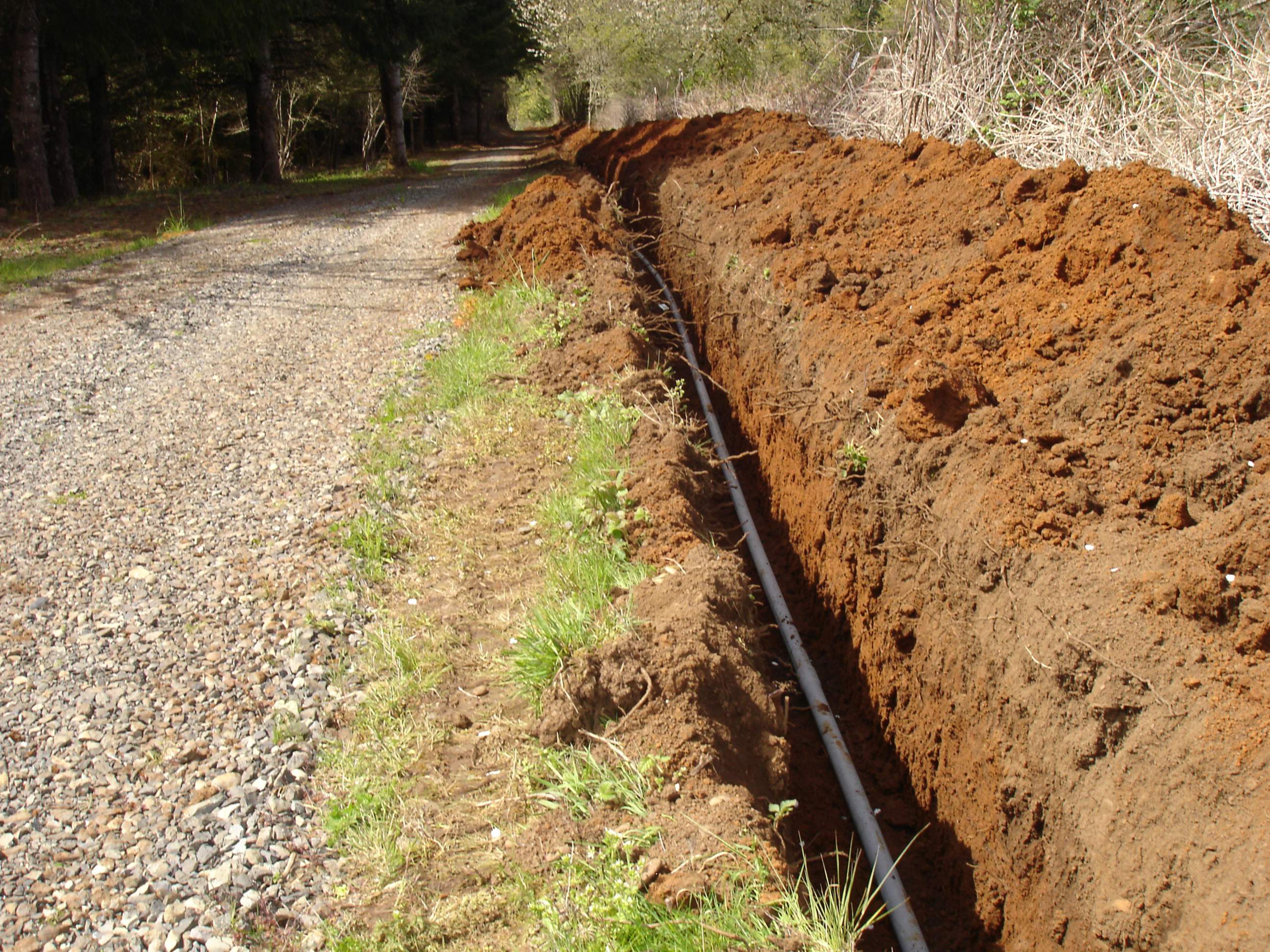

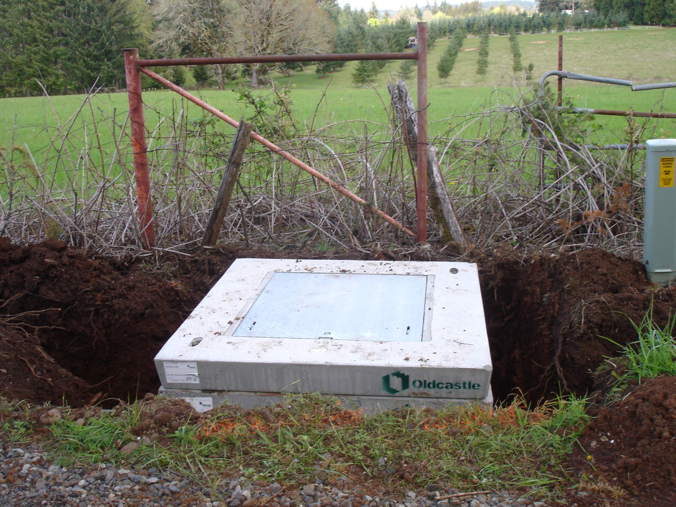

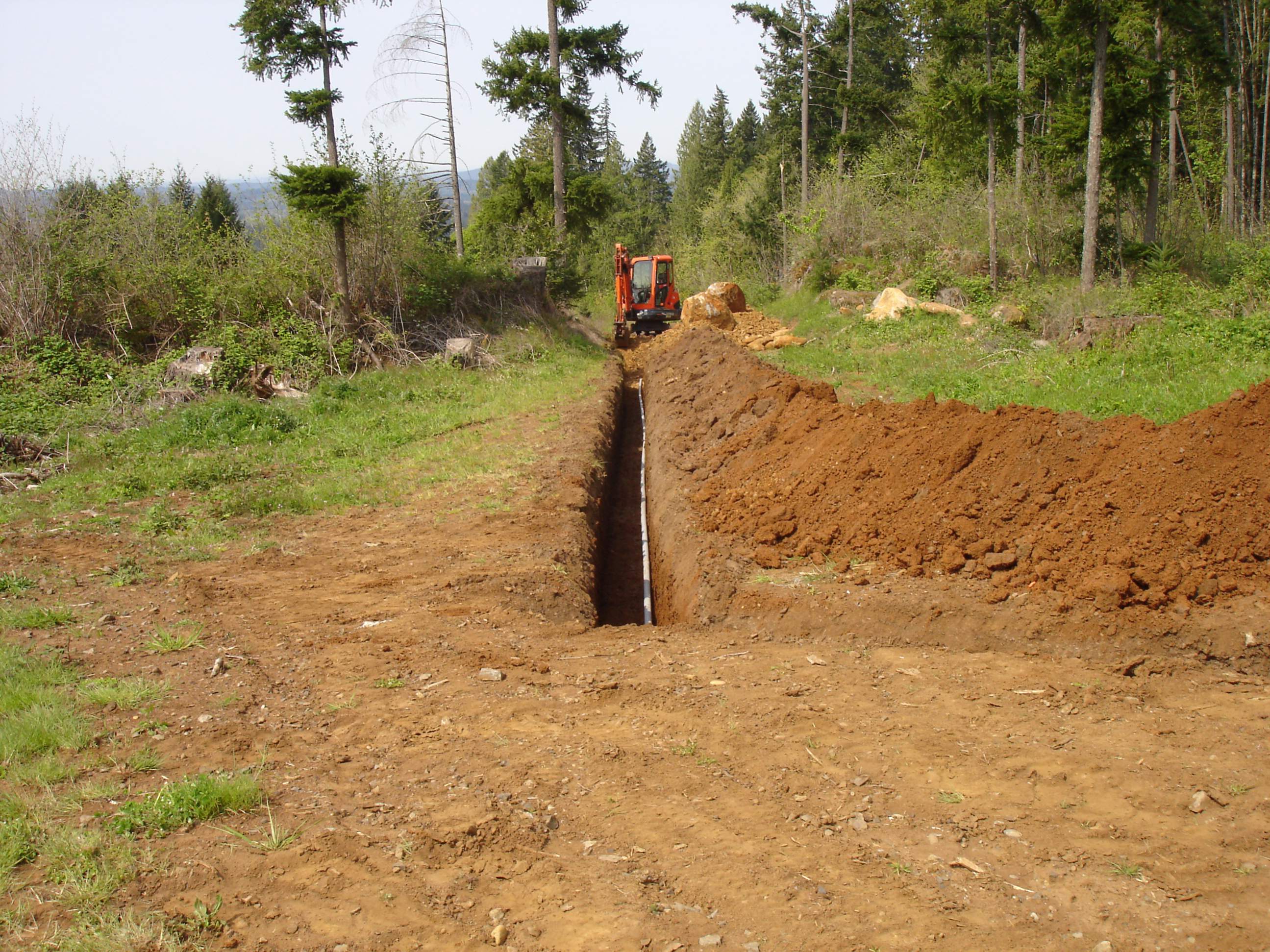

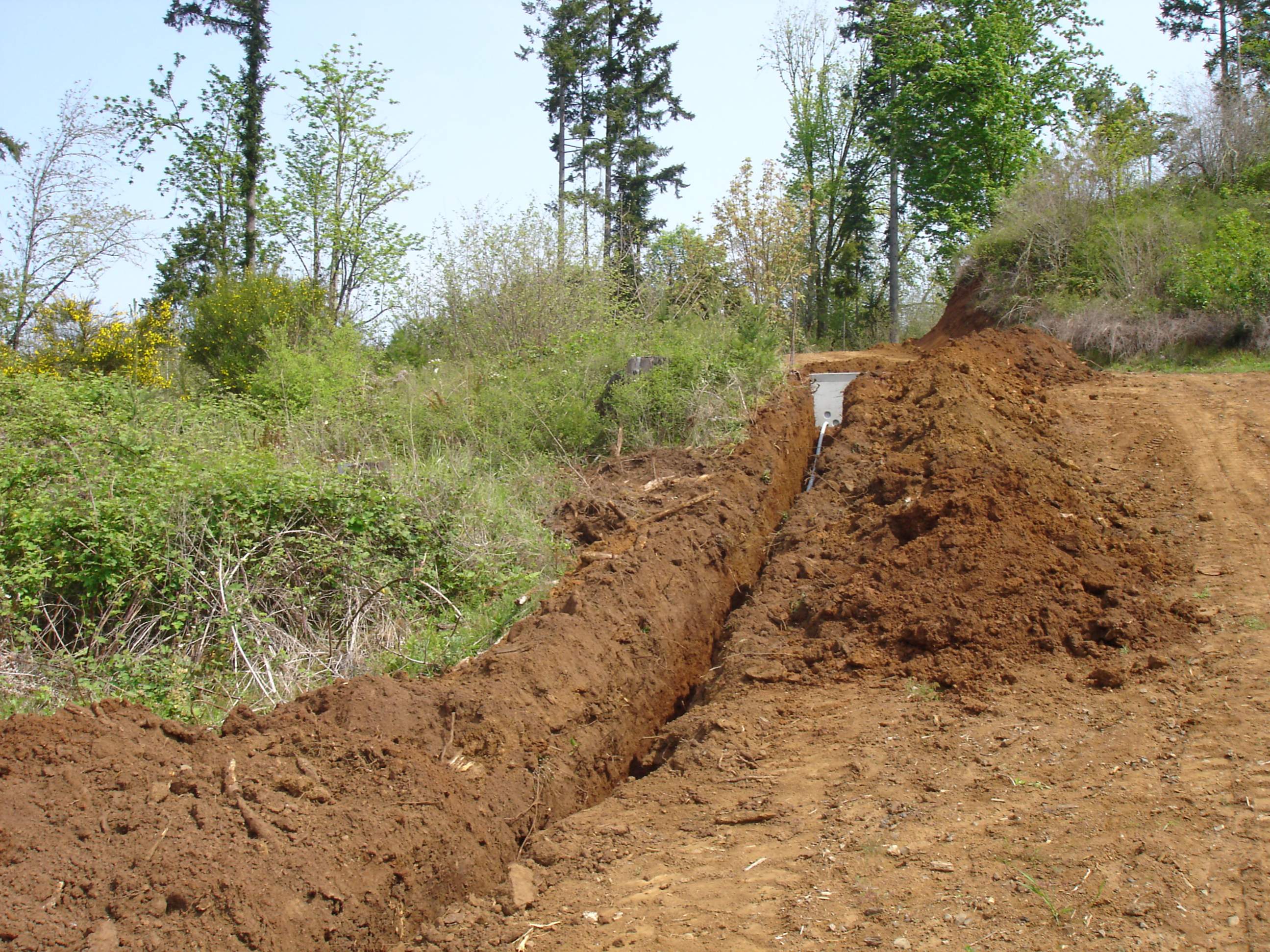

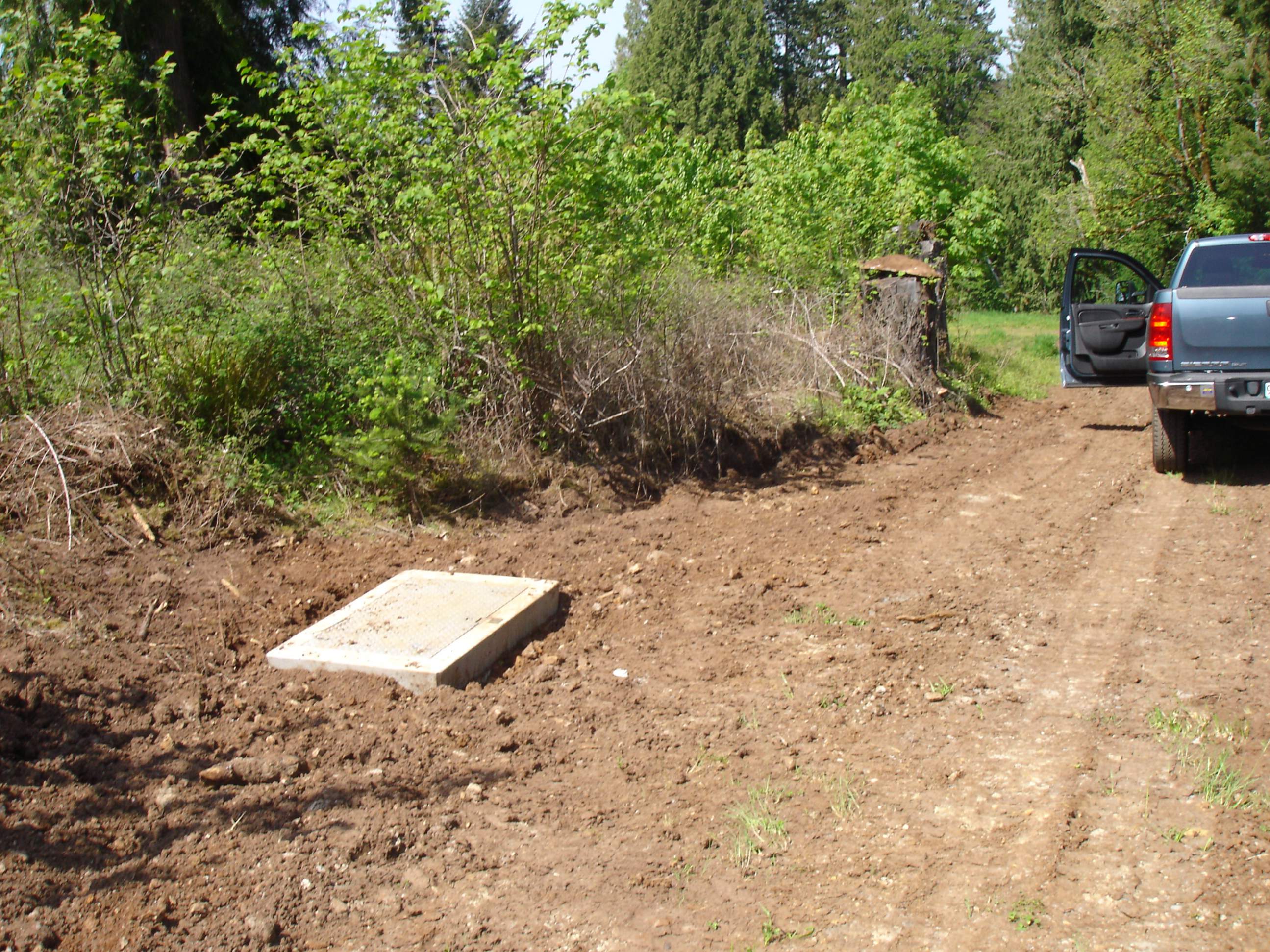

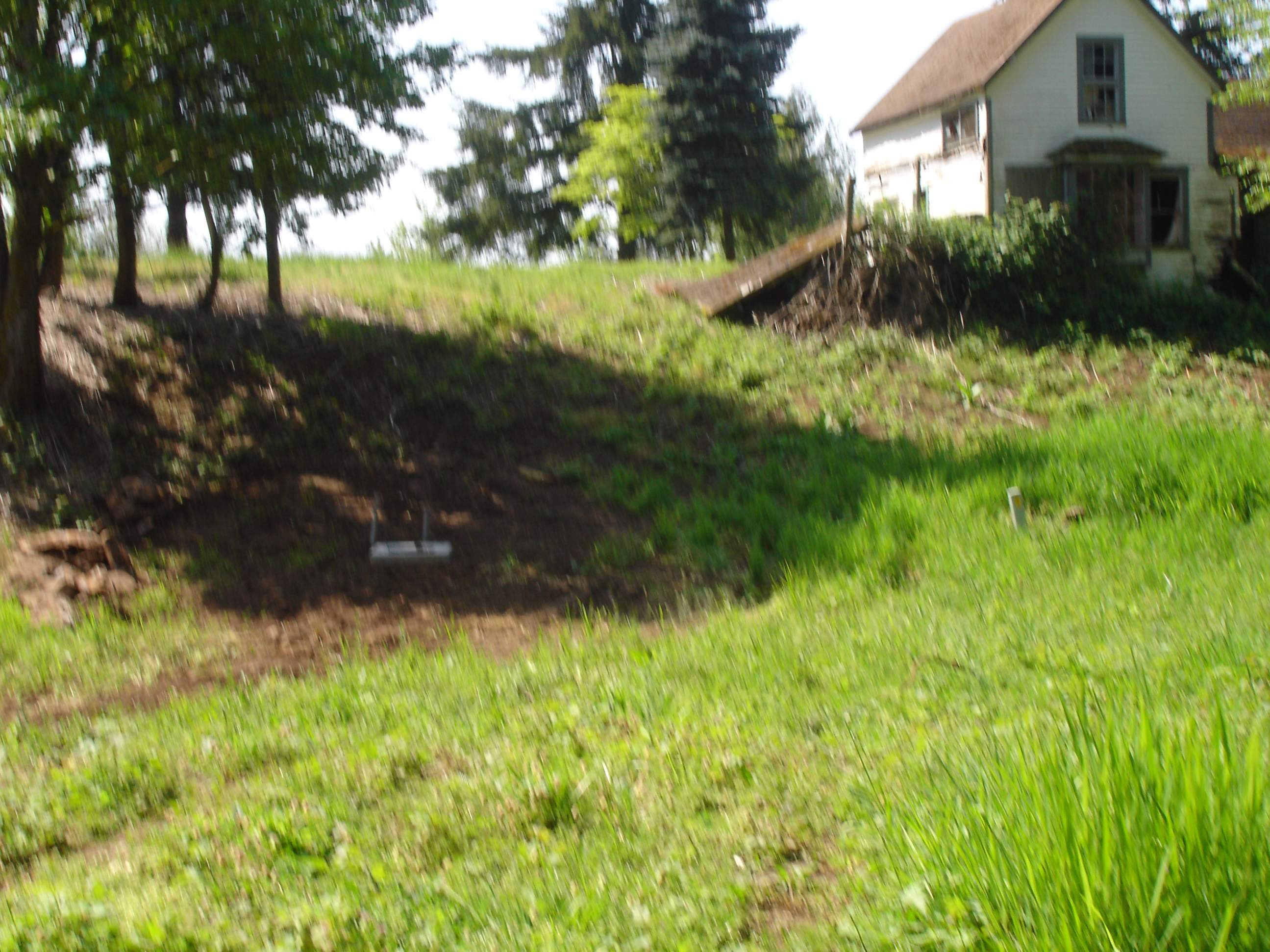

It's been awhile but I did make some progress while I was gone. I took months just to get PGE to finish up the plans. I went with 320A single phase service underground, a total of 4 pull vaults and a pad with one extra run of conduit. 2 of the pull vaults can be branched off of in the future. Total distance was 2500' and a price tag of 37K. The wire and transformer were 18 and because I wanted it dug in before I got home I went with a contractor, so that was another 19 for excavation, vaults and conduit. They are already finished with the install and I had my girlfriend get some pictures. So my first project is to get the drive way straightened up and put gravel down so PGE can come in and pull the wire and set the transformer and hook up temporary power. The contractor got ahold of the phone company to see if they wanted to put anything in the trench but they claimed the existing line was put in not long ago and when he got close to or crossed it he seen that they actually ran extra conduit with the direct buried phone line.

Looks like you are all set...
As much as I like to keep expenses to a minimum... this should be a once and done.
Thanks for posting the pictures...

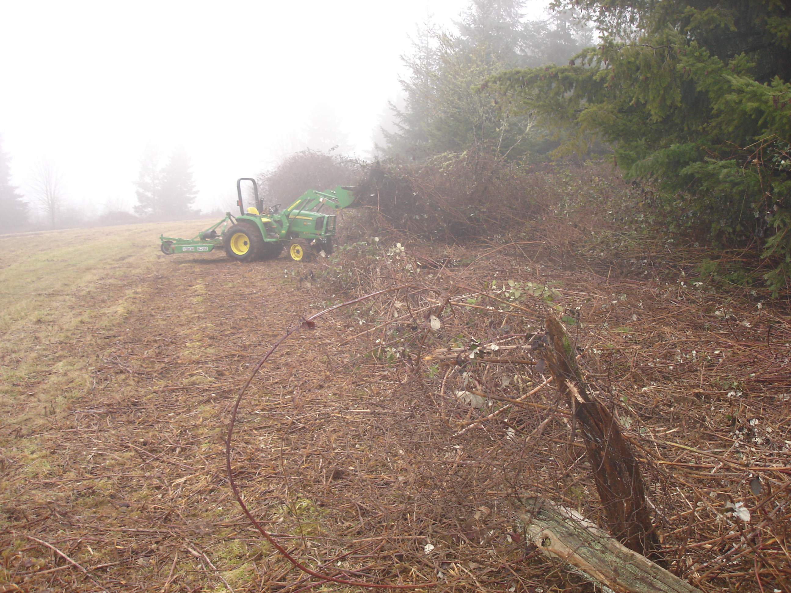

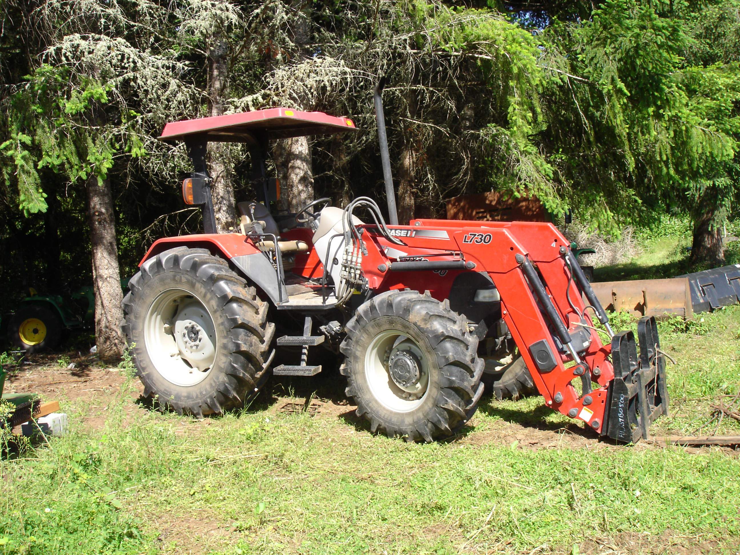

The John Deere just wasn't big enough any more to maintain the fields, now that they have been cut they are filling in and getting thicker. Been watching for a decent price on a larger tractor and found one. 2007 JX1090U, pallet forks and a bucket.
I also found a 13' Verisimo flail mower for $2000 in good condition. Had the scoop knives on it so I spent $300 and replaced them with heavy duty side knives. Now it only takes 6hrs to cut the fields instead of 3 days.

Nice looking case! 13' is a large mower, is it solid or is there one or more pivot points to allow it to follow the ground?

Solid drums so it has to be somewhat flat to get a even cut, i just needed something to keep up the fields until I recondition them and start haying it. 40 acres was already in tax deferment when purchased so I have to at least keep the appearance that it is being farmed otherwise the tax man gets 7 years of back taxes.
Happy with the Case so far, 85hp at the pto and 6000 lb lift at 3pt so I don't think i'll end up needing anything bigger. I was looking at 50-65 hp tractors but some round balers use that minimum and if I end up having to turn the field over or decide at some point to do an annual crop the Case would handle it. Might be a little much for hay but too much is better than not enough.

You care to give us some more details on the new Case? Hours? Transmission? Price?
Good looking tractor and cutter.

Here's another thread about the tractor - http://www.tractorbynet.com/forums/case-ih/337975-2007-jx1090u.html
2500 hrs, $29,000, Synchronized shuttle dry disc 12 F/R. I have been having some issues with clutch engagement so I may go from "Happy to Unhappy"
The seller was a Nursery/Produce farm that was going out of business. I was 50/50 on whether they just wanted it gone or there was something wrong with it. When I drove it around for about a half an hour there wasn't any noticeable clutch issues, they didn't start for about 2 weeks after I got it home.

The mechanical shuttle transmissions from case uses a dry clutch at the engine but also uses wet clutch packs inside the transmission. Unless they changed the design from the 895 series. I've rebuilt the ones on an 895 before. Not a hard job but requires a split. If I remember right it was a $400-600 job.
You might try adjusting the dry clutch first.
/ 80 Acres- Eagle Creek, Oregon #79
Agree, I would adjust the dry clutch first.
