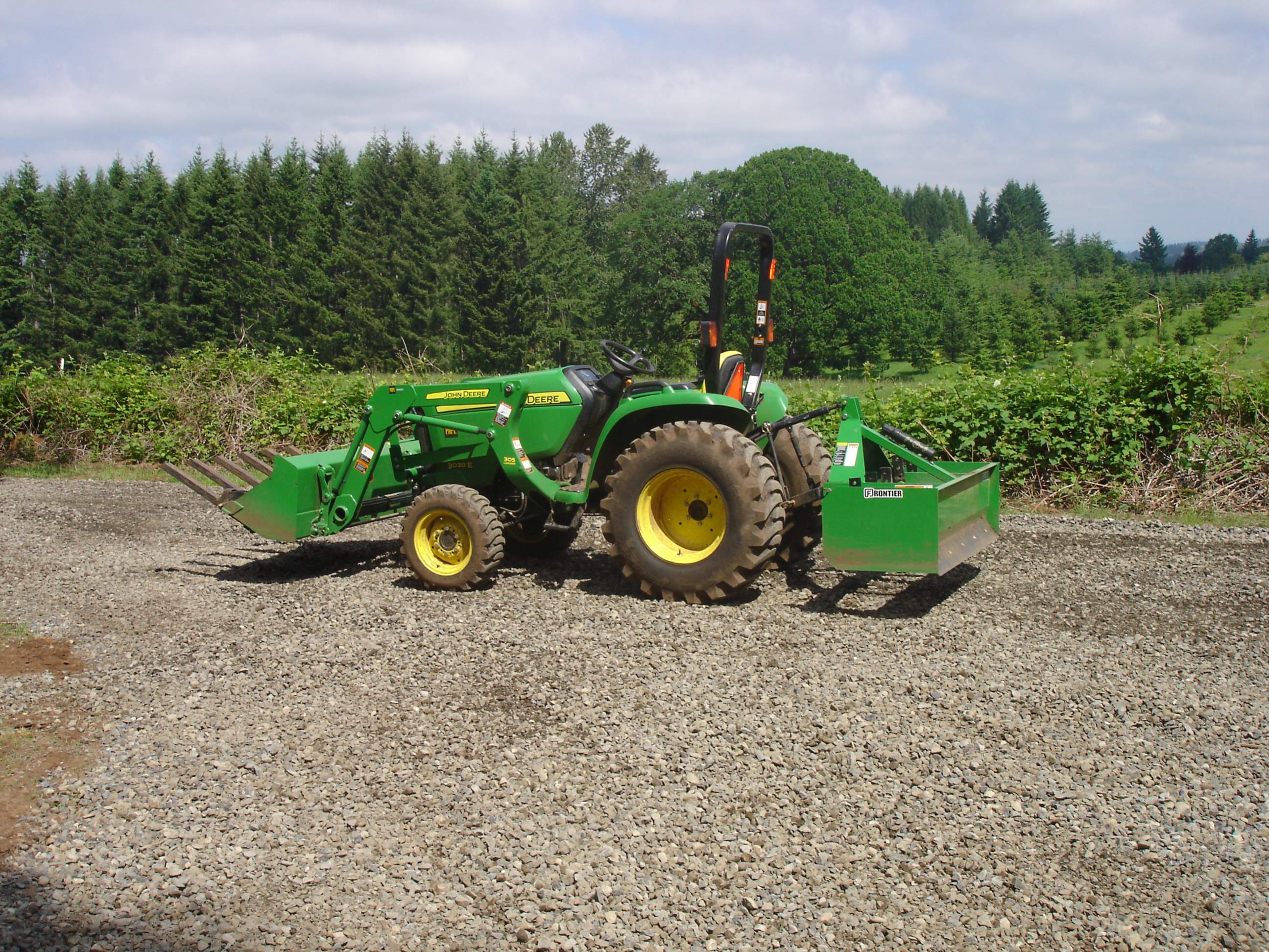

Impressive job. The before and after pictures really show how much work it took. That dozer and excavator were worth every penny I'm sure.
At first the wife didn't understand why i had to get the size of the equipment i did but now she understands. I did purchase a box blade to get the final touches on the second part of the driveway and i've used it for straightening up the places I cleared blackberries, it's also proven to be a good investment.

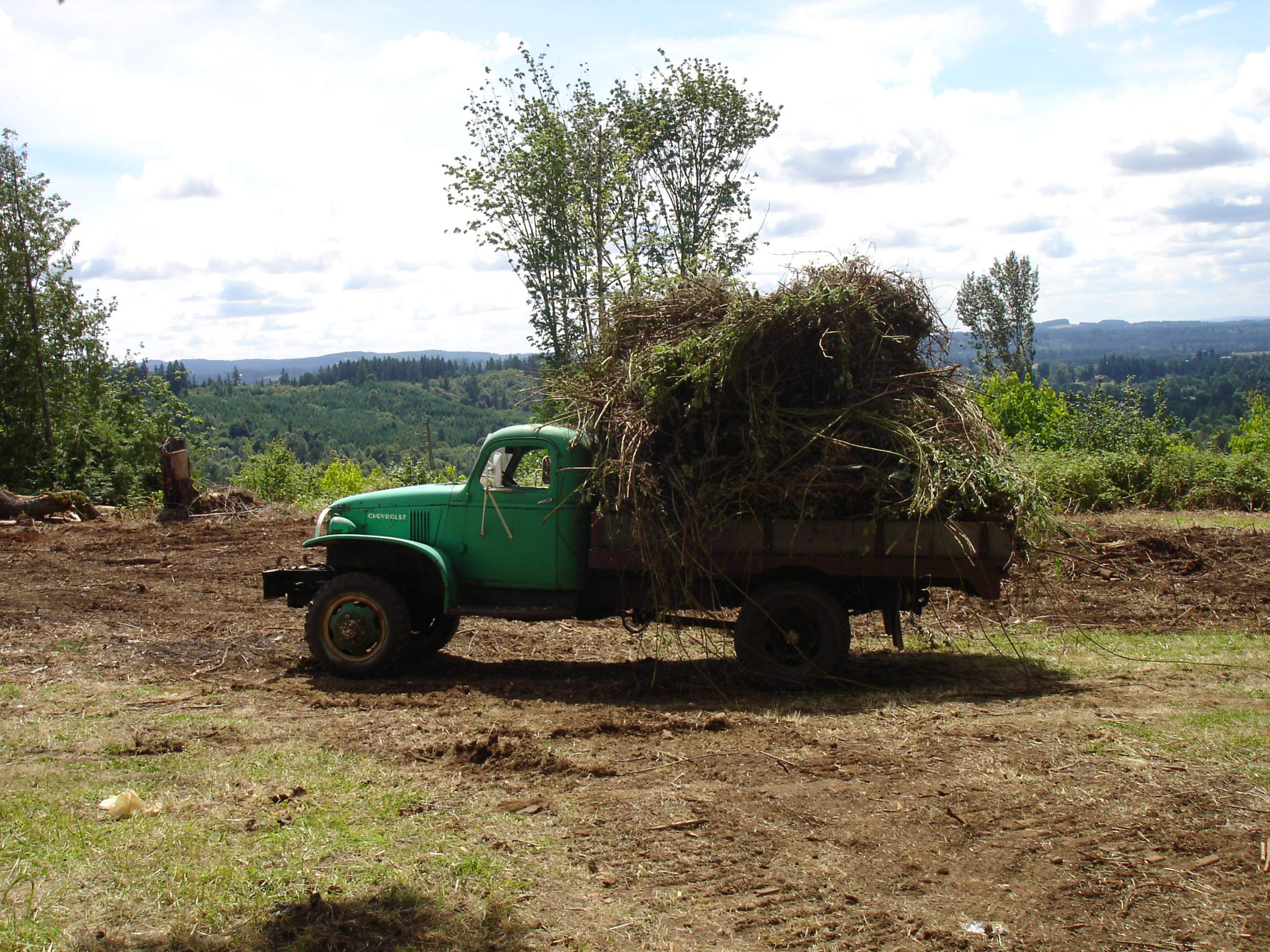

And of course I need something to haul all the piles around. I got tired of having piles scattered around so I purchased a 1941 Chevrolet Military dump truck. Pto dump, 4X4 with a winch on the front. I now have a designated burn area i bring it all to, open burning is done for now so I'll just pile it up until fall
So far only a couple broken hydraulic hoses, plenty of grease and fuel though.
/ 80 Acres- Eagle Creek, Oregon #43
Cool truck -- I would kill for one like that.
