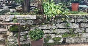

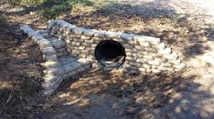

My father built several hundred feet of retaining walls, flower bed landscape wall, and a set of stairs 90' down an escarpment all from broken driveway and sidewalk pieces that he'd pick up at various locations.
My wife tells me that in the fancy home fashion magazines, stacked chunks of concrete slab to make walls are called "urbanite".
When we were looking for the place we eventually bought we looked at one where a previous owner had gotten a bunch of broken concrete slab and mortared chunks together to cover about an acre of the property. Supposedly that was in response to the '89 earthquake which was epicentered near by- he thought the slab would hold the ground in place.
