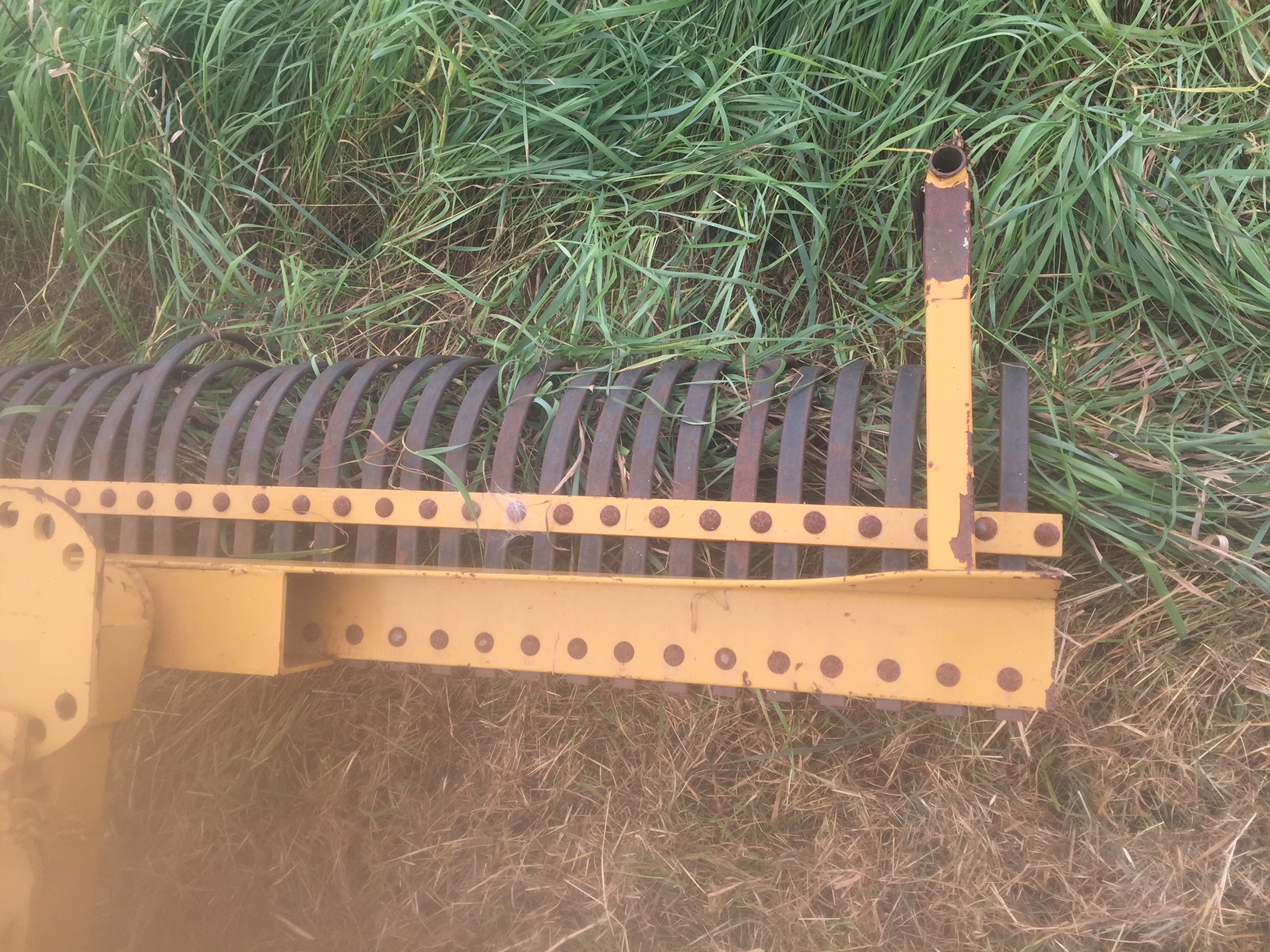

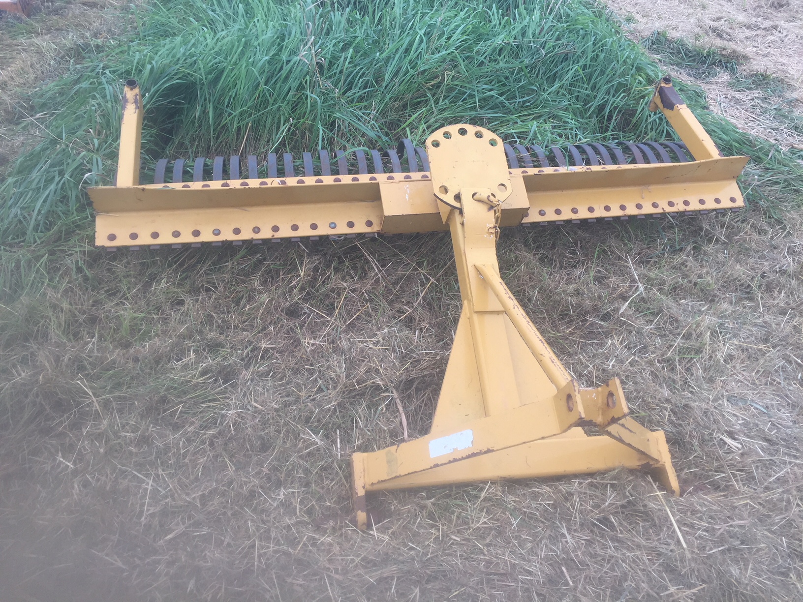

Please see the pictures below.

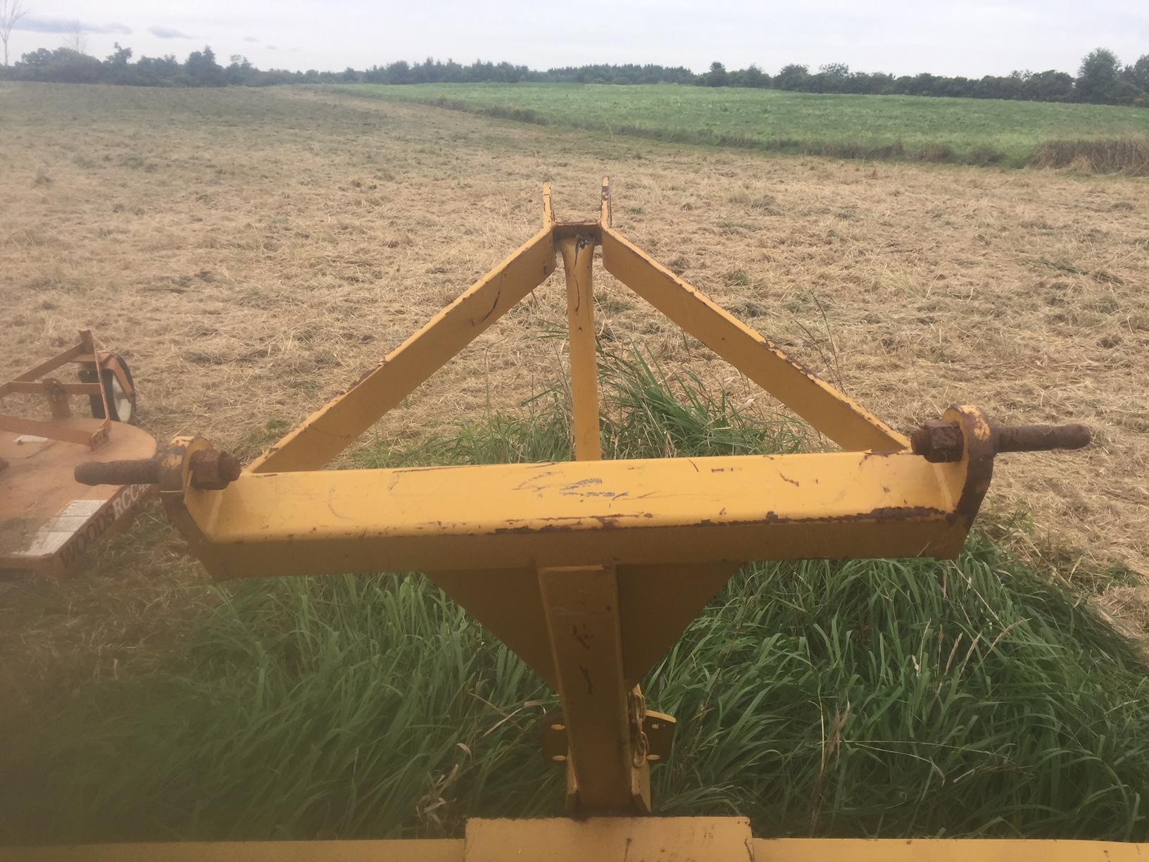

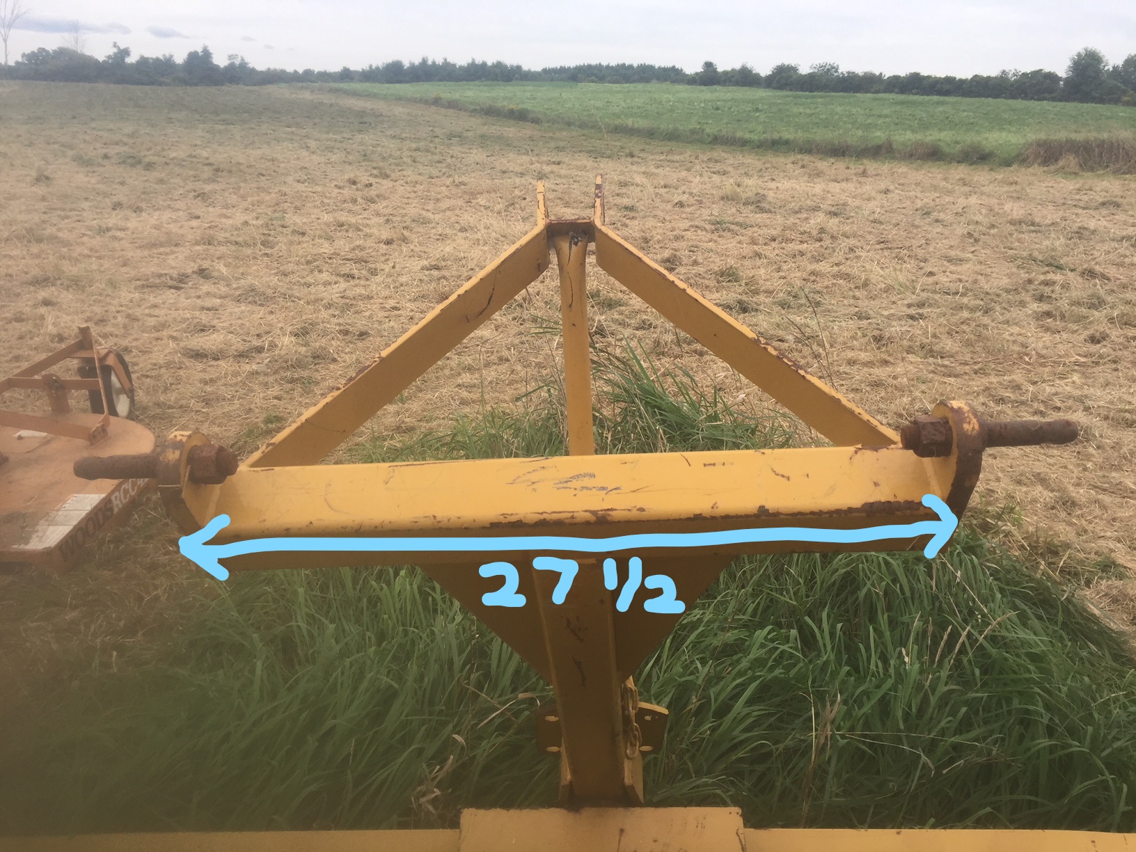

I acquired this with my BX22. Not sure of the make. It seems to be a Cat 1 attachment as per the pin size. My issue is that from outside of frame to outside of frame measures 27 1/2, my quick hitch is 27 1/4 inside to inside. Other Rakes I have measured seem to be approx. 26" which would fit fine.
Is this a Cat 1 implement ? Also any idea who the manufacture is ?
Thanks for the help,

Unbolt the existing rusted draw pins and replace with shiny new draw pins two increments shorter than the originals, so bullseyes will slip on easily. Orient the new pins inward, rather than outward; nuts on the outside, rather than the inside.
Monitor replacement hardware for tightness during the first 25 hours of use. If kept tight, fittings should remain tight.
You should be fine.

Ithought it was a country line or a tartar, but that wheel kit made me change my mind. I agree with Jeff, to fix your issues. I would also hit the rusted areas with a grinder or sander and spray bomb them, nothing fancy, just a quick hit. I would check with TSC to see if they have replacement tines, that one looks bent up in the pics to me.

I did some quick searches, looks like a york rake to me. The wheel kits on the tractor supply and rural king ones are bolt ons, this isn't that.

Also, the top pin hole has the bottom access blocked so a hook won't get to the pin.
