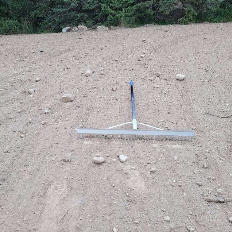

The soil is rather sandy, with gravel and larger rocks mixed in. No hard clay here.
Here is a photo of what it looks like after the bulldozer smoothed things out, and after I ran my tractor landscape rake over it (facing forwards and backwards). The tractor rake seemed to pull up a lot of rocks that were just lurking below the surface. The Hand Rake in the photo is included for scale. This photo was taken in an area with the highest density of rocks.
It would be awesome if I could use the Harley rake to windrow all the rocks off to the side. Think it will do that effectively?

I've never used one behind a tractor, but when we used to use one on a skid steer, it would do a great job of letting us separate and gather up rocks.

Absolutely. Set it light.
