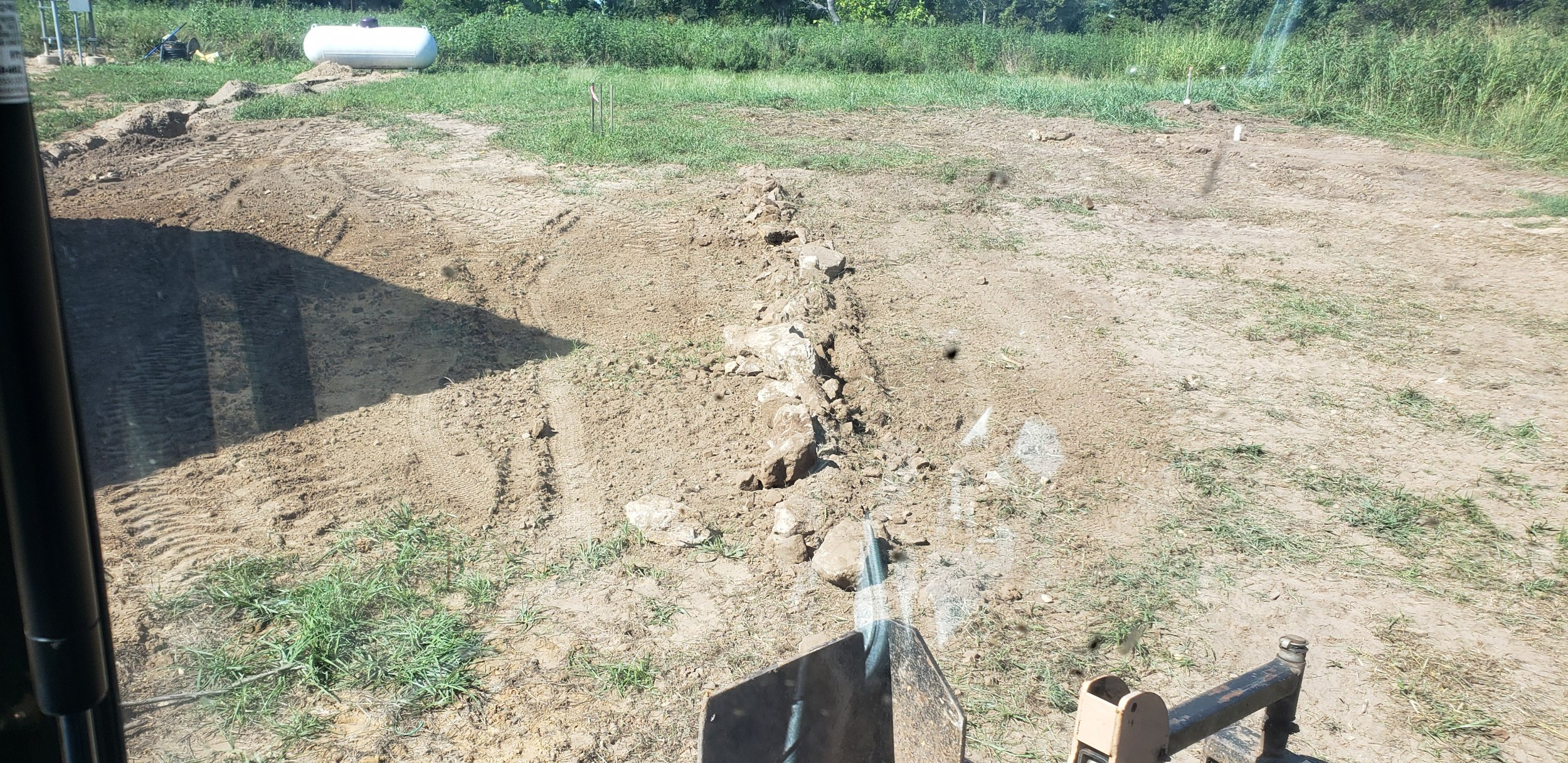

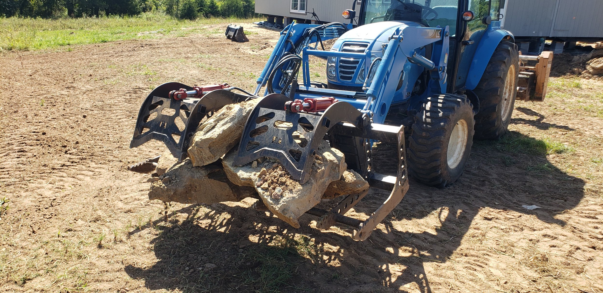

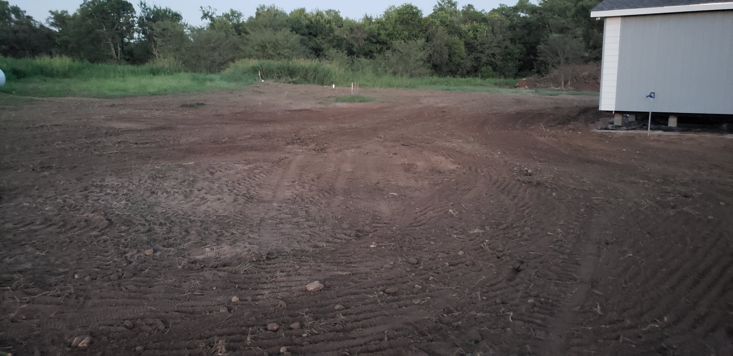

Here is a clean up job I did a couple days ago.
Hauled off the big rocks with the grapple.
Raked out and windrowed the rocks that were left.
Ran the rake over and smoothed everything out.
