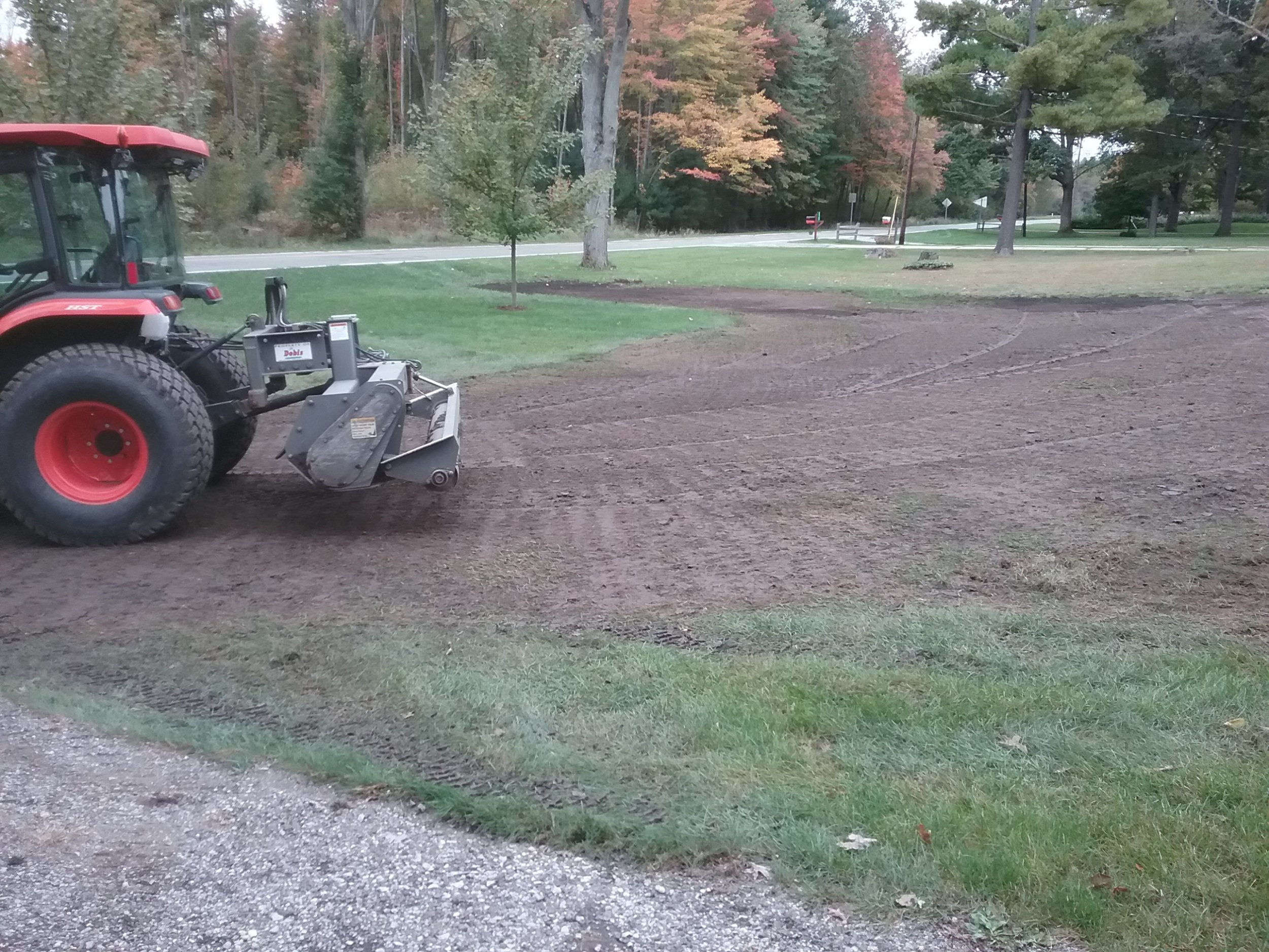

They quit making em a few years ago but if you could get your hands on an ATI 805 preseeder you'd find there is nothing that produces a smoother grade due to the hydraulically adjusted rear roller giving a much more accurate orientation than other 2 wheeled models. ive been using em for about 15 years along with ctl soil conditioners.

That looks like a very nice machine that delivers great results. I find it strange they got away from the roller. Probably a cost cutting initiative.

well, I cant be sure but I think they probably saturated their own market by selling the same implement for 37 years. basically every landscaper around my area has em and they only need to fix moving parts since the main structure is pretty bulletproof. The roller gives the best results for sure, but its not without problems. any amount of excess moisture causes mud to collect and that causes all kinds of headaches.
