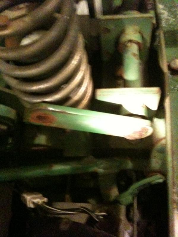

I need some help. I have a JD 650. It has been a great tractor. However the last time I was on it, I was driving and the 3 point shot up in the air.
Now my blade is either all the way or or down. And when it comes down it will only creep down taking minutes to get to the ground.
Everything seems to be working fine but there is something out of adjustment.
Please let me know if you know of anything I can do.

a quick thing that comes to mind that is easy to check is this draft linkage. Look on the left side lift arm and follow the rod forward. This gives feedback to the control valve.

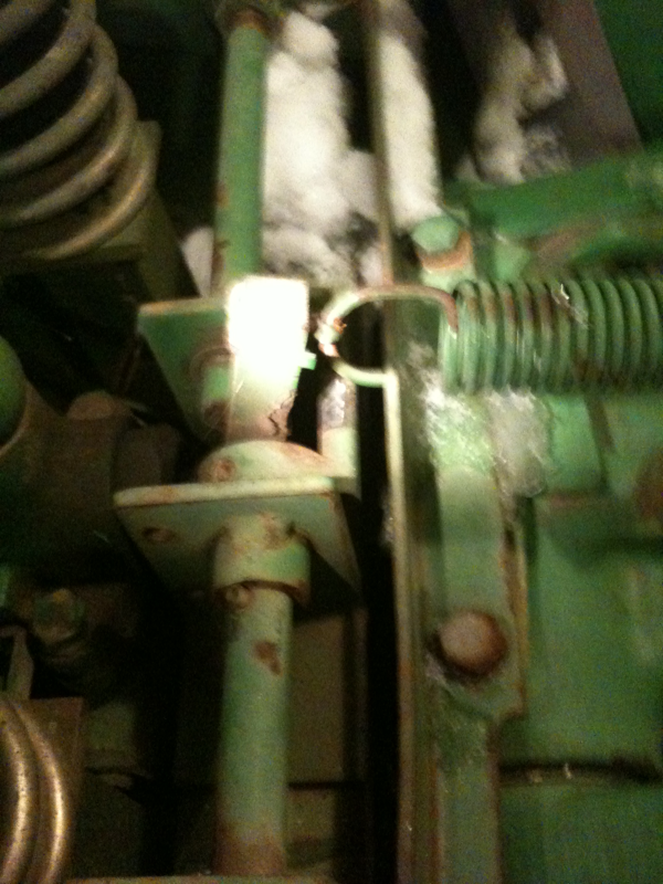

I did check the draft linkage and it does not look like anything has moved or come out of adjustment.
However on the far left there is a lever that appears to have come unbolted that does release pressure allowing the blade to come all the way down just like it is suppose to. But I can find anything that it would of attached to.
If I could even get a picture of the draft linkage under the seat on the left side I may be able to figure it out. And save me some money taking it to a repair shop.

Be sure to check condition of spring #55. Also make sure link#2 pivots freely on shaft #5.

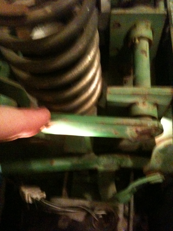

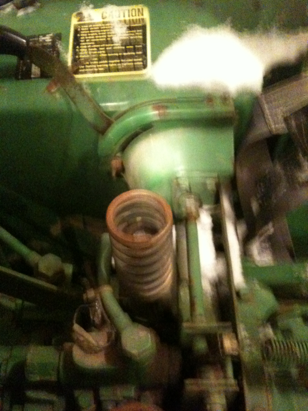

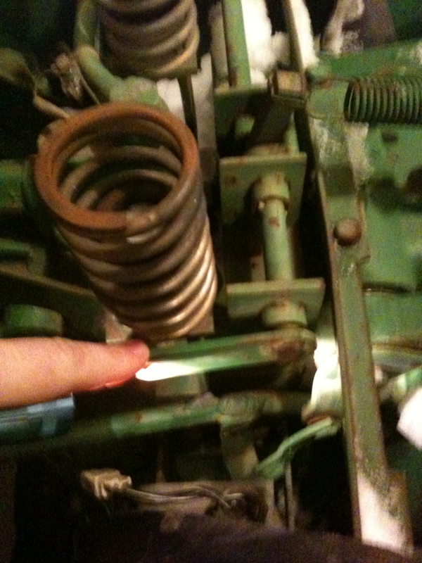

Hope these pics help.

/ 650 3 point problems
Spring is in good shape.
Am I pointing in my pics to what you call shaft 5 this does move freely.

It does. I now see something has come apart on the far left.
I may need some more help but first I will get more info for you.
