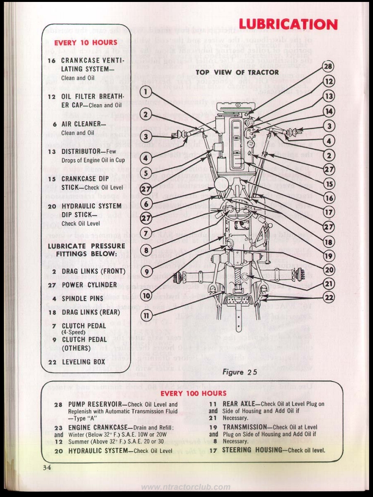

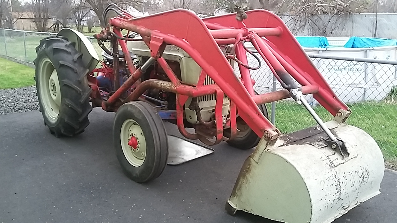

I just inherited a very nice '58 Ford 800 with the five speed and live PTO option. The tractor has a loader on it that works fine and everything seems to work well except the 3 point hitch. In close inspection of this tractor it appears there are three big plugs on top of the transmission, what I would call the "pump case" and then the differential. The middle unit has a fluid dip stick and with it all the way in it's just touching oil at the bottom. In looking closer at all this the transmission has a level plug on the side that you would fill with 90w gear oil to that level. The differential has the same level plug that you would fill to with 90W but that middle case has a dip stick. So here is my question. What kind of oil would go in this "middle case"? Also the dipstick has two levels on it. The lower one is marked "oil level" and the upper one is marked dipstick tube opening. I'm guessing that you would fill that case with oil and instead of the normal way of checking fluid levels with a dip stick you would "short stick" this case to the top of the dipstick tube opening????? Now I have ordered a shop manual and parts manual and owners manual and I'm sure all that will be covered in that material but for now I'm just asking for advice from others that may have an Ford 800.

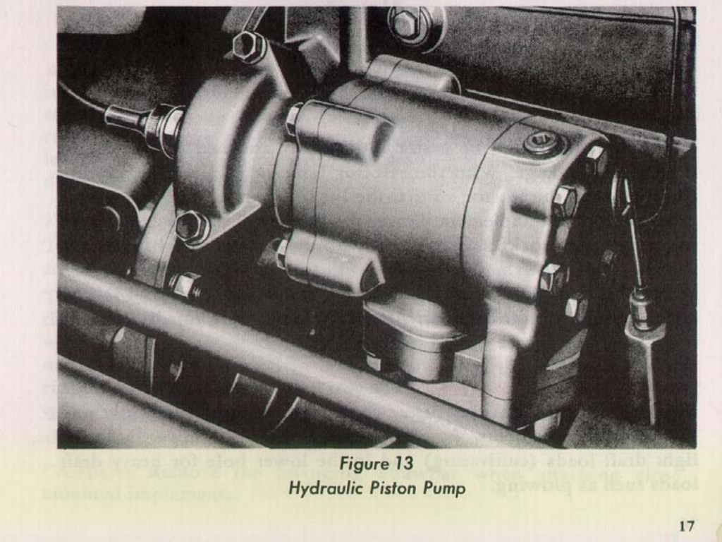

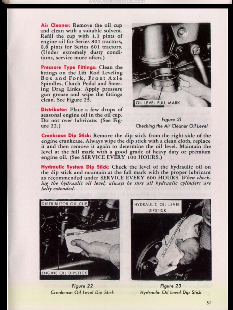

For the hydraulic fluid, New Holland 134D or equivalent is the modern recommended fluid. Some folks, myself included, use the same 134D fluid in the transmission, rear differential, and hydraulic reservoir since the seals between the chambers may not seal as well as when new and the fluid may intermix between them. Attached are a few pages from the owners manual to tide you over until you receive the ones you ordered. Also note the picture of the hydraulic pump which is on the right rear of the engine. The hex plug at the front of the pump can be used to bleed air from the hydraulic system which may be why the three point is not working. Check the oil level on the hydraulic dipstick on the left side of the tractor behind the left running board and add oil to hyd reservoir at cap #10 if needed. Pull the coil wire, loosen the hex plug on hydraulic pump, and crank the engine over until oil without air bubbles is flowing out. Tighten the hex plug and recheck the oil level. Your front loader is a Wagner model WF3 and it has its own oil stored in the frame of the loader and is powered from a pump that runs off the front of the engine.

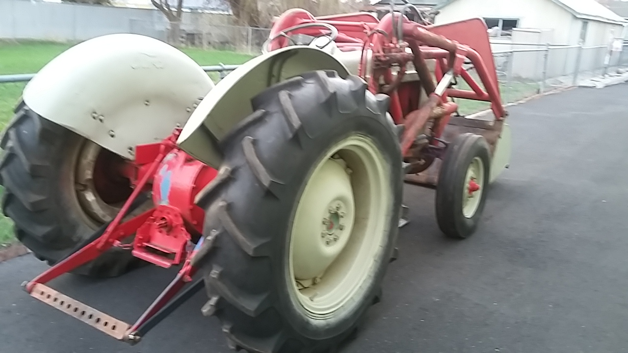

Glad you got the three point working, bummer that you have to drain and refill. Just curious, how did you determine that your Ford is a 1958? Based on your pictures, your tractor appears to have been built between 1955 and 1957. There is a flat horizontal area above and behind the starter that will have two rows of numbers stamped in. One will be a 3 digit number and will either be 850 or 860 based on what I'm seeing. The second number will be a 5 or 6 digit number and is the serial number that can be used to determine the year. Might be fun to see the numbers with layers of paint and the loader in the way. Here is a link to Yesterdays Tractors and serial numbers for Ford tractors.Antique Tractor Serial Numbers - Yesterday's Tractors

Well Michford you have a very decerning eye! The old gentleman that gave me the tractor said it was a '58 but just yesterday I took a flap disk and polished off that number area. I did find 860 which I assumed to mean it was a '58 model built in '57 with the last digit being a zero. But looking at my material again and with your question it's making me look at this differently. So the honest answer right now is I don't know what year it is.
But looking at the link you sent me if it had a serial number starting with a 1 it would be a '54. But then in '55 the numbering started with an 10 and was five digits long. Then in 1956 the numbering started with 77 and again five digits long. But in '58 the numbering started with an 11 and had SIX digits. I went through all that to say that the serial number is illegible. But I can see the little special mark at the front and the rear of the serial number but the first four numbers are obliterated but the last two are 22. But if I go out there today I believe I can estimate the number of positions and it looks kind of long enough it could be a '1957. So I think you nailed it and more then likely it's a 1957 and NOT a 1958 as I was lead to believe. So thank you for that education and I'm learning more about my big tractor every day.
