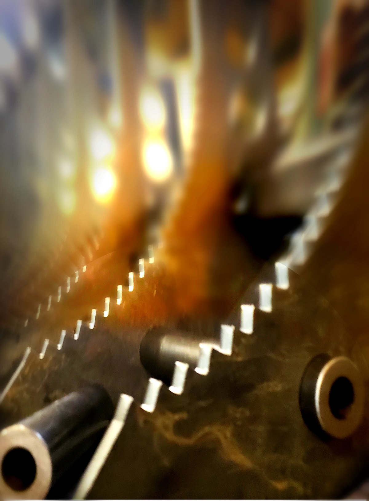

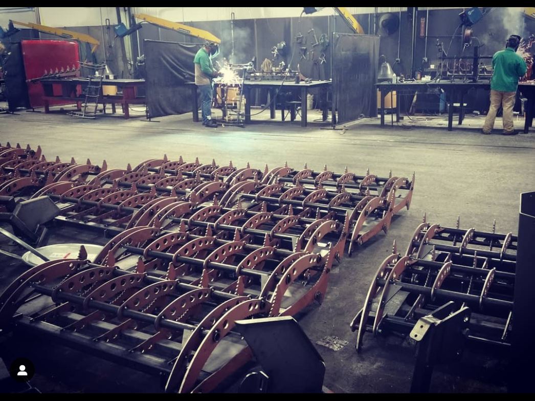

At EA, we're into designing and producing the best and I am able to recommend the most IDEAL grapple for subcompact tractors up to 100+ horsepower tractors. Not just one that'll fit and work ok; I'm talking the absolute best grapple you can possibly mount to your tractor. When you choose ideal, performance and results will be optimal and very impressive.
Wicked Premium materials can't be touched..

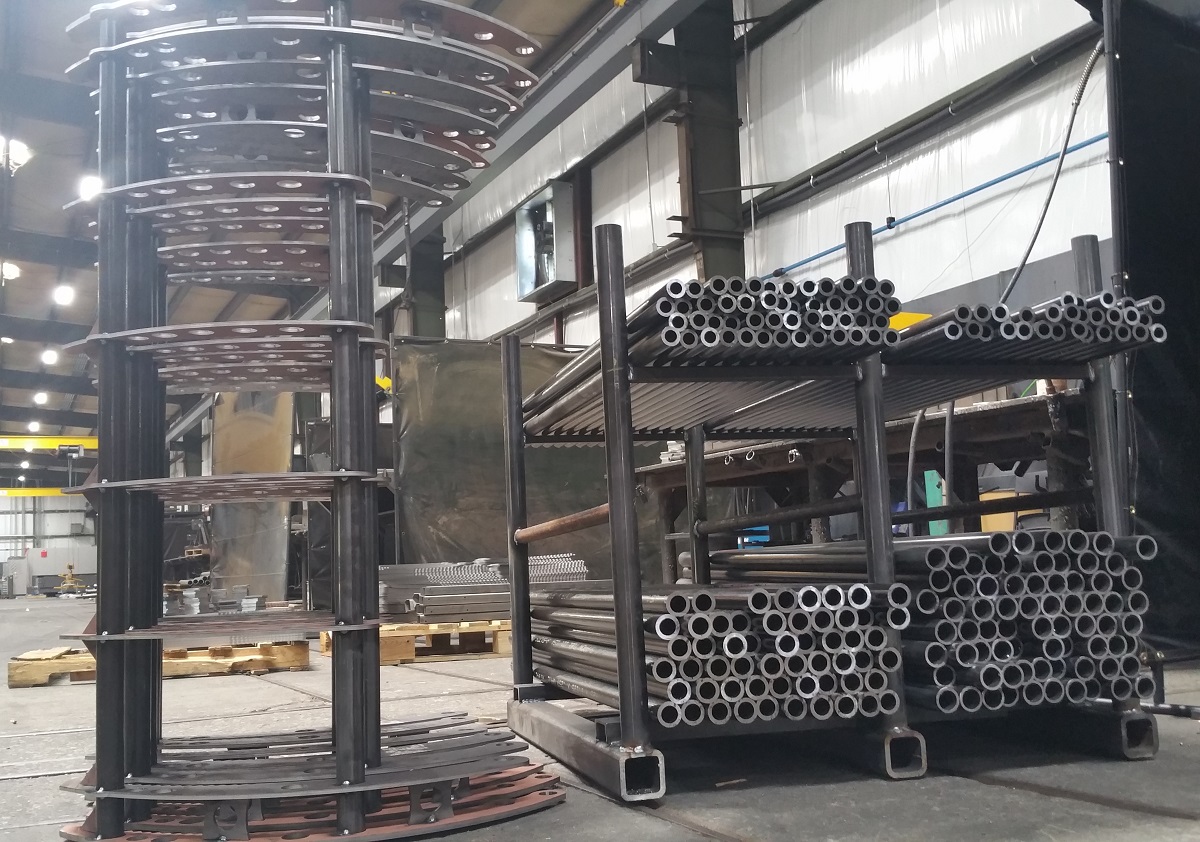

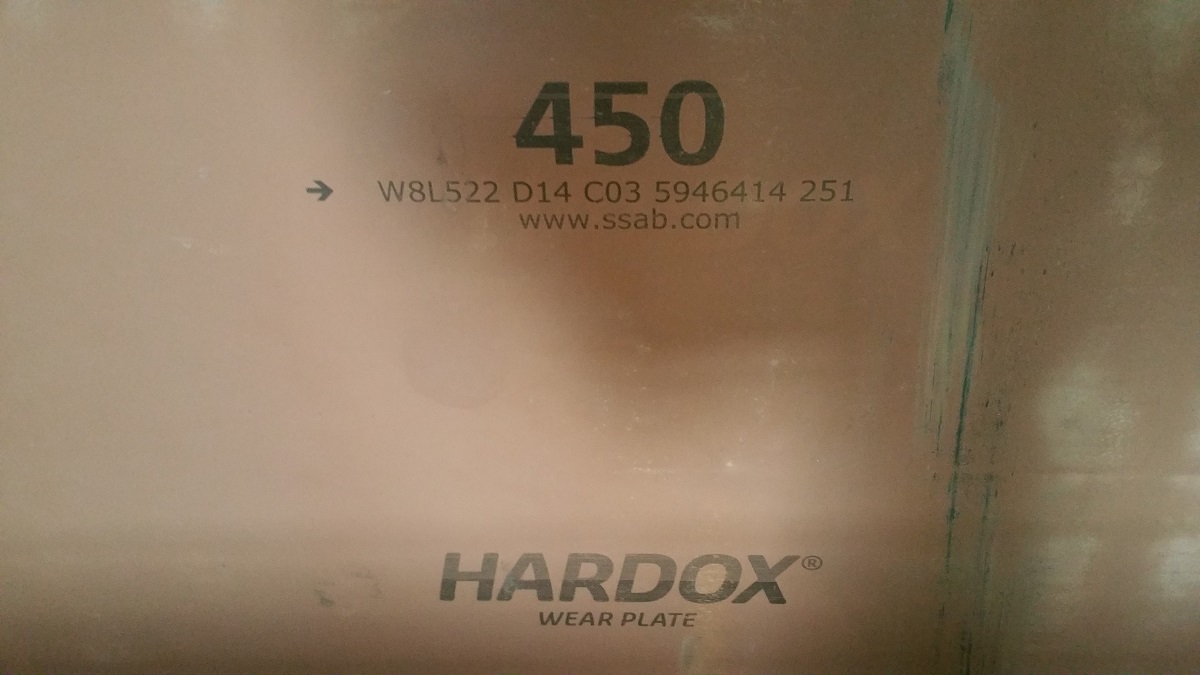

Plate Steel used:
Hardox 450 has a yield strength of around 175,000 lbs minimum yield. That is 75% stronger than 100K steel, and 250% stronger than 50K steel. The strength of AR450 steel can improve weight savings over 50K much like 100K material because a thinner material can be used without sacrificing strength.
Round Tubing..
DOM, or Drawn Over Mandrel, tubing is made from a cold-drawn electrical resistance welded tube that is drawn through a die and over a mandrel to create dimensional accuracy, dependable weld integrity and an excellent surface finish(which we manually scuff so the paint will hang on). DOM has high tensile and yield strength, so It is generally chosen over welded tube where high pressure or large workloads are needed such as the manufacturing of race cars and motorcycle frames.

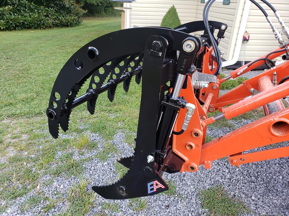

Materials are nothing without design. Wicked materials are spot on and the design is right there with it.
The dozer-like tine geometry of the rake style promotes a tractor's ability to push the serrated, laser cut tines through the ground with ease and the design keeps the load as close to your loader pivot pins as possible to MAXIMIZE lift capacity like none other.
The root rake style allows you to pull brush, vines and other debris backwards, which isn't recommended with many long bottom grapples. Besides pulling backwards, you can also pull down. Reach up and snap a limb off the tree if you feel like it.
The root rake style will easier "unload", so you can hover over the trailer, dumpster, pile, etc., open it up and whatever you've captured is gone!
Our design keeps the load closer to your pivot pins than any other.
The most photographed grapples EVER!!

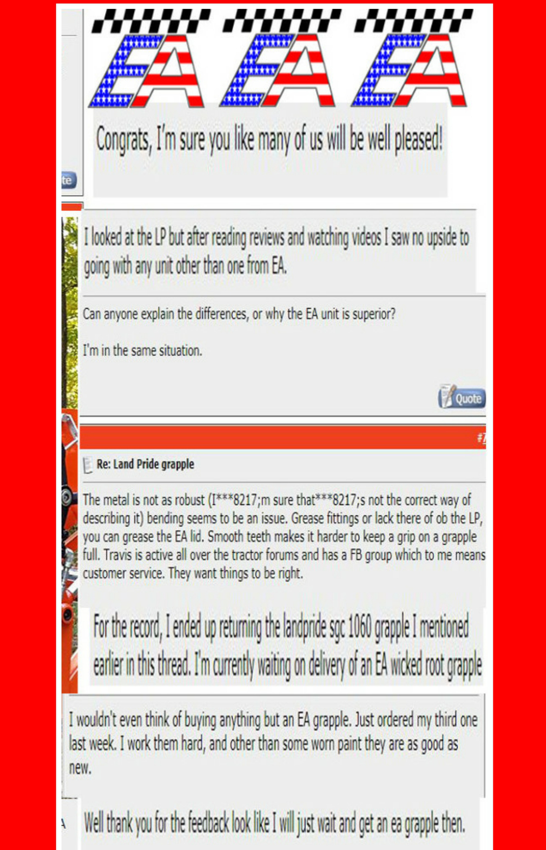

Only experience with the EA 55" Wicked grapple. I don't think I've ever seen a negative comment on the quality.
It's lighter than others so it doesn't affect the lifting capacity as much. And it's basically bomb proof. I have lifted and twisted things and sure I was bending a tine, but no it's still strait. Great workmanship and the paint stays on surprisingly well with all the abuse it receives. I only ever take it off if I need the bucket to move material.

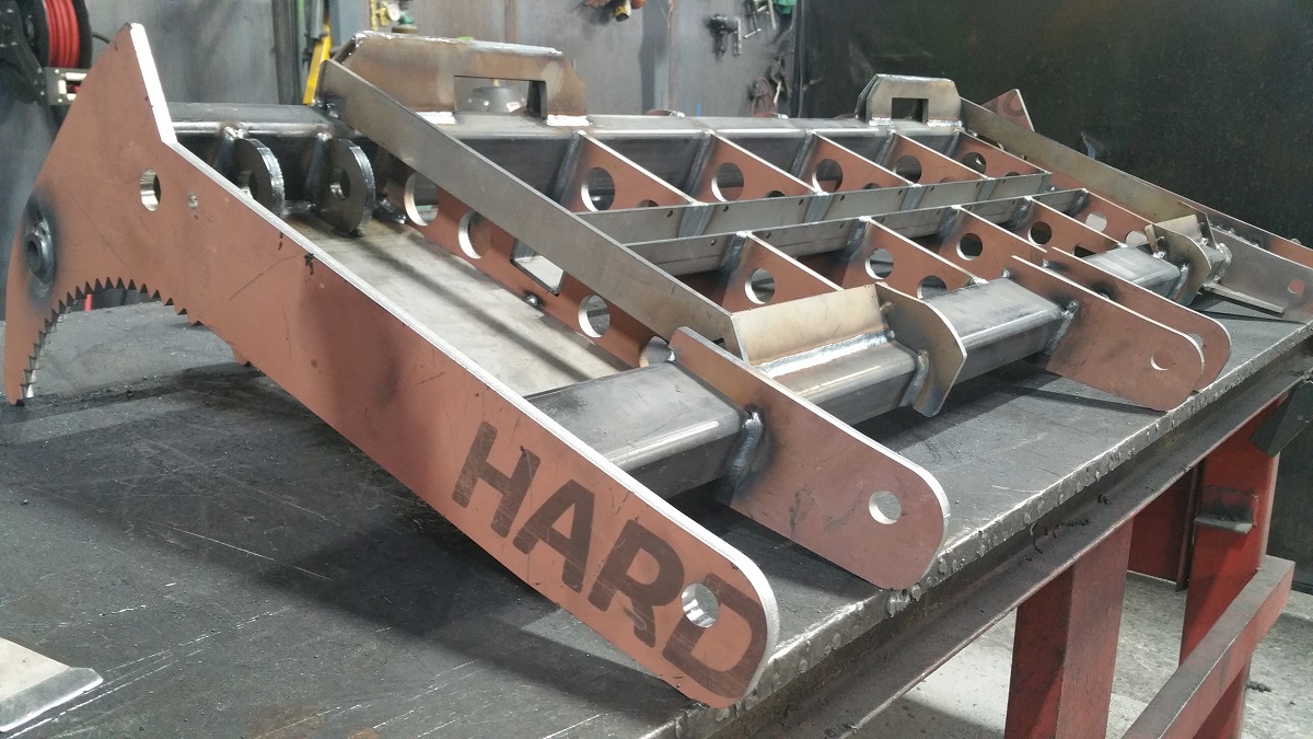

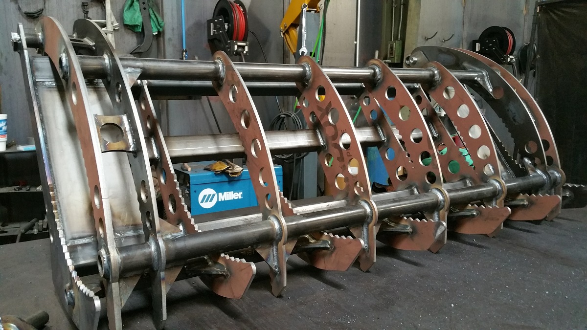

From an engineering standpoint, I prefer the one-piece tines that curve up from the bottom to the top of the grapple, like EA has. Spreads the stresses more evenly than having a sharp angle in the back of the lower tines. Having said that, it does looks like MTL did add some gussets and reinforcement in that area to help with this. Not a terrible design overall, but it does weigh nearly twice what a 55" Wicked Root Rake Grapple does; meaning your tractor will lift a little less with the heavier attachment. I'm assuming that's the EA grapple you were referring to anyway, since you mentioned 55" width. The EA Root Grapples with single/double lids and longer lower tines come in a 54" width. The AR450 steel in the EA grapples isn't a bad thing either. The stuff is tougher than a woodpecker's lips. You didn't really specify what you were going to be doing with the grapple, so I'm just spit-balling here. If price was not your prime consideration though, I'd get the EA and never look back. Lots of positive testimony to back it up. One of the reasons I bought the EA grapple myself.......
Thanks for the business, sir, and thanks for the great info. Concerning the tine reinforcement.. All current Wicked Grapple rakes feature gusseting for upper and lower tine support. The gussets are angled and sized properly, so ground penetration and ripping ability isn't compromised. If yours doesn't have them, I'll be glad to send out a set for ya!
Travis

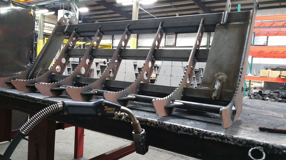

This one is on the table, partially welded..

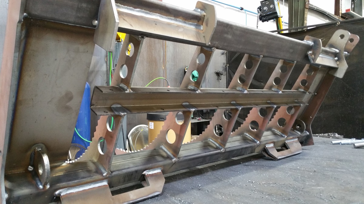

Ready for paint..
Ready to EAT..
