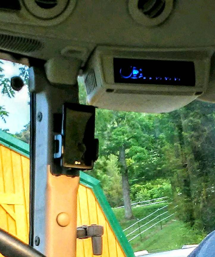

Thanks for the info and links in this post. Got a much -used 5093e Limited and followed your discussion. Now enjoy. Pioneer MVH-X381BT. SIDE NOTE; previous home owner left Bose Accustimaster speakers hanging on wall. They're back in service in the tractor. Thanks!0629172049c.jpg

Inger
So what is in the pic that you attached? just curious..
/ 5093E radio installation #13
This is the JD PLUG That receives the VW/AUDI harness described above. To my my surprise I found power, antenna, ground and 2 speakers factory pre-wired. Easy DIY with info provided by previous posters. Thanks.
