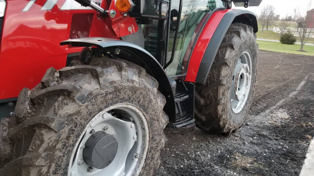

I have them on mine. They are the swivel type. I had them worked into the deal. When the dealer found out what they cost ($1300) , he tried to weezle out if it. In the end, he kept his word. They are very heavy duty. I like them20181203_161430.jpeg
I was quoted 1700 installed. I passed. Not that much mud here and no road work at speed.
They are not that much. Take about 2 hrs to install. Parts are about $1100
my dealer said parts with shipping were much more than that. You got a very good deal.
