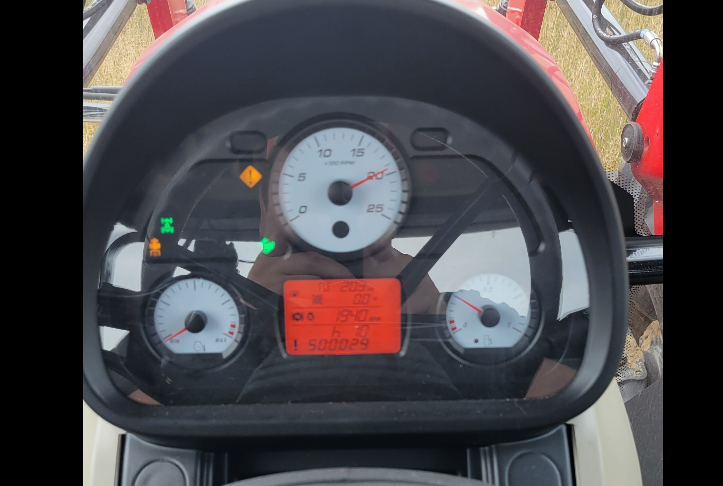

What temps are you guys seeing and what should I be expecting? I was running it what I would consider pretty hard tearing up virgin ground with a 4 bottom and I think I was hitting like 160F
I got my 10ft rotary cutter going with some help from the guys on the 4700 Series facebook group. Temp on the dash was showing 165-180, not sure what that is measuring.
It doesnt take long to heat up to one bar or so from the red running about 3mph in fairly dense CRP. Mow for 5 minutes... cool down for 5 minutes. Cooling package clean, outside temps in the 70s.

Rev’d it up some more, kicked it on, tractor made a bunch of racket under the cab, threw a code, and kicked the pto off.
I've had this happen a few times when using my brush cutter. In the moment I was just too eager to get started that I didn't bother to look it up. Does anyone know what this code means and if I'm doing it wrong?
for reference I was rev'ing up the engine to 1900 or so and engaging the PTO, it happens more frequently if it's the first time I'm engaging the pto for the day.

My coolant Temps never get over the last hash mark to the left of half way on the dash gauge.
The temp displayed on the LCD middle screen is trans oil temp. Mine heats up slowly and on a hot 100 plus degree day levels off around 165 to 170 degrees while running the bush hog.
