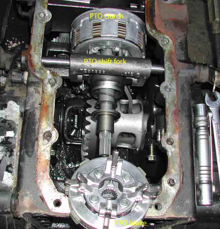

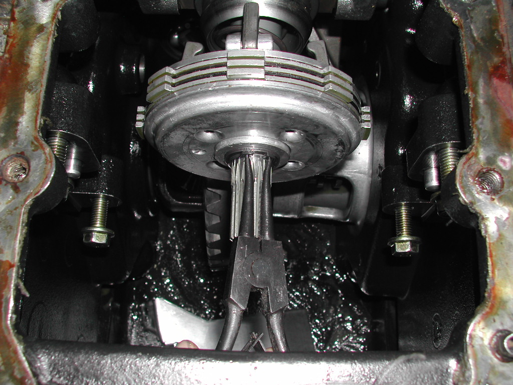

You can access the PTO brake thru the rear cover, and you may be
able to see the problem from there. You take off the PTO gears
and the rear bulkhead. If you have to remove the clutch, that
requires taking the 3-pt cyl housing off. When you remove the rear
cover, you may find your broken parts in the bottom of the gearcase.
In this photo, you can see me removing the brake basket from the
rear (snap ring pliers reqd). At the top you can see some of the
fingers or pawls that may be your problem. They can hang up or
brake off.
BEENTHERE's manual photos should help, too.

OK, thanks for the manual photos beenthere. very helpful. I was going to pull the rock shaft housing off the top, as you did in your rebuild dfkrug, but I may just remove it from the back per the manual, that looks pretty simple. I can tell the fork is hitting something solid inside, I know that much. I'll get her apart and see what i find.

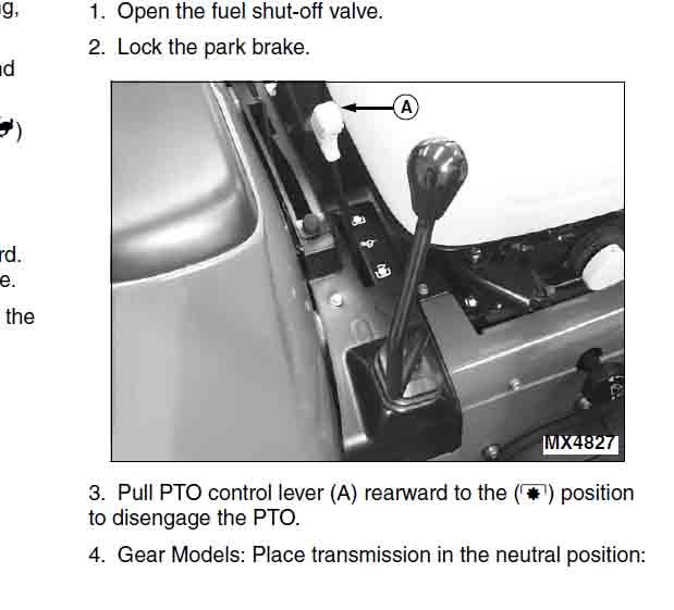

I went back to the owner's manual when you guys reported having a PTO
lever neutral positon. There is no reference to a Neutral anywhere for
either Gear or HST tractors. All mention of engagement/disengagement
of the rear PTO told of an Off position and an On position only. In one
place, the OM talked of pushing in the foot clutch on a Gear model before
moving the PTO lever to On. Then there is this photo in the manual, which
shows the PTO lever in a middle position, which is marked with some
unreadable graphic. My tractor's plastics are all new, so I don't have this
graphic. Does anyone else?

   / 4300 PTO won't disengage. #19
i have a 2001 4300. in my manual, it does not say anything about a neutral. it does have the 3 graphics as your picture shows. one is obviously engaged, the other off, the middle one is a picture of a tractor w/ an arrow in the middle. i have to go check for sure, i can't remember exactly what it is. i can get a pic this wkend that shows it better.
i did ask about this on this forum and it was said that it is a neutral so you can spin it by hand w/ the engine off to align implements easier. granted, beenthere said it in both threads. :laughing:
http://www.tractorbynet.com/forums/...ng/166556-power-take-off-lever-positions.html
   / 4300 PTO won't disengage. #20
I found the graphic. It is as you said: a tractor pictograph. The arrow
is pointing at the rear of the tractor. Just a complicated way to say, "rear
PTO".
The PTO brake basket on my 4300 is designed to freely rotate maybe 120
degrees while the PTO is Off (braked) so you can turn the PTO shaft by
hand to get the driveshaft to go on. It is not a neutral.
