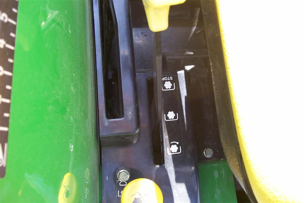

   / 4300 PTO won't disengage. #26
Took a pic of my 4300, to show the distinct three positions as indicated by the hyeroglyphics.

   / 4300 PTO won't disengage. #27
mine has a different picture in the center. same one that dfkrug had in the pic he found. i will get a pic of it as soon as i remember to take the camera out there! yours seems to depict a neutral better than mine tho. i have a power reverser tranny, which do you have? if i recall, dfkrug has a hydro.
in the meantime....i did a small test. engine off: pto lever in braked/off....shaft turns maybe 90 degrees by hand. pto lever to engaged, can't turn at all. pto lever to center, shaft turns freely. i hooked one half of my mower pto shaft on to use as a crank.

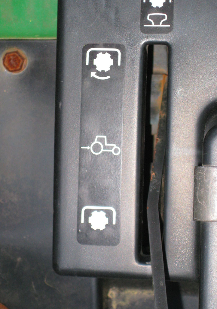

I just went out and tried mine. 4200 HST. I bought that sticker in 2008 so I don't remember what was there before.
On, Off, and an obvious detent in the middle for free-spinning. And I mean obvious. The lever stops a little before the middle and you have to apply a little extra force to get it to go to on. On the way back to off the same thing happens.
