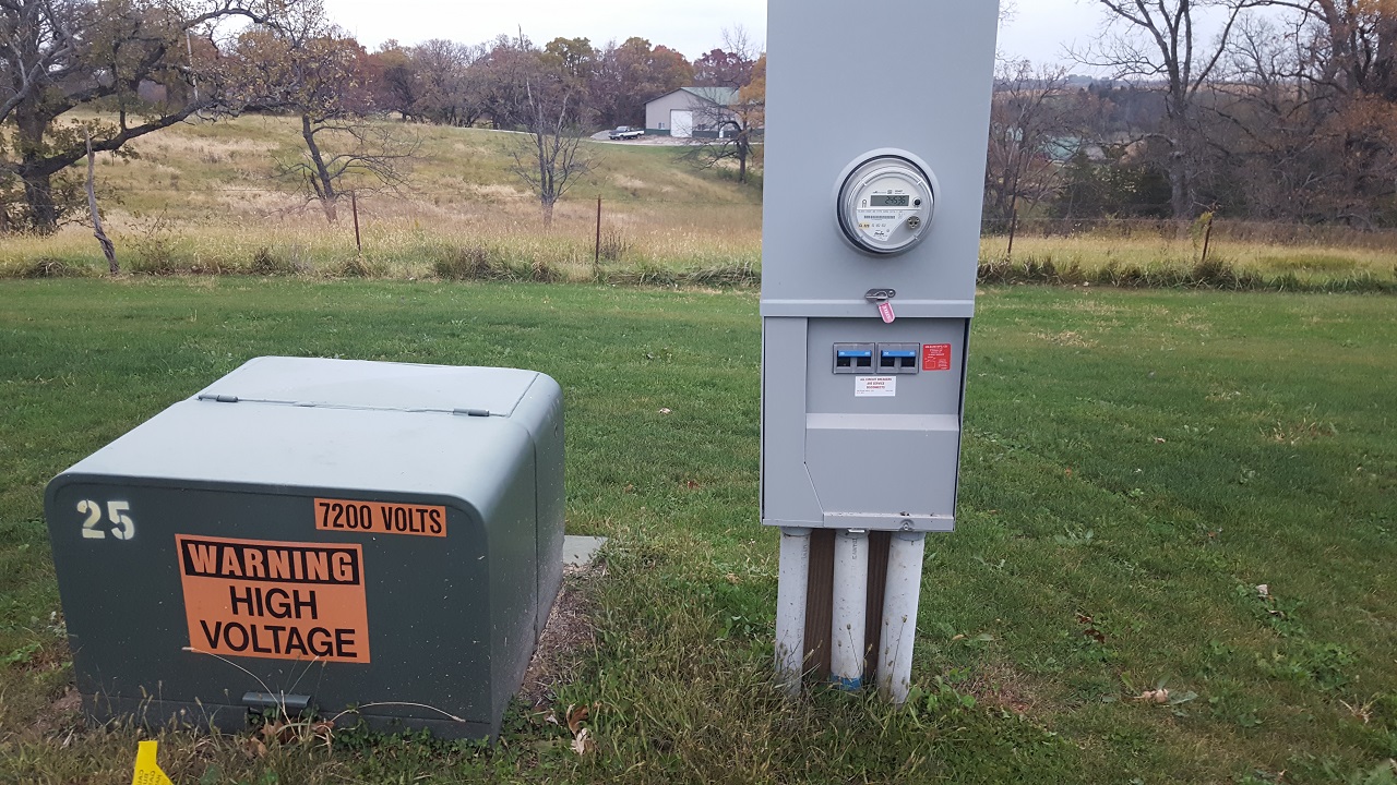

It seems rather arbitrary that the inspector wants you to run to the house first, then back to where you started.
My setup is similar to what I think you are trying to do. High voltage line buried from the road up the hill to the shop. Pad transformer there. Short run to 400A meter on the shop, then power runs to the house. I was going to feed directly from the meter to the house but they required a disconnect on the outside of the shop for the house run for some reason. It isn't in the NEC but it is in the Wisc code, so that was that. Silly waste of a disconnect IMO, but at least they didn't make me do something dumb like double it back like they want you to do. Ask him if you can just put a disconnect on the shop and the side of the house and then only make one run. There has to be a better solution than what he said. I used something called a "Farm panel" (around here) on the shop to feed the house. Just an outdoor panel with a couple breakers that was relatively inexpensive compared to some other options.

My 400 amp service runs from a power junction at my gate approximately 150’ to the transformer and then another 75’ to a dual lug meter base set on side of shop building. 200amps to shop and 200amps to house site.
This was per NEC and Washington Residential Electrical code ( which is mostly the same as NEC)

WHO is determining where the pad will go? Can it be placed closer to the house?
I get to determine where the pad and transformer goes. And no.... wifey won't allow it any closer to the house. Behind the shop is perfect, I just need to get the inspector on board.
EXACTLY WHAT I WANT TO DO.... I can't find anything in the NEC that says the meter and disconnect must be on the house. Man... I hate to question this guy's opinion right out of the gate.
Yes... looked at those panels. I would rather go the dual disconnects and two panel route.

Maybe you could push him on the extra voltage drop and need to upsize conductors for the round trip that you wouldn't (Shouldn't) need to do if you ran direct? Check state codes to see if there is anything in there as that is what got me. A call to the state electrical inspector office might help you with some ammunition to argue with. There are times to just go along with the inspectors unreasonable demands and times to fight it. Obviously you make your call, but this is one that would push me to fight as it is not just silly but an actual BAD idea. 2x the run for no reason, and then the shop with all the big motor loads is at the end of that? no thanks.
