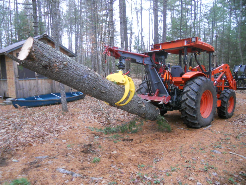

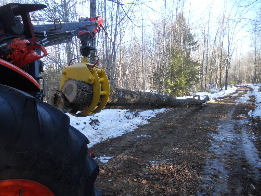

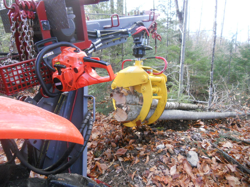

I don't have any videos but a winch is a winch, the grapple is the fun part. I have 711 ac. of woods with a couple of miles of various degree (condition) of roads. I don't like to drag on the better roads unless it's frozen. The grapple and the way the winch is built allow me to have the butt end in the air 'bout 4-6' depending on if it's in grapple or on the chokers, saving my roads. Depending on the log, I can haul it off the ground completely. Big one's need to be shorter, but smaller one's can be 30' long. That big pine log needed to come down, it was hit by lightning and I didn't want the wood to go to waste, but all of my regular cutting is just thinning for firewood. No big "sticks" like Rob hauls. DSCN7667.JPGDSCN7795.JPG

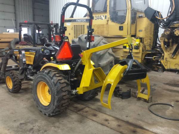

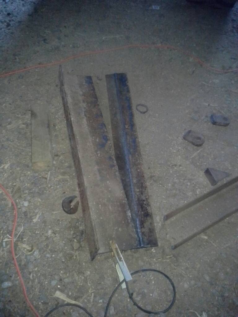

As I hope to add a winch to this in the future, it will be built with that in mind, not just as a grapple. Started off with a 42" length of 8" wide flange I beam and cut one flange off to make the blade/anchor
5" heavy channel I had laying around to make the 36" 'verticals' and a piece of 3.5 x 5" angle iron salvaged from an old brick lintel to cap the top. Width of the 'verticals' at the base plate is 32" and 12" at the top. This is laying face down on my bench to check alignment of everything and keep it flat. I still have to notch the top of the channel to allow flush mount of the angle top piece. That 12" top should allow me to bolt on a hyd winch up there similar to how Rusty did his if I ever find one suitable. Pins are being set 16" above the bottom which should allow for 8" below grade for winching anchor and still get 12" of clearance fully raised without factoring in adjusting the hyd top link. I'll get this all tacked together and mount it to double check everything before I fully burn in the welds.

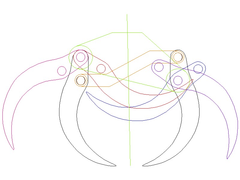

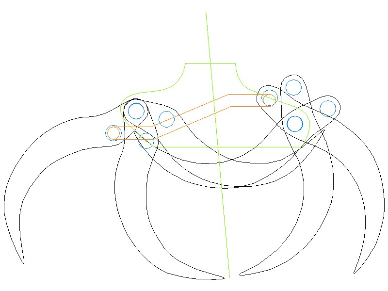

I've got 2 drawings now for the grapple.
The first one with the "Bruce method" mentioned back in post #12
For the second, I started with the first and then adjusted it based on measurements and photos that Rusty emailed me:
They are fairly similar but with some notable differences. Vertical height is within an inch of each other and the opening is similar with at 39.5 and 43.5
With the "Bruce grapple", I much prefer how the grapple closes in on itself in a more compact package and the remaining opening (when fully closed) is more centered under the mounting point. The downside to the "Bruce grapple" is that it only uses about 7" of the available 8" stroke cyl. The 2 sides are different from each other with about 5/8" difference in the pin centers
With the "Rusty grapple", both sides of the grapple are identical and the motion of the linkages perfectly suits an 8" hyd cyl. The downside is I don't care for how it closes (at least in my drawing) and isn't nearly as compact when fully closed. This one should have more clamping force available as the cyl & cross link mount are further from the pivot pins

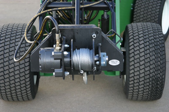

For those prices I think I'd reverse engineer the power-trac hydraulic winch setup. I don't know that there be way to make it free spool though.

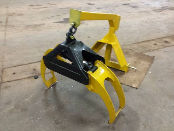

Maybe not useful to your post, but they are selling these for $2,100 on Craigslist in WI.
