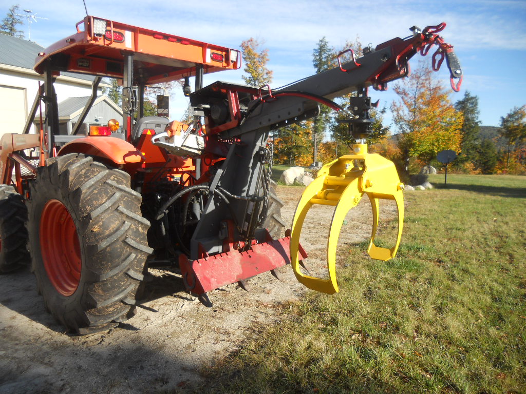

It's as fast as I need it to be, iirc it was around 60fpm at rated load, first wrap on drum. That's a foot a second and in my woods with all the stumps and rocks, plenty. I put it on today and noticed that I just let it work at idle speed (tractor throttle). I took some measurements and pics. I'll pm them to you. If your mostly cleaning up fence rows, I'd say skip the winch, but in the woods, esp "thinning" I find it invaluable. Maybe you could design it to take a winch later. That's pretty much what I did except the winch was first, but built to be able to add the grapple later on.
With the grapple, I'd highly recommend a hyd. toplink.
Finally got a chance to look at Ramsey's site. All their 8000s are rated at 50 ft/min first layer which goes up to 84 on the top layer. Not too shabby, I could be quite happy with those numbers except for 1 thing. Those ratings are at 15 GPM & 2500 PSI, I only have 6 GPM and 2200 PSI. So with only 40% of the rated flow available, I'm guessing it's a linear equation and I'd be looking at 40% of the 50-84 which would net 20-33 which is kinda slow. Not that I'm doing any of this in a rush but 5 min to drag a log out might get frustrating. It would be nice if I could find a similarly rated 6000 lb that was designed to run on lower flow. I see that Warn has one that is in that range 22-37 ft/min @ 10 GPM. Certainly at this time, Warn and Ramsey are both way out of my price range. Winch will definitely be further down the road, just needs to be accounted for in the design which I think is far easier to do with a hyd than PTO
Went shopping for the hydraulic components today. Got two 2x8 cylinders, hoses and a few fittings. $360 tax incl. One cyl is for the grapple, the other is for the long overdue hyd top link. I think all I need now is a chunk of steel to make the blade/anchor and some plate to make the grapple tongs which I'm stopping at the scrap yard tomorrow morning to look for.

Stopped at the scrap yard this morning. Got the rest of the steel to finish the frame and grapple, 175 lbs and $70 later I was on my way home. I believe I now have everything I need to build once I figure out the grapple layout. Took a quick walk around the yard while I was there (he's got literally 100 acres of junk). Lots of things to catch the eye and add to the potential project list. He's got at least a dozen PTO winches that I saw, not counting anything crane-sized or ones under the little bit of snow we have left. There was only one that I actually liked but it was still on an intact 1 ton tow truck. The next smallest he wanted $300 for but it's too big for what I want. If I could get him to part with the one on the tow truck, I think I could make it work. I also saw 3 hyd winches, one on the deck of a tilt bed tow truck and a pair of Ramsey on another 3 ton tow truck. While physically they would be easy to make work, I'm guessing that since they were worm drive, they would be the SLLLOOOOWWW ones especially as I'm sure the tow truck would have way more than my 6 GPM.

With some more searching, I found a hydraulic winch that fits my wishes....sort of . SCH 4900 - Planetary Hoists 4900 lbs of pull @ 52 ft/min from 8 GPM @ 1600 psi. Pretty much perfect for what I'm after. The downside (besides likely being stupid expensive) ... it's actually a crane hoist and has no freewheel option, only power in and out from what I can read. Ramsey also has a 2900 and 3600 with similar numbers. Ignoring the cost problem is there any way I can hydraulically add a freewheel option? Cross-over valve in the supply lines?
Read back thru the thread and somehow had missed Bruce's post #12. I never knew you could filter image searches like that. Thanks, that was a good suggestion. Found something I liked but couldn't open any images in my CAD program so I went old school and traced it with pencil and paper taped over my monitor and then traced that in my CAD program looking thru the paper. Scaled it up to match my 8" stroke cyl and I'm hoping it works. I've got a buddy with a decent size printer at work and I'm going to get him to print out the pieces full size that I can cut them from plywood and test. If it works, those same pieces will be my cut templates for the plasma cutter.

Part one of the winch dilemma solved. I just got off the horn with Ramsey and they confirmed the 8 GPM requirement of the SCH 4900 (on their website it says 8 in one spot and 13 in a different). They also confirmed that freespool can be added with a couple parts from one of the 8000 series. Sounds super simple to do and they even gave me the part number (276052). Loosen one set screw and remove another then pull one piece out with a magnet. Screw in the new plunger, check for 7/16" clearance at one spot and tighten the first set screw back up. With this info, I have found me a winch and I can make allowances within the design of the frame much easier than with a PTO winch :cool2:
