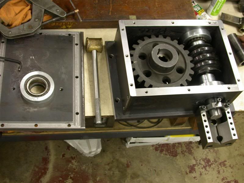

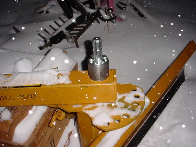

I got the Gear Box suspended in the air on my chain hoist and painted it. Then centered the Blade PTO coupler shaft under the gear box then proceeded to lower it into place with the chain fall:
When I got close to the shaft all I had to do was rotate the blade by hand a little to get the splines lined up, then lower the gear box a little at a time:
Larry
/ 360* Rotating Back Blade Project
#129
I continued to lower the gear box so that the PTO coupler was engaged and not binding :
Guess what ? All the holes lined up :cool: How could this be? This is going much too smoothly :confused: I bolted the Gear Box to the bracket I made with two 3/8" SHCS that Rob provided to me in the care package. I doubt those two little screws will hold all the rotational torque. SO Now it's time to add a plate on top of my bracket and push it up against the bottom plate of the gear box to prevent those two little 3/8 screws from shearing off:

After welding and cooled off, I painted all the brackets:
Here's another bottom view showing the coupler completely engaged:
