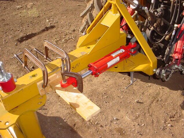

Is there a chance that cutting the pin and replacing the extended section with a piece of non magnetic stainless would allow it to work? Or instead of using the pin to drop in the hole, use a fulcrum like a see-saw that kids play on and have it drop the pin in the hole. The cross bar could be non magnetic, and would keep it separate from the blade positioning holes.
David from jax
David,
Yes thats a good idea and would have worked. I decided to scrap the solenoid idea and go with a lifting wedge (Cam) driven by a linear actuator due to simplicity and reliability, but more importantly there was very limited space for everything to fit. I was pretty disgusted when the solenoid plan failed, I figured in my "cost / benefit analysis" ;) I would spend more time and money finding "exotic" non ferrous materials to work with plus figuring out how it was all going to fit, so I went with the actuator.

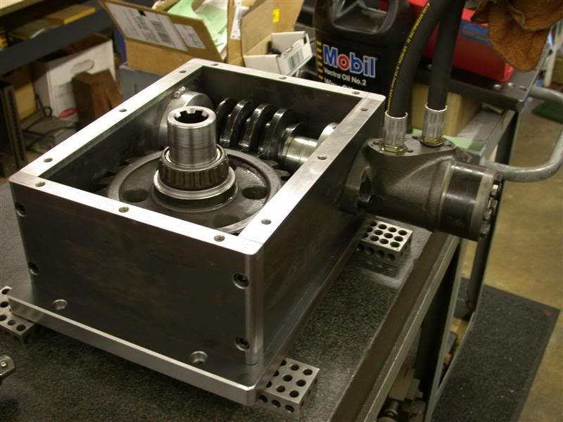

Hi Jacques, I'm sure Larry will explain it better, but I'll jump in for a second here...
Look on post #171 and you will see that Larry added a slip clutch to prevent damage to the gears in his gear box.
I suppose you can use a chain and sprocket as long as it is very heavy duty...like one of those double or triple link chains. But there is so much torque out at the end of the blade because of the leverage. If the corner were to "snag" something, you would need to be sure it could stand up to that pressure.
Larry uses the hydraulic cylinder to pull his blade from one side (from center straight behind) to the other side to offset the location of his blade, like in his video. I don't believe it is used to rotate the blade. Blade rotation is accomplished by that gear box above the slip clutch.
Hope that helps.
