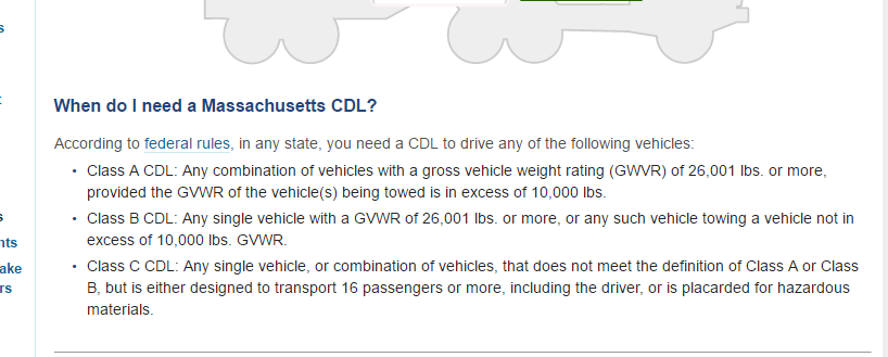

/ 3500 truck needs CDL? #103
No.
The combo only needs to be over 26k. Not just the truck.
If the combo is over 26k, and the trailer is under 10k.....(IE a ford F550 w/19,500gvw and a 7k trailer)....Class B
If the combo is over 26k and the trailer is over 10k.....(IE: 1-ton w/13k gvw and 14k trailer)....class A.
If there is no trailer to tow, then you only worry if the truck alone is over 26k....and if it is ....Class B

Looks like Massachusetts follows the fed.

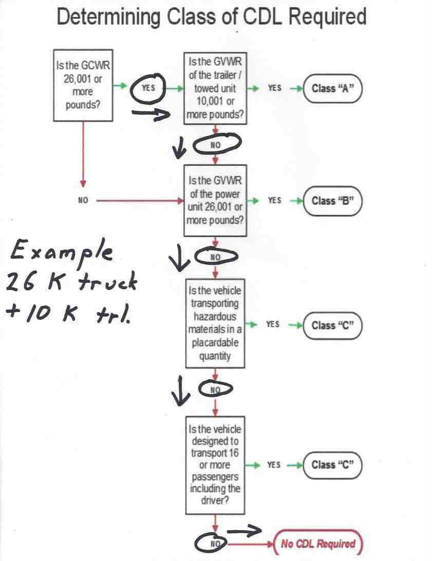

No LD1 - Rock knocker is correct. Read the class definions very carefully. Class A is specifically defined as a combo over 26k where the trailer is over 10k. Class B is very specifically defined as a single vehicle with a GVWR over 26k by itself or towing a trailer with a GVWR under 10k. Your example of a 19.5k 550 pulling a trailer with a 7k trailer is wrong. You can drive that with a class C. It can't fall in class A because the trailer is under 10k and it can't fall in class b because the power unit is not over 26.
/ 3500 truck needs CDL? #113
Yea, I'm right.
Excepting California, the Fed rules applies.
Here is the flow chart from the NC CDL handbook (page 1-1). Most state have a similar flow chart.
I have annointed it for my hypothetical 26K truck and 10K trailer. The same qould apply for LD's 19.5K truck and 7K trailer.
A 13K truck and 14K trailer would require a Class A CDL, which can be seen if one follows the second flow chart.
