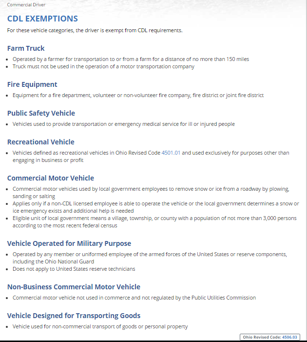

In NC if your trailer is over 10K you've got to have either CDL's or Class A. If your truck has air brakes you have to have air brake endorsement with the class A or CDL. If you don't have air brakes and stay under 26K and your trailer is under 10K you can get by with a regular license. If you have a farm tag same laws apply but the cost is 50% of the normal fees.
It is about revenue. If you pay for the tag weight the fine for the improper license is minuscule compared to being over weight. I think that they allow you 500# and then it is so much per pound over. My neighbor couple years ago was hauling his skid steer with his truck and got pinged for over $500. He had his CDL but the tag weight on his truck was too low.
/ 3500 truck needs CDL? #64
Only if you go over 26k combined.
The CDL weights are the same in every state.
Class A is over 26k gross combined with a trailer of more than 10k
Class B is over 26k gross and/or with a trailer under 10k
In NC, If you have a 12k GVWR truck, and a 12k trailer, you need nothing other than your standard license. Same as all other states

If your trailer is over 10K you must have Class A's or CDL's...
It states it on the license...
I live here...

Yes, there certainly is a lot of confusion, even about what constitutes a "Commercial Vehicle". I have had the cops tell me that ALL pickup trucks are automatically considered Commercial Vehicles, thus requiring the sticker if you are over the 10k lb. limit. And the Ford dealer where I got my truck didn't have a clue!
/ 3500 truck needs CDL? #70
What is easy to forget about is the R in GCWR. If you live in a nanny state like I do, the Rating matters, not just the actual load. So, if you help you buddy by moving an empty utility trailer for him, and the trailer is rated for over 10k#, then you have a problem.
cannot speak for canada, but in the states, the over vs under 10k only applies is the combination rig goes over 26k. IE: 12k gvwr truck and 12k trailer = okay.
I live here...
Is that a CDL?
IT is impossible to fit all the information onto a little card. You have to understand what that excerpt is refering to.
A class C is exactaly as your license describes. Any vehicle designed to haul haz-mat OR 16 or more passangers.
IF using a vehicle that fits that description as the tow vehicle.....you have to keep the trailer under 10k.
Fortunatally, a 3/4 ton or 1-ton p/u doesnt fit that description, therefore are not bound to the 10k limit. Just have to keep the combo rig under 26001
