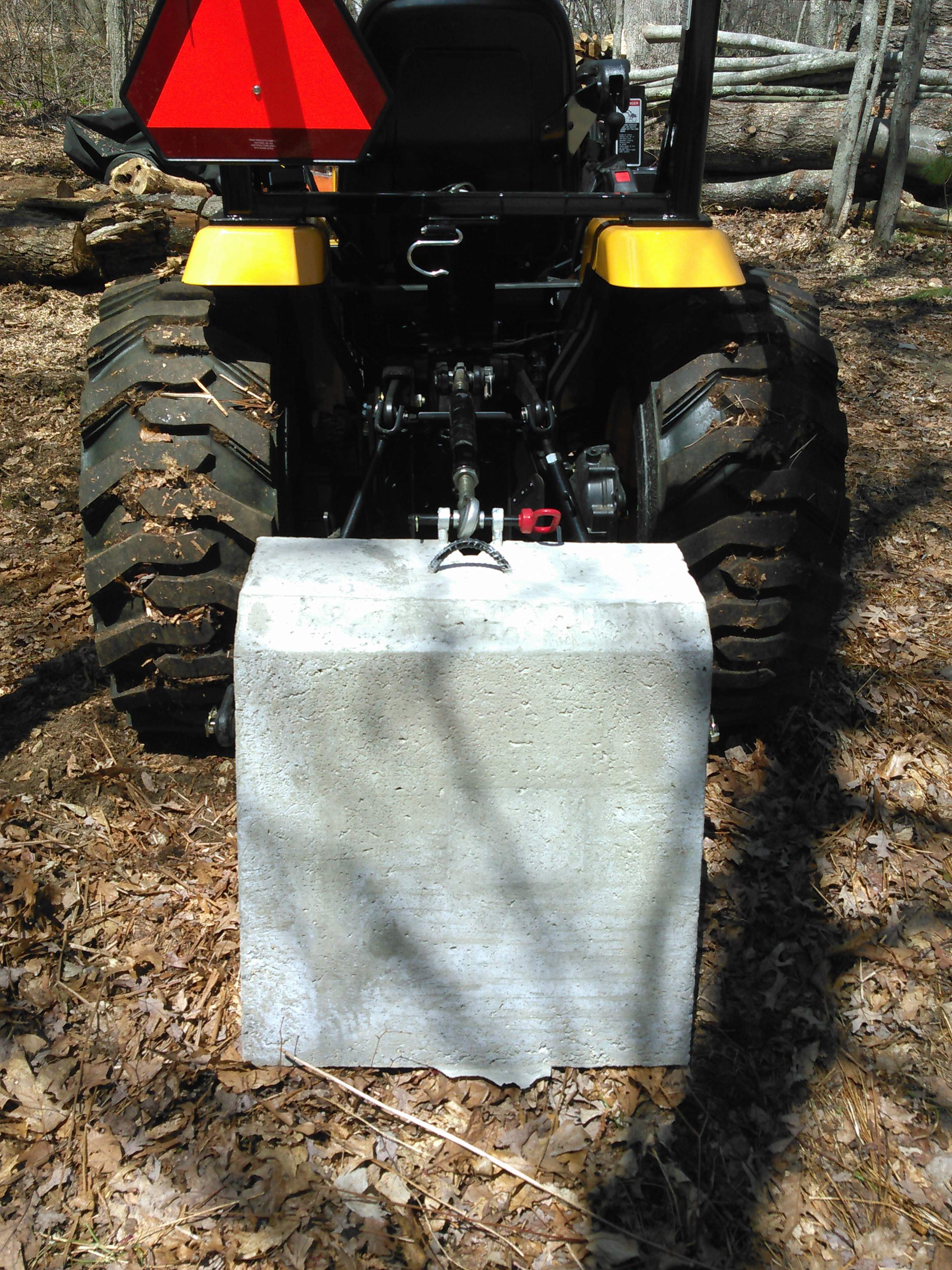

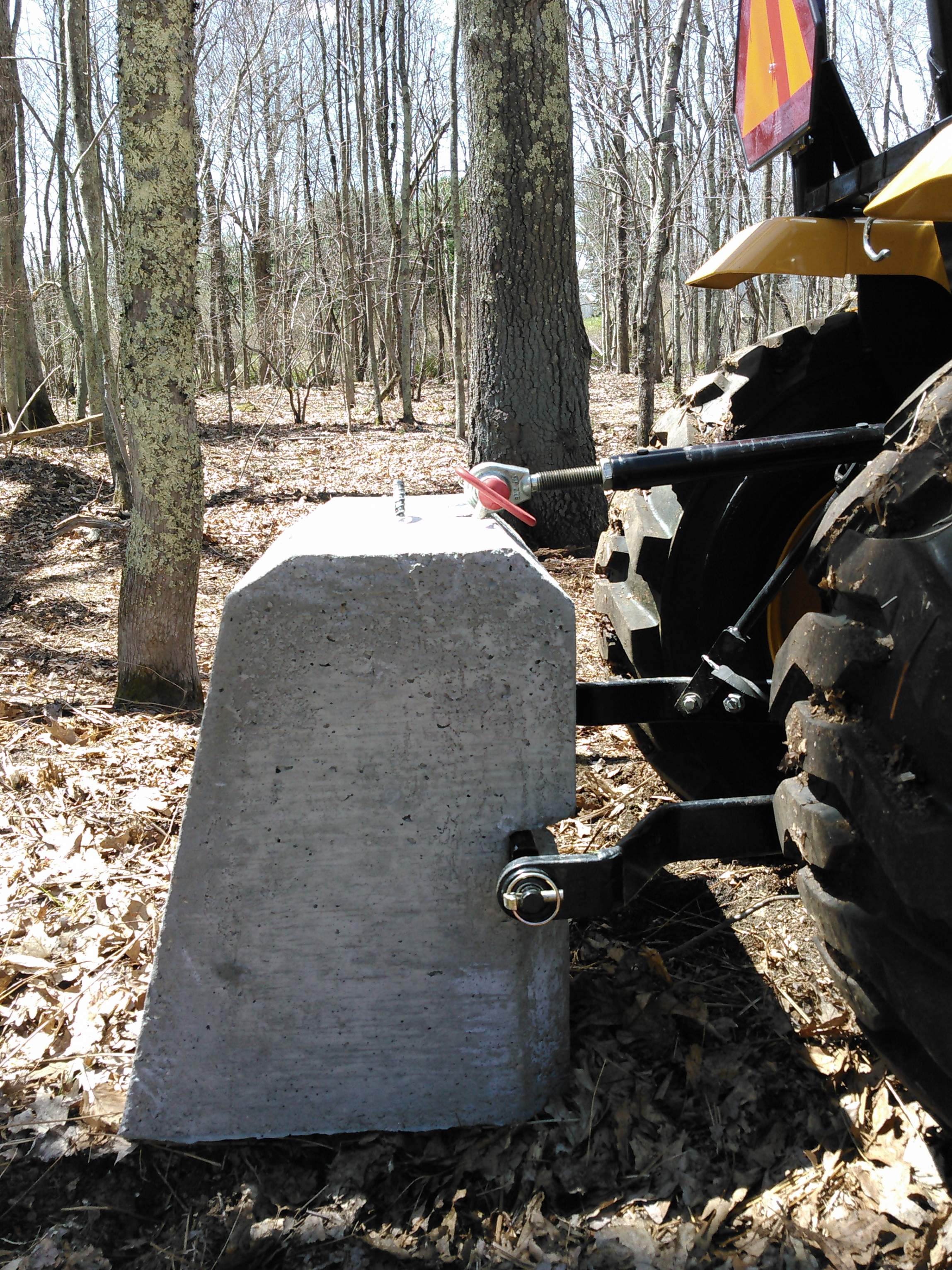

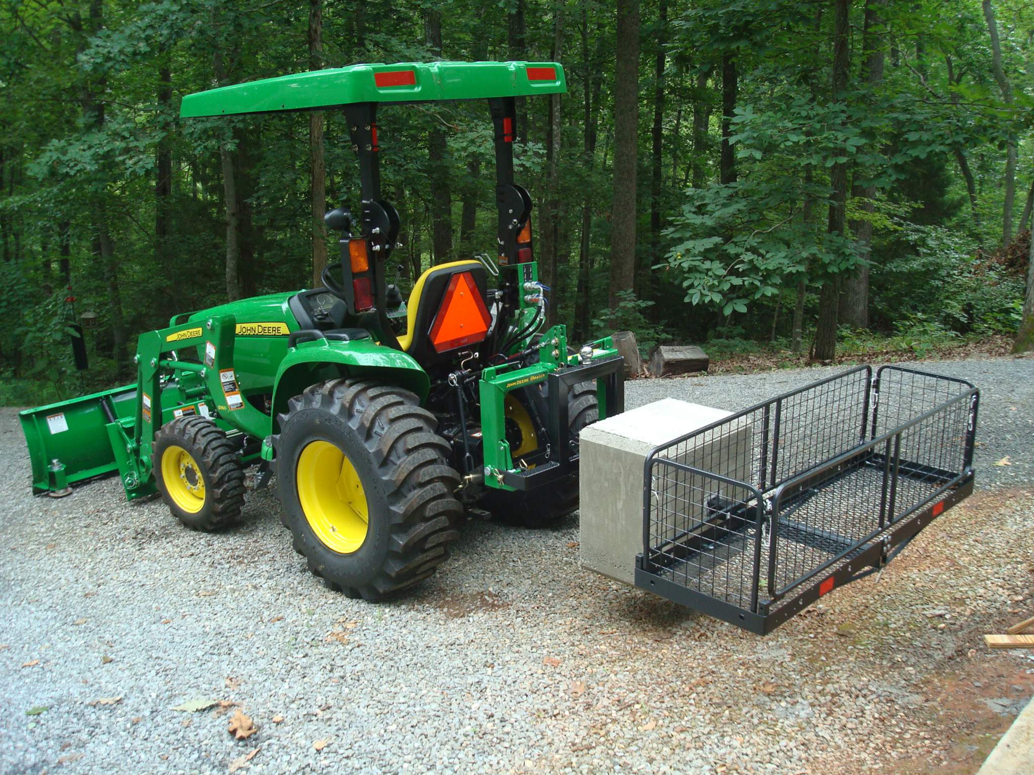

Hey, Fellers,
Couple things about the 3038e I just bought.
First, the photo shows the concrete ballast block I fabbed up. It turned out nice, but it's too heavy. I got the AF11 hydraulic-angled front blade for pushing snow. I believe the blade's 780# and it projects a ways beyond the loader frame, so I wanted to unload the front axle some and have more rear weight than just filled tires. (If I'm reading it right, the manual says that with a loader, the minimum rear weight is filled tires plus 380# hitch weight.) Anyway, the block measures 6 cu. ft., so figuring 144# per cu. ft. it's almost 900#. The rear hitch is rated at 1300# @ 24" behind the lift points so I thought it'd be OK. Turns out the rear hitch will barely lift the block at rated rpm. Plus it just feels too heavy. Ya know, when I was building the form, I thought about reducing the size to 4.5 cu. ft., but noooo. And, with the cost of a shop welding up the 2" receiver assembly and reinforcing steel that runs through the block, I didn't really save much over the cost of the JD BW15073 ballast box, which is what I'm going to do now. Hope this info helps someone avoid the same mistake.

When first looking at the pic, I came to the same conclusion upon reading of your experience.
I have the ballast box and like it real well.
You should be able to sell your heavy concrete block to someone with a larger tractor.
But on first look, I wouldn't want the large array of basket and block sticking out that far behind my tractor. Hits too many things and digs into any slight raise in the ground unless you put on a hydraulic top arm to tilt it up.
Wish you well on downsizing that ballast. And enjoy the tractor.. should be a good ride.

My father in law has the 3032e he has 500lbs at the pins and its not enough. His tires are not loaded. For the heck of it can you take the plow off of the front and see if your 3pt has an issue lifting it. Your hyd system also has a max total weight it is capable of lifting just wondering once you take weight off the front if your 3pt has no problem lifting the 900# in the back. I also think you have the weight set way to far behind you. But like others said i think if you entered into the woods with your set up i think you would find it really cuts down on where you could go. Just to let you know i have the next size down from your tractor twin to the 2720 and i have a 750lb block on the back and its perfect for the tractor. Again i also do NOT have loaded tires. Here is a picture of the weight i made and how it tucks into the tractor.

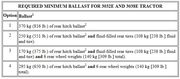

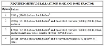

I assume you have a 305 loader. If so, I think you may have mis-read the manual.
With fluid filled rear tires the minimum 3PH weight is 551 lbs.

That is a nice looking block. I bet it would work if you hooked it up to the arms instead of to the quick hitch. That would bring it quite a bit closer to the tractor. But I can't tell if it has pins like a drawbar would have to be able to do that.

I assume you have a 305 loader. If so, I think you may have mis-read the manual. With fluid filled rear tires the minimum 3PH weight is 551 lbs.
Jgayman is correct. I have the D160 loader but the ballast table is same as what he posted for the 305 - I misread the table.
The other comments are also right on, about the whole rear rig projecting too far back. The cleanest design would have been to cast side lift pins and a top link in the block so it could be connected directly to the iMatch. I couldn't figure out how to fab up the side pins with standard hardware, so I decided to go with the 2" receiver concept which I wanted anyway to move trailers around with.
Anyway, the JD ballast box will tuck right in on the iMatch, and I'll probably bolt a 2" receiver tube to the top of the box, so the cargo carrier will also be closer in and higher. Still, even though the rig doesn't leave the driveway and parking areas, it's probably just a matter of time until I snag that carrier on something. Sure is handy, though, to load that basket up with a chain saw, line trimmer, gas cans, etc.
