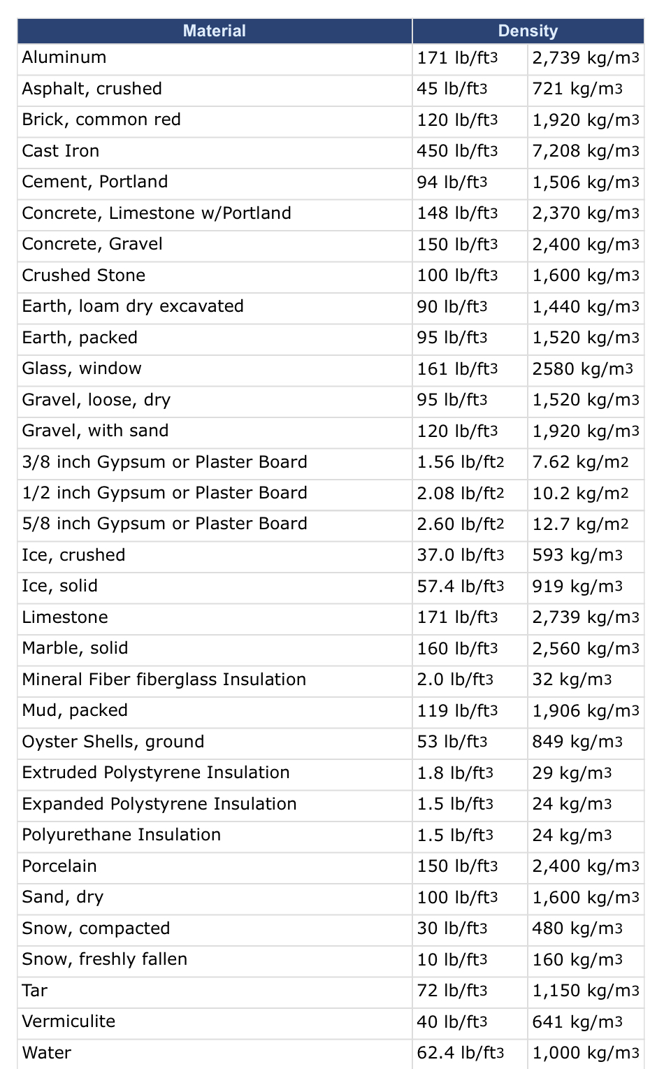

Some stats about concrete:
Concrete dry mix density is about 162-164 lb per cubic foot if you can get the air out.
To make a cubic foot of concrete from typical sack mix, you need 135 lb of concrete mix and 14.1 lb of water. So that is about 149# total. After curing it will drop to about 145#.

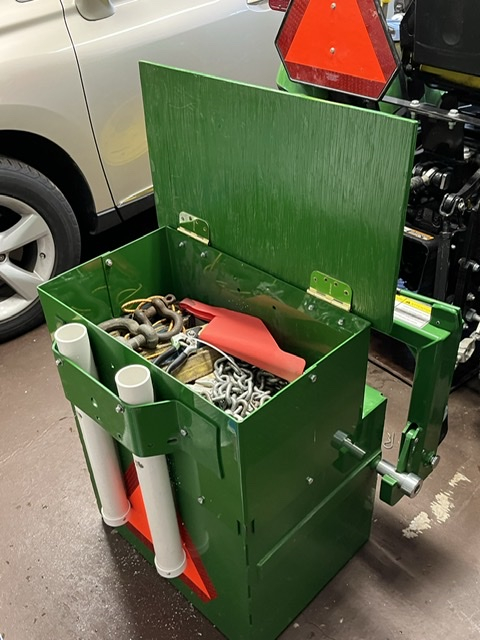

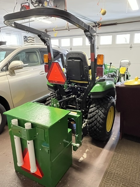

OK, I went with 6 50# bags of pea stone. Looks like I can fit 2 more. I think I'll bolt a bracket to the back of the box to hang some suitcase weights on also. Ill keep my chains and stuff in the 9" extension tool box.
Thanks for the responses.
