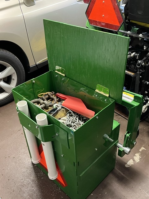

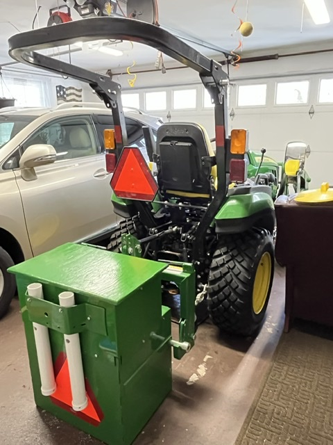

I filled my ballast box with concrete back in 1999, it's now on tractor #2, I've never wished for my ballast box to have anything in it but concrete. Maybe a few times I wish I had put the PVC pipes in it for a shovel or rake. But that would decrease the amount of concrete in the box, and I was going for max weight inside my box back then.
   / Can I just pour cement in ballast box and add water.
#28
All done! 8-50# bags of pea stone. used the drive over bracket from my mower deck after I installed the lock n’go to hang some suitcase weights if ever needed(I doubt it). 2-2” PVC tool holders
Ready for action!
