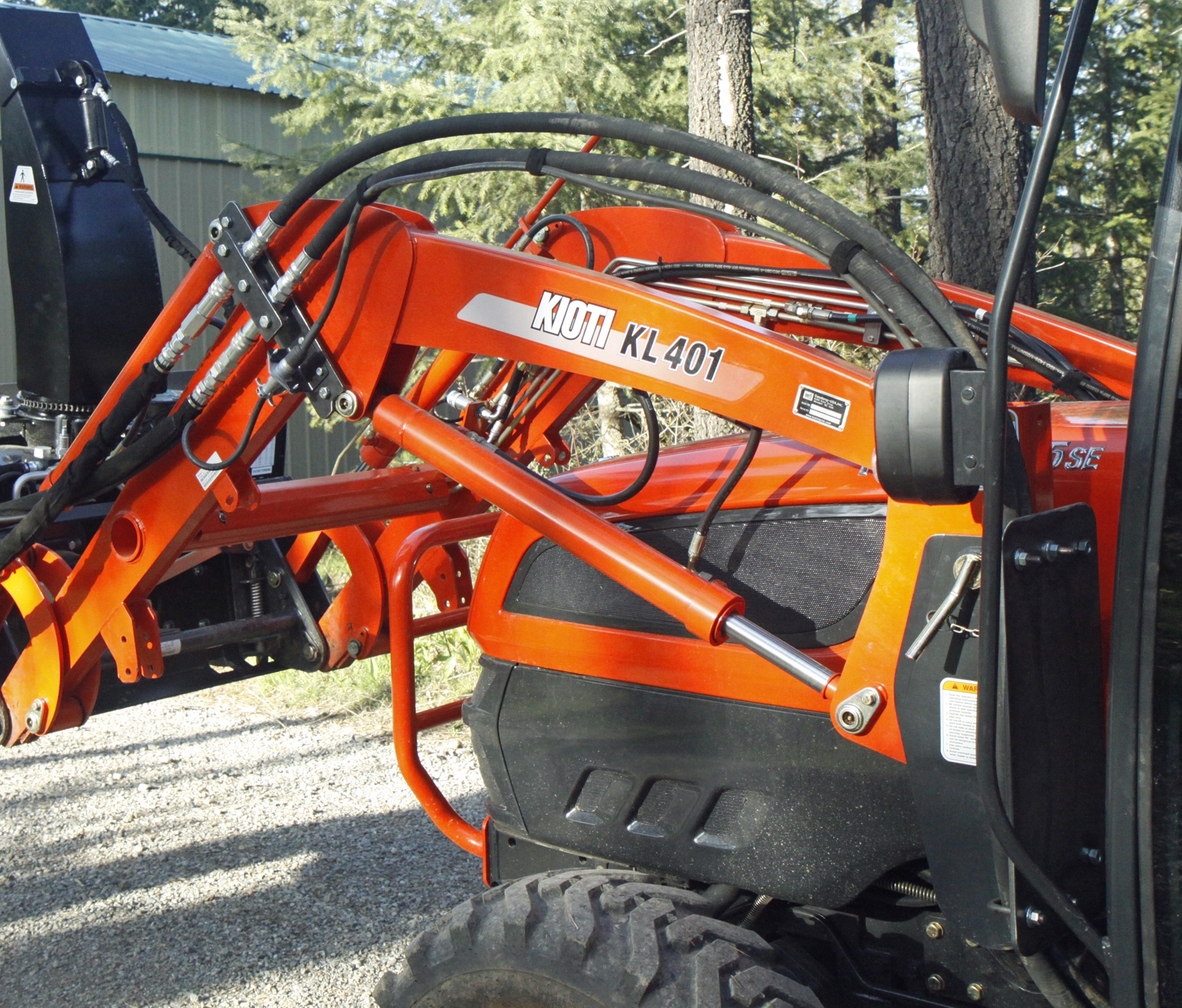

After reading the FEL Mounted Brush Mower / Trimmer thread. Thread is old, does anybody make a PTO driven 3 point hydraulic pack so you can run skid steer FEL mounted implements? Fabricating one would be cost prohibitive. I built a FEL mounted York rake and it works great to clean up woods roads.

I have one made by Quick Attach. Works my front mount hydraulic snowblower
