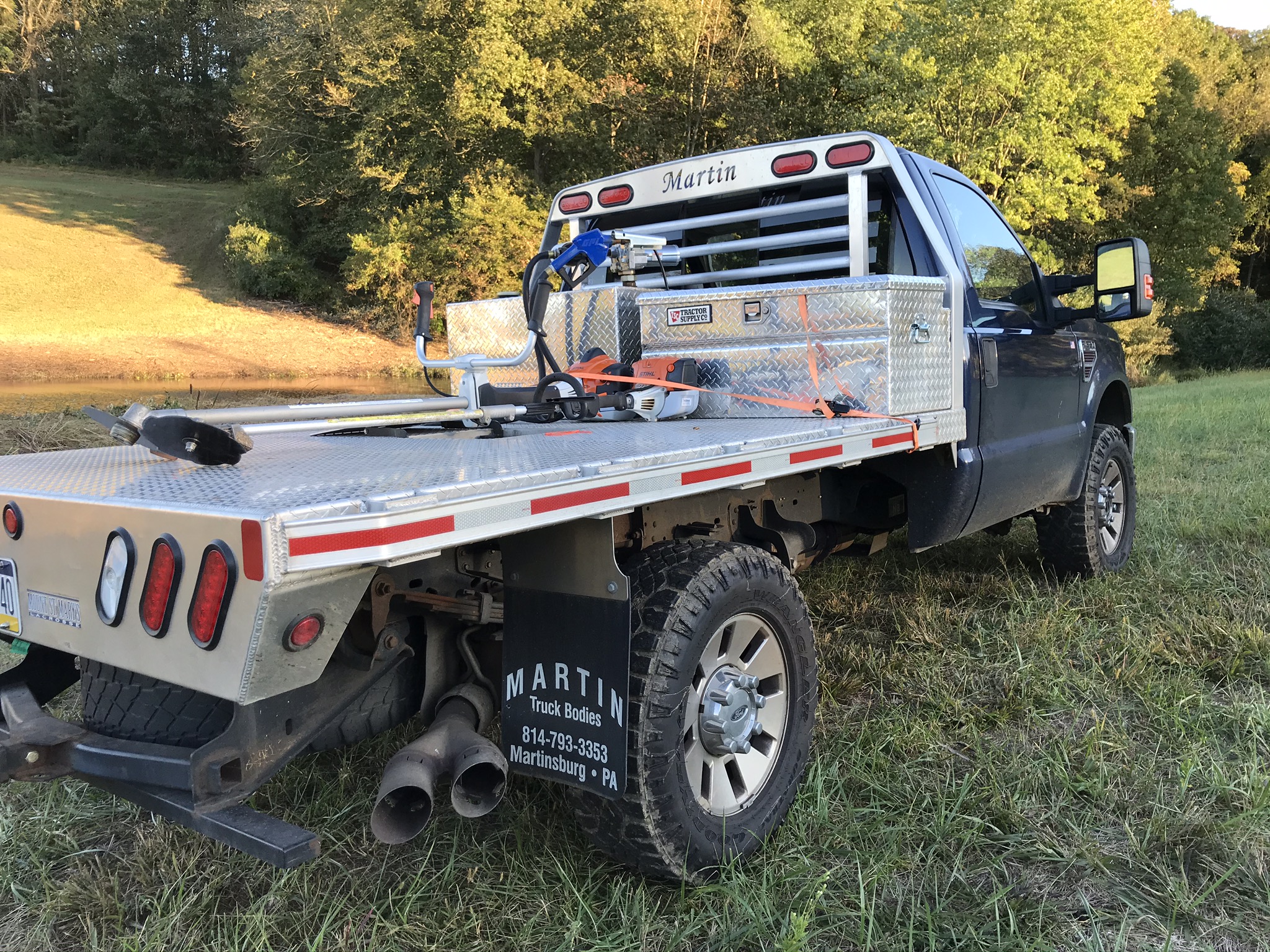

So after a few emails, found out Im getting a BW turnover 45,000lb hitch installed.
With that set up, you can easily interchange a 2-5/16th ball for the 3" ball.
I traded my 550 on the new truck, but still have my '08 F-350 flatbed. The 350 has a B&W turnover with a 2&5/16" ball.

Glad it worked out! Nice setup on that flatbed!
Thanks. After owning flatbeds for last 15 years, I see how useful they are compared to a pickup bed. So much easier to “work out of” than a pickup bed. I really like the F-350. I use it for snow plowing, too. Being a regular cab with a flatbed, its kind of a “throwback” truck back to when 90% of trucks were regular cab.
