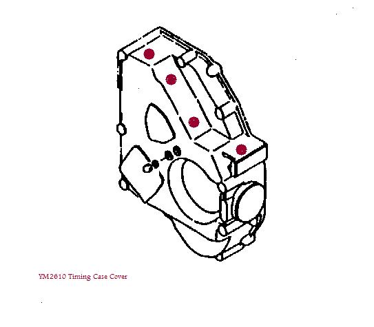

Jagmandave, would have loved to drill and tap oil pan. Only problem I seen is the fact that the oil pan is only about 3 inches deep and is above frame. I could see no place to tap oil pan.
Is there something I missed here. I will relocate drain if I can to a better place..
