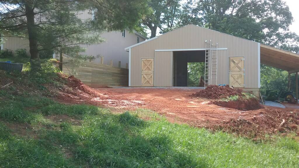

I think I know answer, but appreciate input/ideas.
I'm running underground electric to a new barn from a garage. From panel to just inside barn is 130 ft. From panel to across barn other side is 200 ft.
Neighbor has lots of Square D boxes, etc. I can have. (His electrician Dad passed).
Barn will just have lights (maybe 6-7...so 420 watts max) 10 outlets (1500 watts max), so 25 amps max.
I thought I'd put a 50 amp breaker in garage box, run 8-2 uf wire out to a small panel box in barn. I don't need 240...but it's there and I can split it (2x120v).
I prefer copper...but I'm trying to save money. It would look and be better in conduit to other end...but shorter run means smaller gauge (200ft run=6-2 or maybe 4-2 wire?).
Thanks...ideas.

It's very close the the garage, where I can weld, etc. I can't see where I'd need more current. Thanks all advice! 20190527_161531.jpg

I ordered 2-2-2-4 Aluminum Mobile Home Feeder Cable 200ft $208 with shipping. I think that should work fine.
/ 240v wire to barn size? #11
At 200' +/-, voltage drop calculations come into play. The 100a mobile home cable you ordered should be adequate at the distance and derated to the smaller breaker you plan to use. Be sure to bury it 18"+ deep, and put 'Caution Buried Electric' red warning tape over the buried line, about 6" below the surface.
As you may know, resist the urge to drop a water line in the same ditch, or phone line. Both should be seperated by 16"+ from the electric lines. Phone line for signal interference reasons, water for the obvious reason that water and electric dont mix well! But you can get away with one 18" wide ditch, with electric on one side, and water and phone on the other...
#12
Today we decided to put the panel box just inside the door I'll be using. That will be less than the 200', about 130 ft. from garage box, so even less v-drop.
Maybe I should go with a larger breaker (60-70 amp?). Then another main in horse barn box, then three 20 amp ones should be enough.
As big as 2 gauge is, can I fit wire into breaker?
