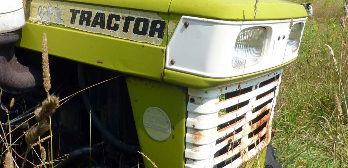

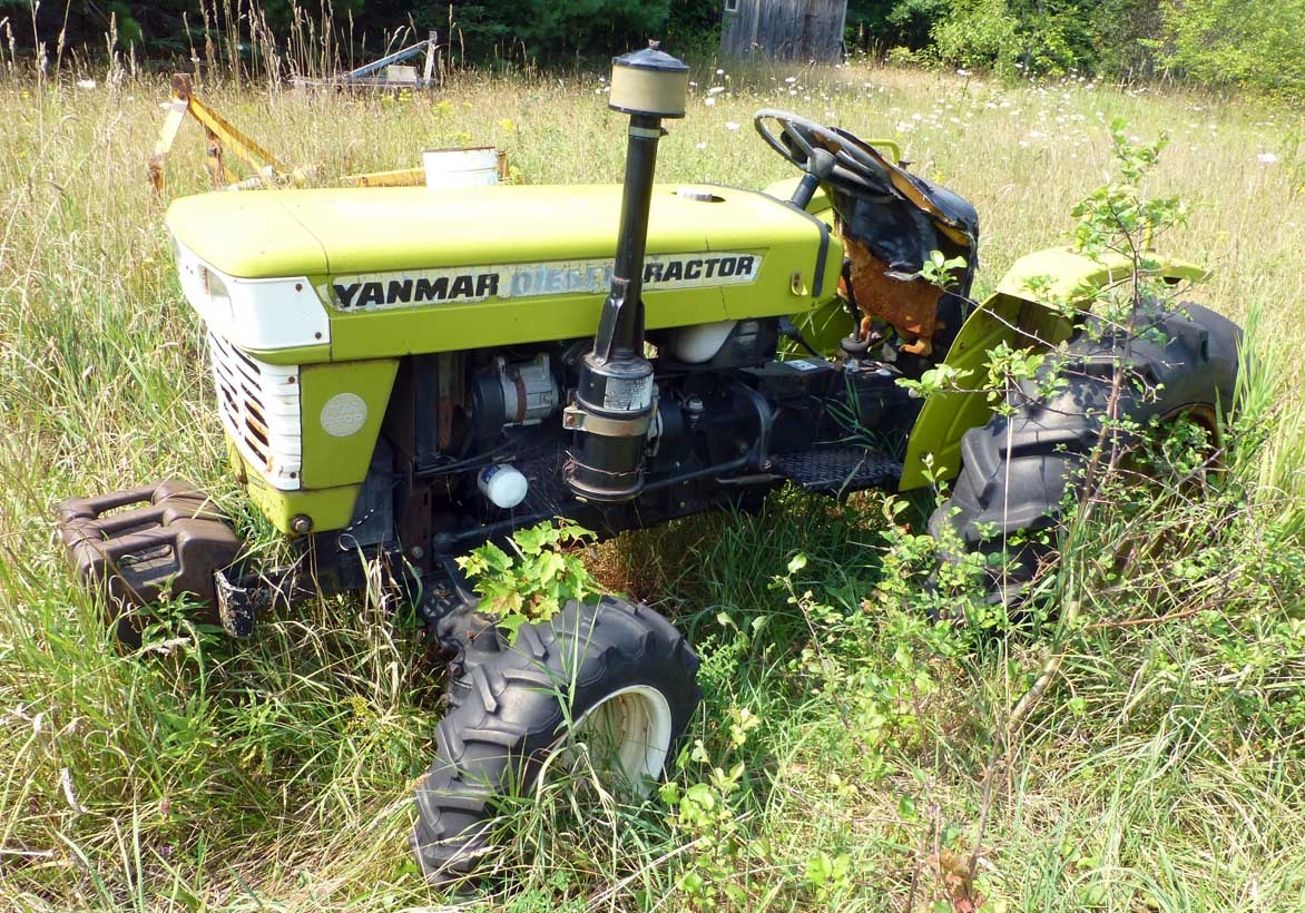

Spied this tractor at our friends house and its a 240D and she wants to sell it. Her late husband got it new in the 1980s. Hasn't been ran in 3 or 4 years. Should have asked if it has a loader but I'd guess not. What do you think, should i pursue it?
/ 240D for sale #2
Tell her $4k at least. Maybe more depending on the local market. They're indestructible.

I would suspect the injector pump rack will be seized and clutch most likely as well. The engine may need freeing up too. Definitely not worth $4,000 to me. $1,200 to $1,500 at the most.
Why? I think more likely cranking it with a monster battery would start it like it ran yesterday. 4 years down shouldn't hurt anything.
Use the compression release for initial cranking in case there is water in the cylinders. I see a bucket over the exhaust so that shouldn't be a problem. It does apparently need a replacement muffler, $100.
I would check the fuel bowl for water first and after running a little, and the obvious oil and water checks. There's not much on these that would prevent starting.

Why was it parked outside for the past 3-4 years?
There is a clip on the clutch pedal that is supposed to be engaged to hold the clutch open when stored. If the clutch was left engaged for very long, my guess is the clutch will be stuck.
I definitely would turn it over by hand from the flywheel before putting a big battery on it. It is a common issue for Yanmar injection pump plungers to stick after setting up for a while.
