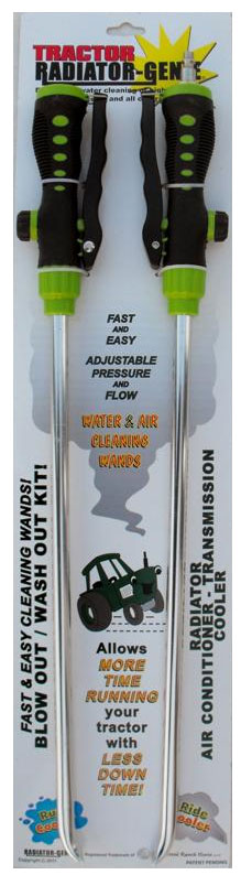

I use this to clean the outer filter and the radiator. They have an almost 90 degree bend at the tip.
/ 2210 air cleaner causes bog downs #7
Where do you get this kit?
/ 2210 air cleaner causes bog downs #9
Costly, but then so is a plugged radiator..
I get an air wand (24") at HF for under $3. Works very good and use for a lot of things without getting close and also standing up when blowing off the tractors after each use.
