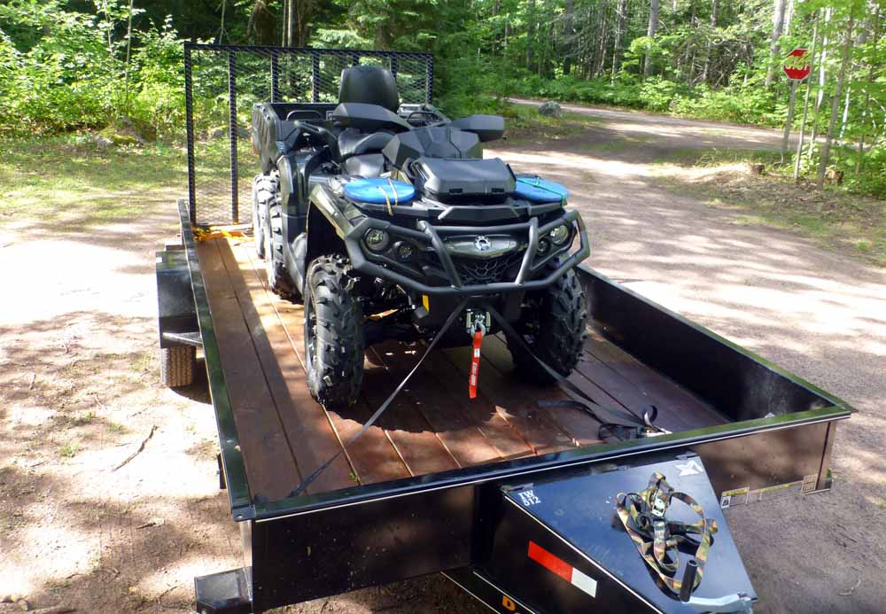

Here is ArlyA

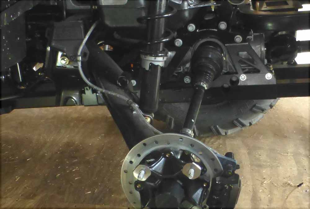

Yesterday I dumped air from the center axle tires and I decreased those struts preload. I took off the weights from the machines front and test drove around the yard and it steered much better. That is it turned, instead of skidding the front tires. Gee, this machine is indeed built heaveir duty than the Polaris is.

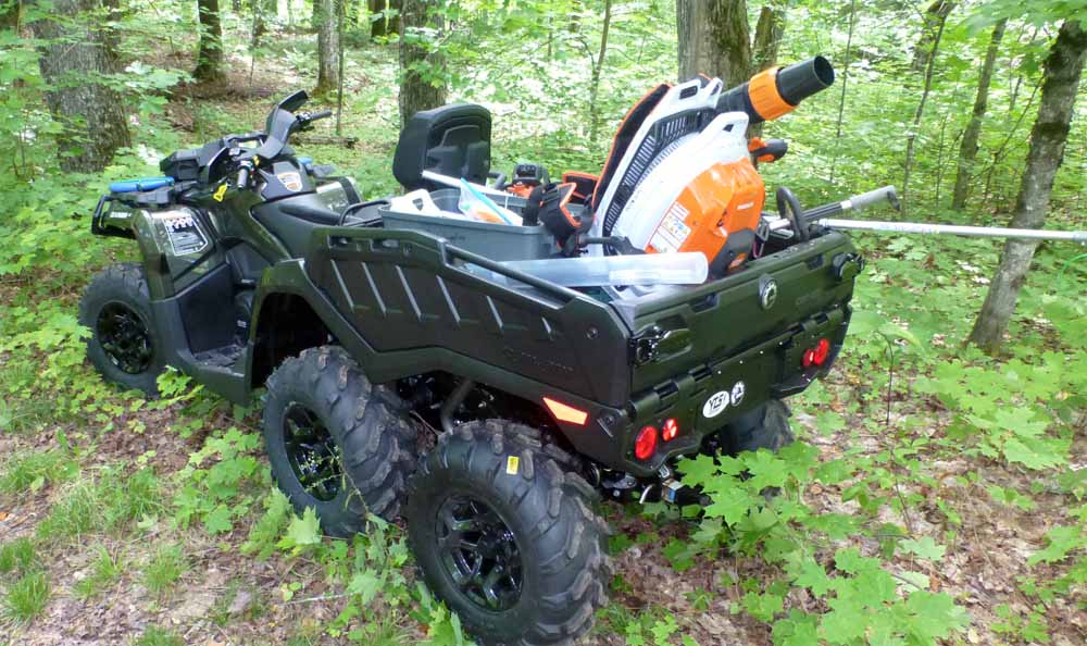

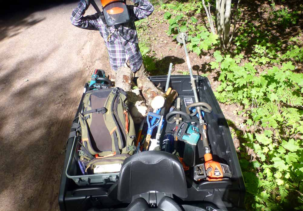

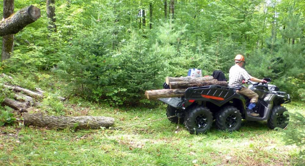

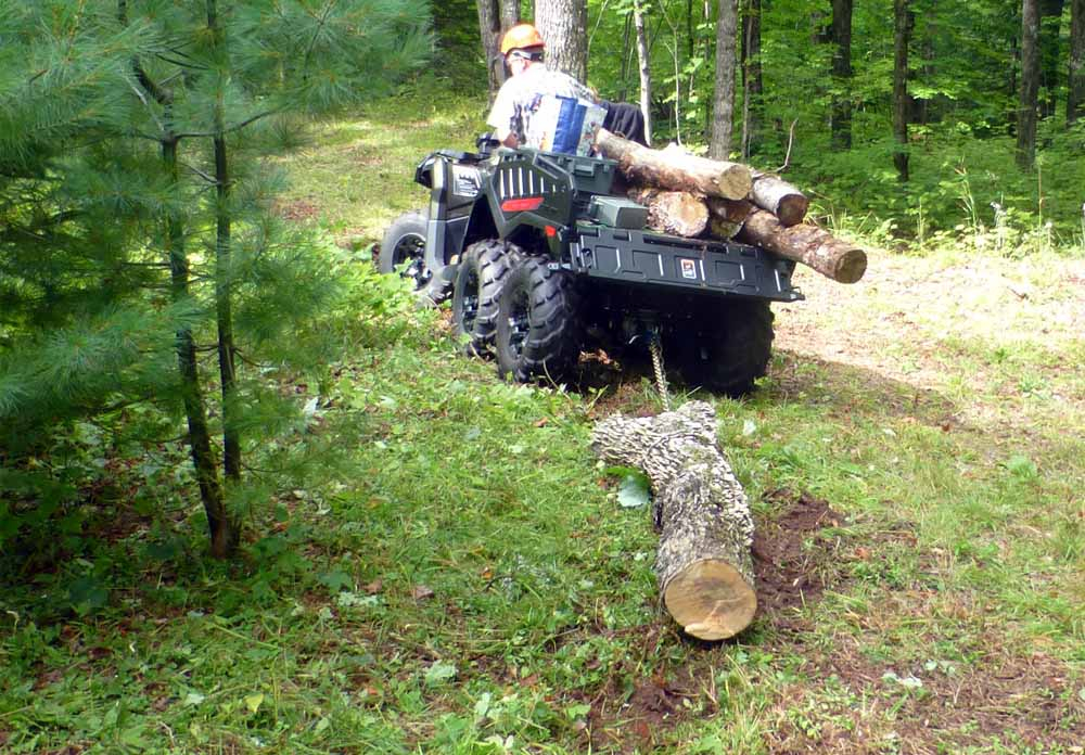

Out working on trails today.
The logs not all that big and the machine did not grunt.
All done filling the hole with corduroy.

They will steer after its suspension is adjusted. I'm no genus but on all the 6x6 forums, I here these same comments. All we need to do is lesson the PSI and strut preload on the center axle. I'm still making adjustments on this new machine to improve its steerage but it has been greatly improved. I'm surprised that Can-am mentioned nothing about these adjustments in the manual....

Since we need to have one axle sliding some, I thought the center axle would be best at that. The turning radius was lessened because the front wheels skidded straight less..

ha I see ... you increased the front wheels ground contact, that make sense ... I am wondering what would be more effective, that or doing it to the rear wheels to lower their ground contact so the rear wheels slide instead of the front wheels ... if you are loaded or pulling something your way is better for sure tho... regardless it good to know thank,

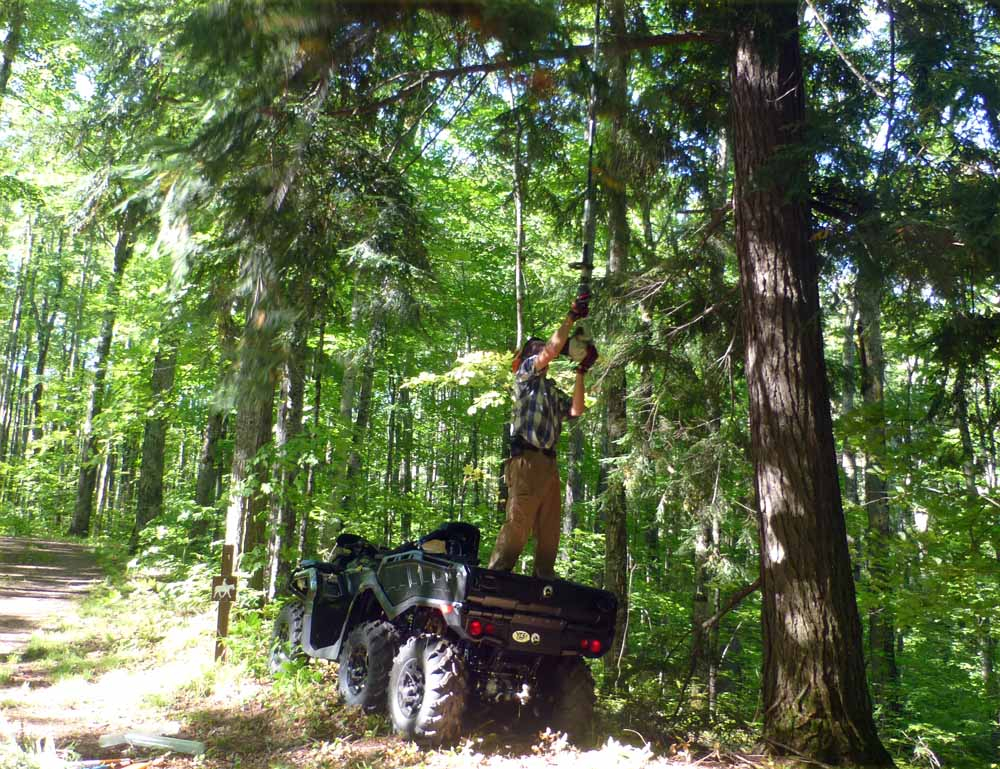

BRP doesn't seem to think users need tailgate cables, or something to hold it level when open. Just added some cables so this can be used as a work platform when pole-sawing trees.
