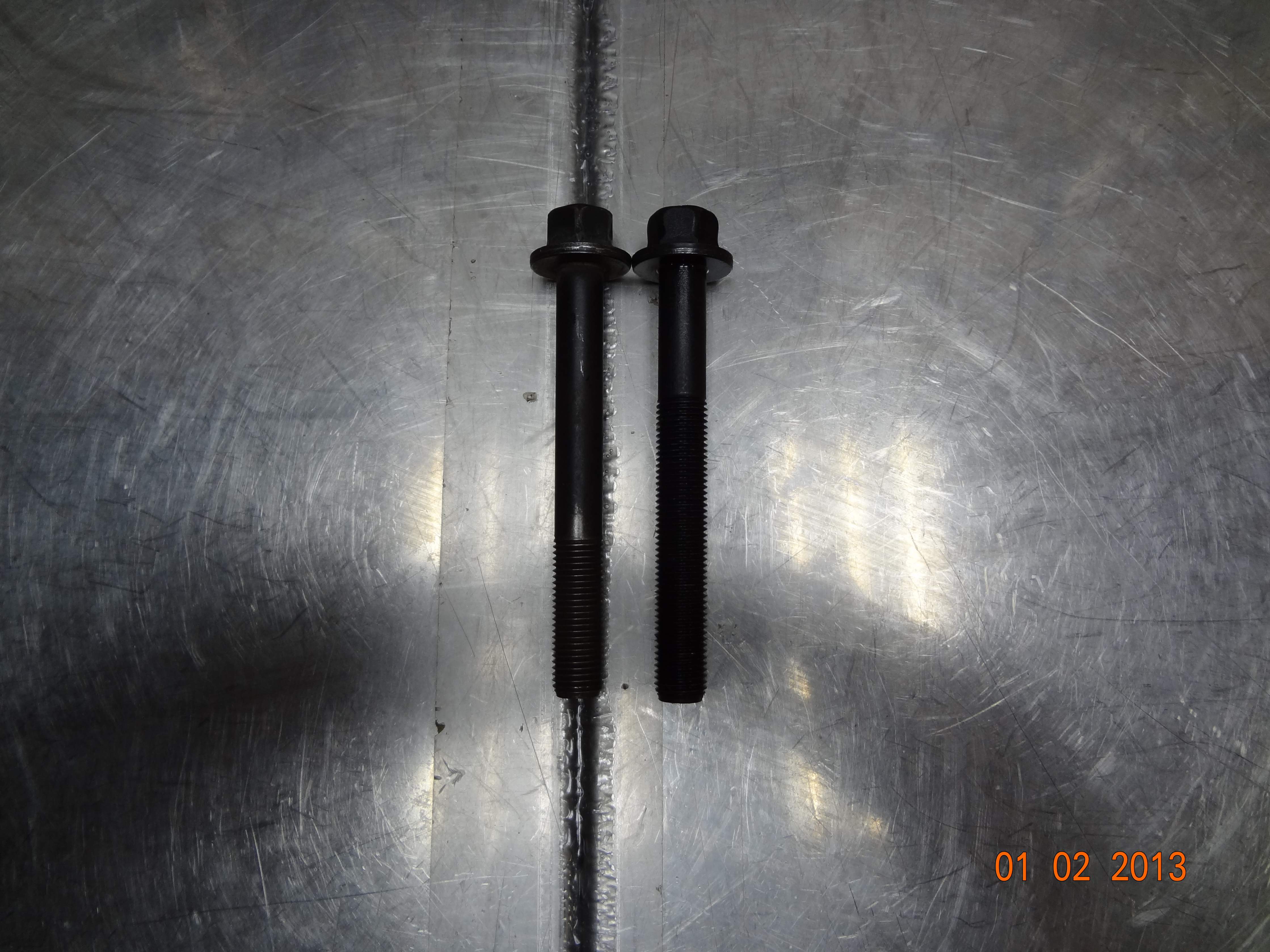

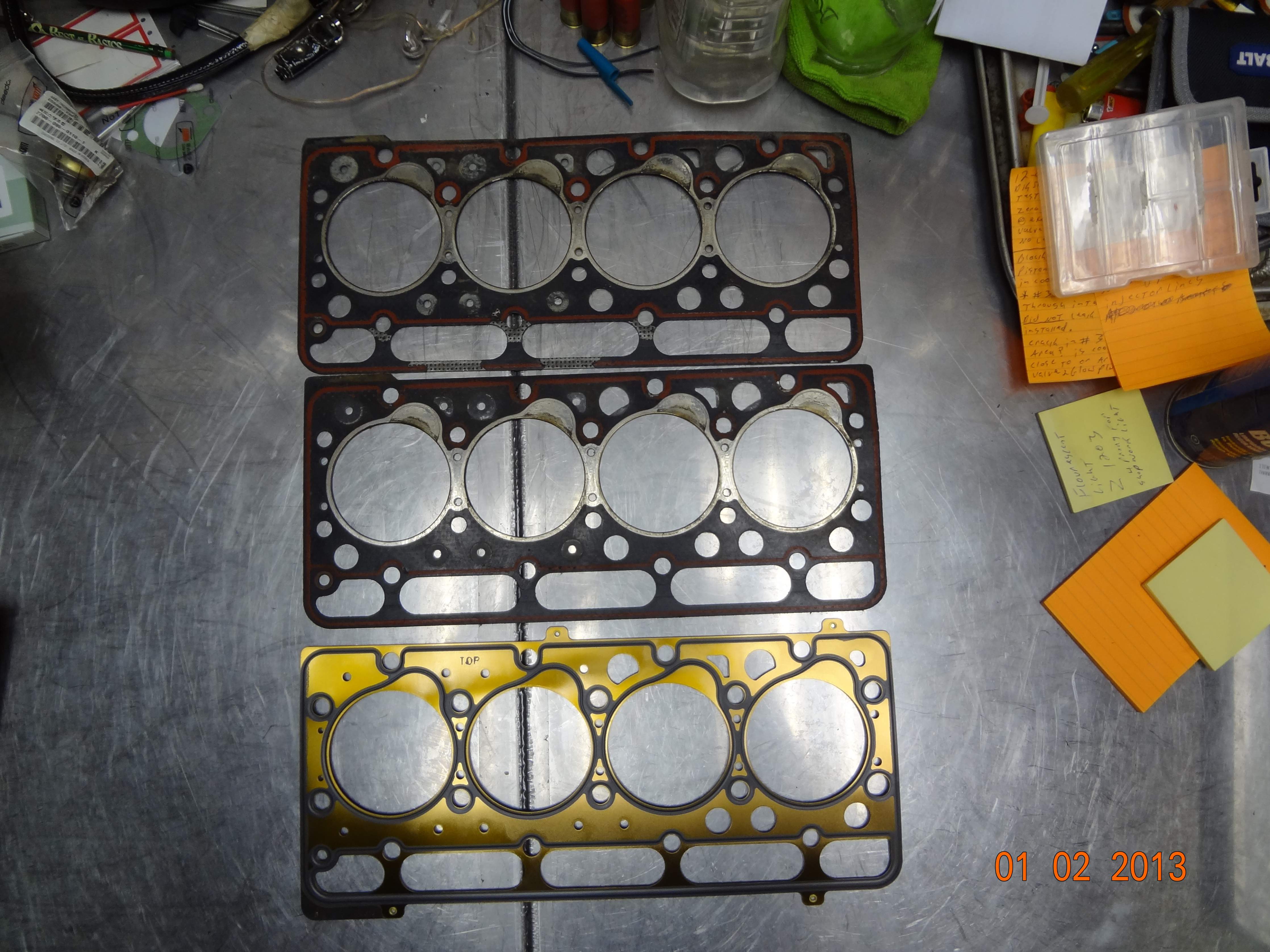

Well, there's a new and upgraded head gasket for the 4a200 series engines. It's MLS and you must use TTY bolts.
The NEW procedure for the head bolts is: torque to 28.92 ftlbs, step2. turn 90* in sequence, step 3. turn 80* more in sequence.....adjust valves and re assemble.
SO FAR working great ! INSTANT starts, less "knocking" and haven't noticed any loss of power ( the MLS gasket SEEMS thicker)....BTW, MLS head gaskets are the bomb from past experience, I was just suprized they now use them on cast iron to cast iron head joints.
here's the pics of all 3 head gaskets, top is e6500-03311, middle is 03312, bottom is MLS 03313, and the bolt change. OEM bolt next to the TTY bolt ( longer thread section)
Sorry, I forgot to remember the head bolt PN's.
When doing the final "yield" 80*'s, using my "beam" torque wrench, I noticed the final clamp load was between 65 and 80 ftlbs.
DO NOT use this as a spec thinking one can bypass the TTY fasteners, I was just making an observation of final clamping force.
If you do one, you will FEEL the bolts stretching during the yield process.
Thanks for all of the replies and suggestions. It's nice to know that kioti found it nessesary to upgrade these gaskets to MLS, obviously the old designs were failing pretty regularly ( just a GUESS on my part)
