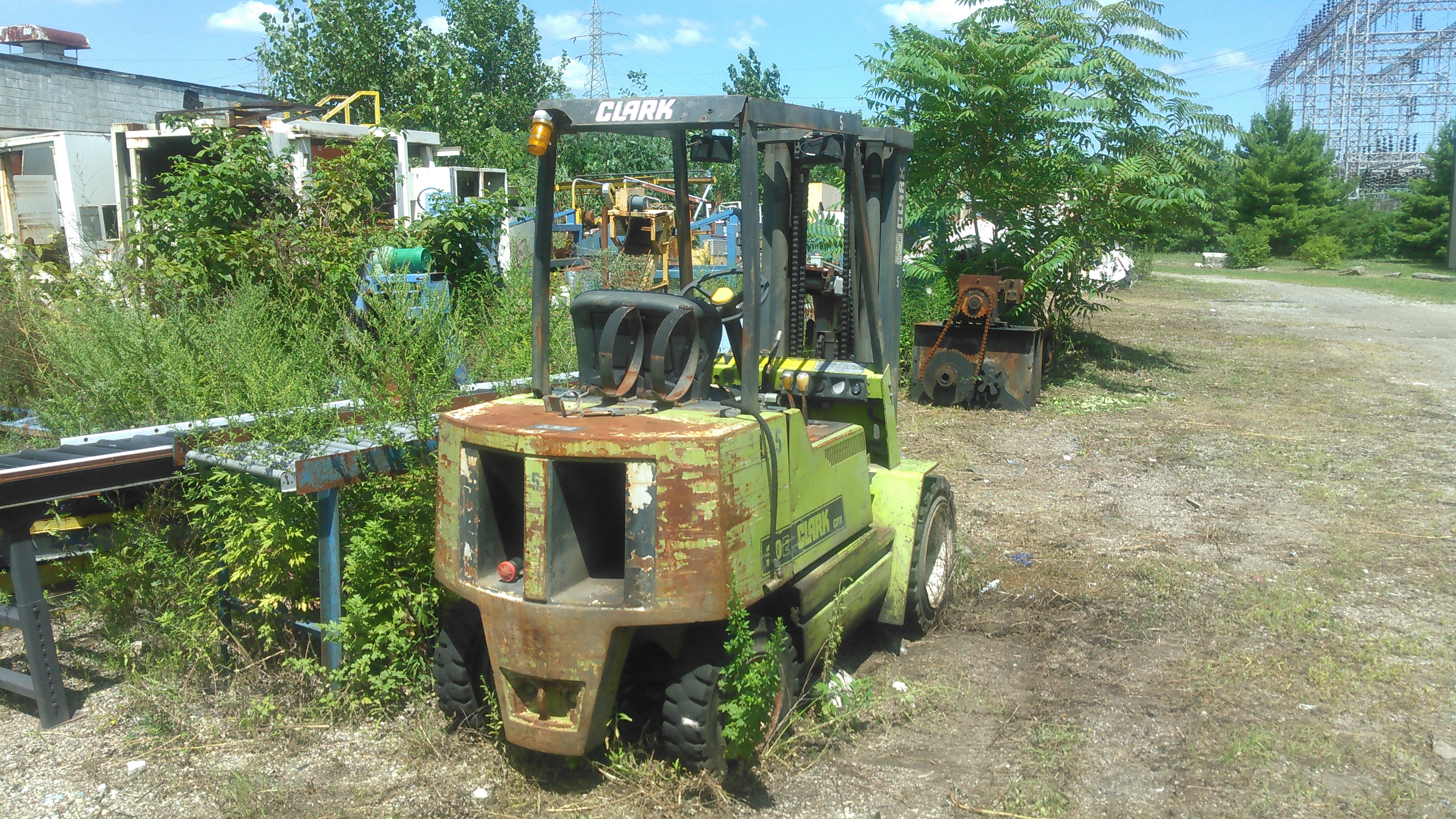

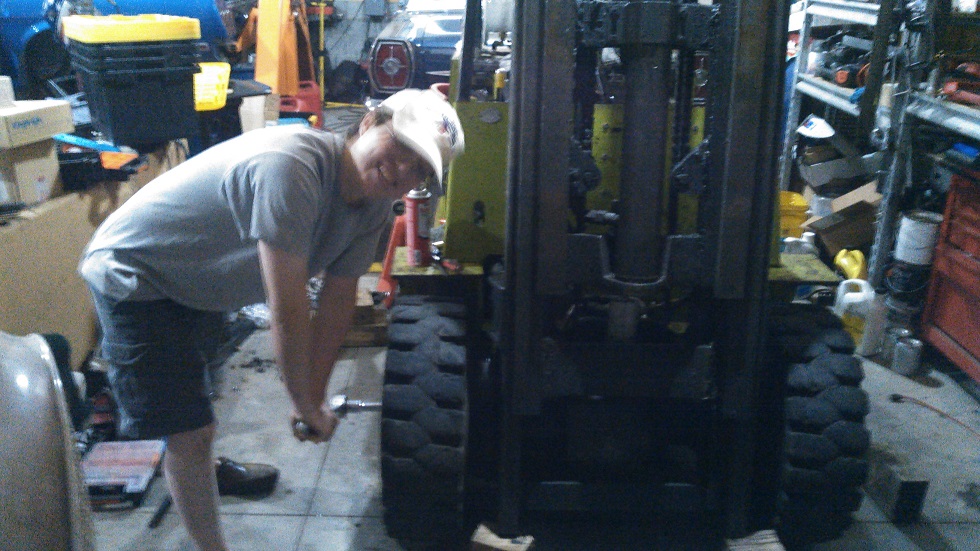

had mentioned this thing in someone elses forklift thread, figured might as well put it on its own...very few threads on lift trucks out there...hey, theyre kinda a tractor :) our other tractors are a 68 cub cadet 7hp, and a 1998 ford/newholland 1630 4wd diesel...needed a lift truck like a hole in the head, but couldnt stand to see it scrapped over leaks...
Anyways, background- they were scrapping equipment at work, I ventured out to see what was there...i'm a glutton for trying to save old stuff most folks would trash...anyways, this 1994 clark gpx30e was put out to pasture about 2 years ago, rear main seals, smoking/running poor... wasnt worth the quote our towmotor guy gave them to rebuild motor, so they put it out to pasture- just parked out in the scrap machinery courtyard, pulled the tank/battery and walked away, bought another used truck to replace it...forklifts are pretty cheap these days, a decent running one like the clark could be found for 2-3k...might not be pretty for that kind of money, but lift trucks are usually not the prettiest machines in the shop anyways...
I saw it, looked it over real quick, seemed all there, hadnt weathered too severely, so asked the boss about it...he knows how I am about old junk, made me a deal I couldnt refuse... figure I could pull/rebuild engine(ebay kits only like 400 bucks), give it a once over and have a handy tool for out in the garage...figured hydraulics would likely need lot of seals from weathering, not a big deal... it looked to be all there, just rusty, even had decent tires...
Got it home, lots of really stupid issues were found- wrong air filter, ALL vacuum lines missing except pcv, coolant expansion tank line from radiator was going to top of expansion tank instead of bottom, so it always overflowed, never sucked back in, pouring oil all over the place(never really looked, after being told main seal was why they trashed it), missing tilt cyl bushing, mast saddle clamp literally falling off one side, found spring in pcv valve was flipped 90 degrees sideways inside valve(pcv wasnt sucking anything, breather was smoking a little)... got all the little stuff worked out so no surprises beyond a engine repair before committing to that job, pulled the tin off and pressure washed as I went... anyway noticed oil leak seemed more than one place...while floor was out, popped inspection cover to see how mucky the bolts would be in there- bone dry? couldnt be a main seal... cleaned up some more crud(inch thick- this poor thing musta never ever been pressure washed) and started looking for other leaks,brushed against the oil filter- the darn thing spun... un freaking real, whoever changed oil last didnt even snug it, was spewing, running along bottom of block, dripping at front of pan, and lower bellhousing always had drips on it... new filter, the major leak stopped, but bellhousing drips overnight... found valvecover leaking (mits 4g64 with the half moon insert for cam installation was leaking slow/steady, running down bellhousing- they assumed it was rear main without ever looking...replaced valvecover gasket, she aint leaked a drop.
replaced tilt cyl spherical bearing, readjusted the lengths so it wasnt torquing the mast at fully back, after retightening mast pivot caps...parking brake was seized up, pulled the wheels off (my God, they gotta weigh 250~300 pounds each), brake inspection covers, could see park brake cables looked fine- just stuck in the sheaths... penetrating oil, patience, got cables lubed, park brake works fine too.
ordered decal set, and paint, gotta hammer out some dented steel, already sledgehammered the bent wheel lips round tonight, was a workout, think theyre 5/16 or 3/8 thick steel... no leaks, everything works- last mechanical things to do, steering link bushings are super loose as are lift/tilt handles- gonna ream handle pivots to 5/8, make new drillrod pivot pin, mill the worn slots out and add a bushing on the spool pins to tighten the controls up, will pop the steering links, see if theyre bushings or needle bearings... with a coat of paint, I really think this things gonna be looking/running great... sad it almost wen to the shredder over simply horrible maintenance/ bad 'mechanics'... I dont claim to be a mechanic, but this thing was really trashed- enough so gotta wonder if sabotaged to try and get a 6k engine rebuild job?

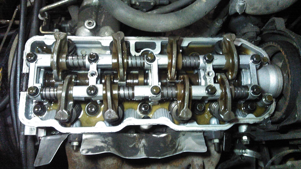

a few pics... sitting where it had been parked a couple years ago, inside the valvecover(SUPER clean!), my goofy homemade dogleg ratchet (made for ford 4.6 top starter bolts- also worked for these mast pivot bolts to get around hydraulic lines- this thing has got me out of a few tight spots), son #3 helping torque the wheels back on as my shoulder has been screwed up all summer... will add some more pics once repainted

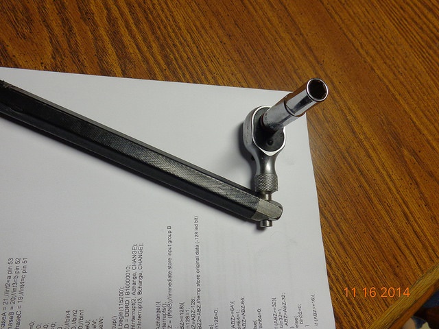

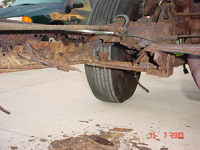

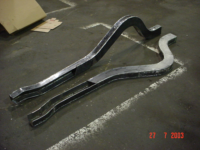

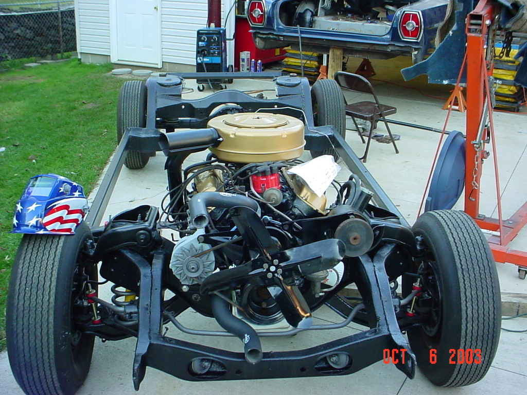

that galaxie about wore me out... spent near a year working on it...my old friend neighbor gave it to me, we redid it and tried to give it back, but he wouldnt take it...he did get to drive it one more time before he quit driving, he passed in 2004.
the 67 is a pretty car, my first car was a 69 2 door 429, still got the engine... I was never in to 4 doors in the least, nor 65s...but that goofy car of ours built a couple friendships worth more than any car :)

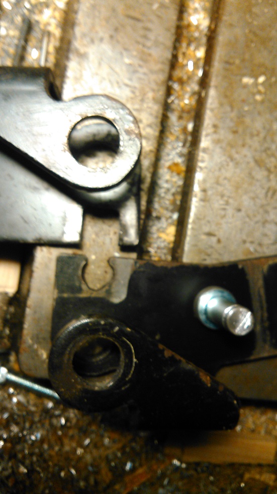

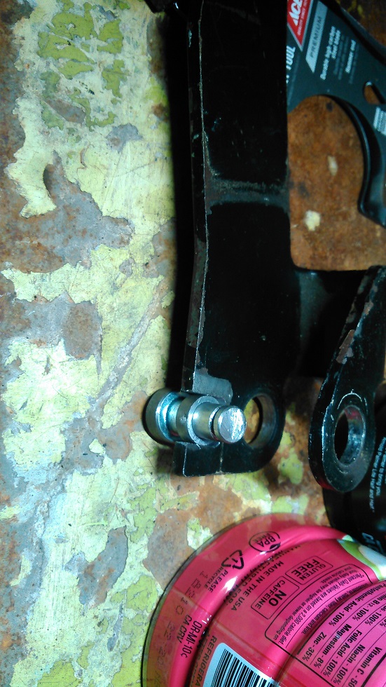

got the levers tightened up and back on, they had 2" slop, now 1/8"...a slight improvement :)
you can see the worn 'slot' vs the wider milled slot, and the pins/rollers made to replace the bolts... that leaves the steering bushings and paint

I don't know what you mean by "alpha encoder." Sounds like you might be describing a grey code absolute position encoder? If so, check out this app note from AutomationDirect. It explains how a PLC interprets grey code and it helped me wrap my head around it. and it also gives some theoretical circuits which could be turned into real circuits to decode the position.
Sorry- 'alpha' and 'beta' are just family names fanuc used- they are a proprietary serial encoder- outputs the gray code for magnet position. but in a weird serial bit pattern, then theres strings for alarms, velocity, position count since last update, and God knows what else...havent played with it for years, but its a screaming 77 bit pattern of 1's and 0's that sure dont make a lot of sense... the gray code for commutation, or simple hall pattern encoders would work if theyd fit the fanuc motor, but of course they build the mountings unique
