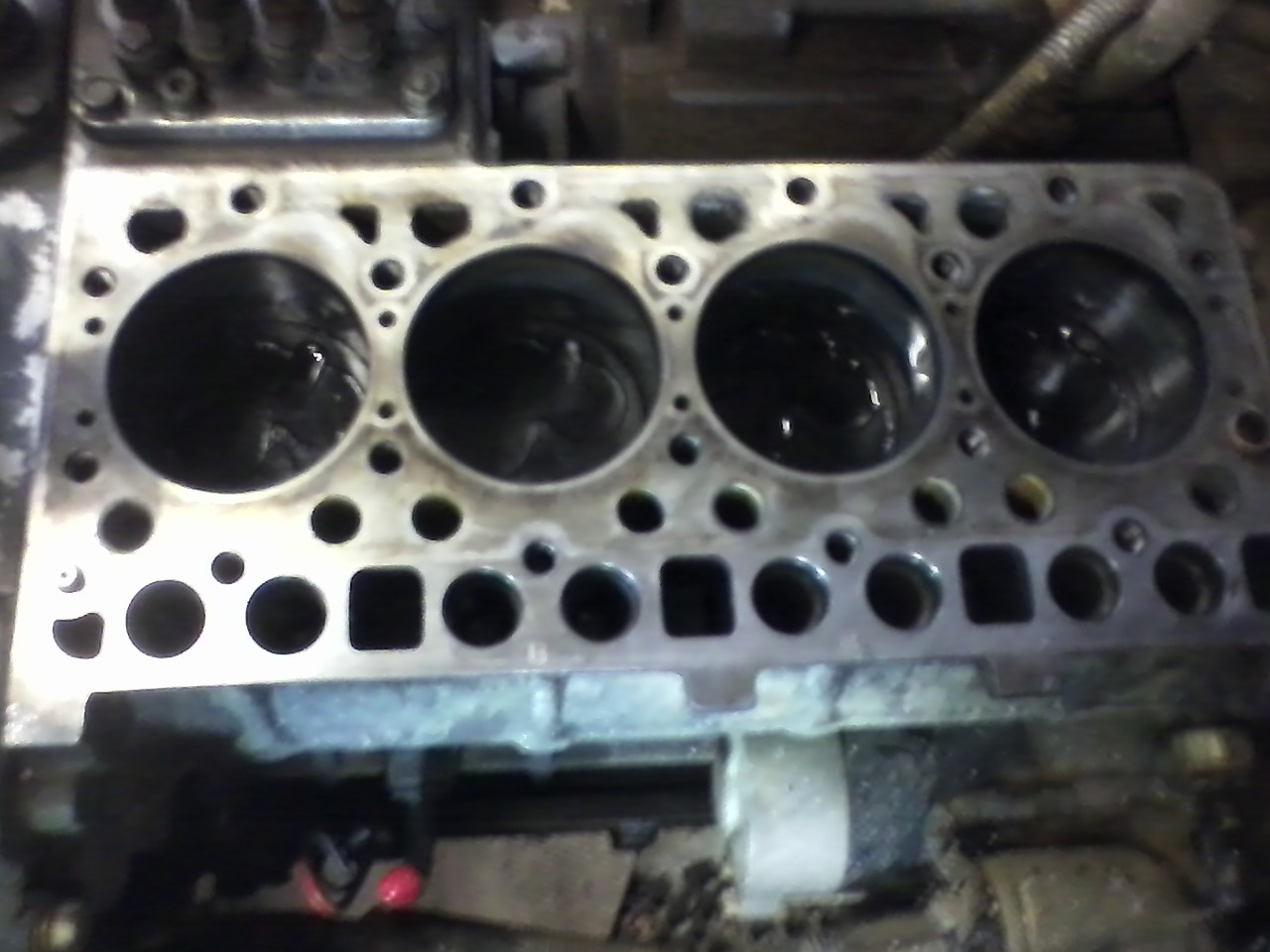

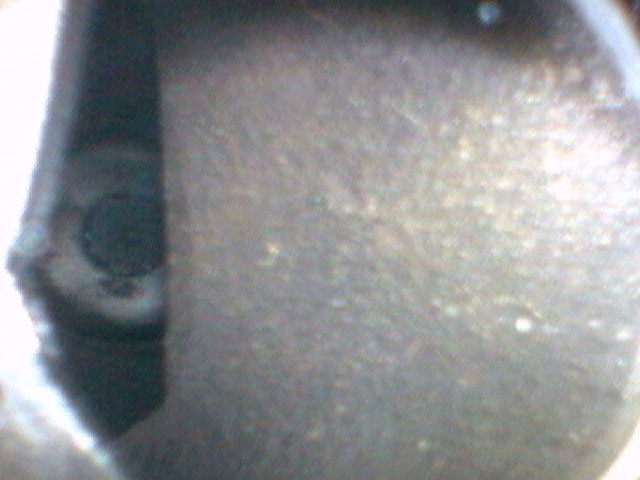

quick update, I found the issue ( I hope) the pre comb inserts were higher than the head sealing surface, gottem flattened. Using my learned machine shop apprentice days of taking a flat file before gauging, and running it over the head surface. removes high spots caused by bolt tightening and knocks off any small high spots.....I got the pre comb inserts flat, straight edged the block and head...GOOD drag using a .001" feeler gauge...took some internal coolant passage pix with my snap on BK6000 borescope. Also got some inside the pre comb chambers while looking for cracks / leaks.

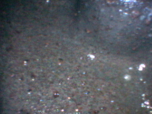

I have more, this should give an idea of inside condition though
My question is how and when do you think the precomb inserts got higher than the head surface? Do you think they have been that way since day one, or since the first head gasket blew out? What do you think could have caused it? Is it likely a factory defect, or a result of shaving the head when the first gasket was replaced, or most recently?
/ 2003 Dk50C 4A200T head bolt length
#23
CM..I didn't have the head machined when the 1st gasket let go. I DID see an area for improvement on the HG design...ALL of the small coolant hole between the siamesed cyl's are encircled with compression metal, the 2 hole @ each end are not....I can see if the comp ring split between layers, that could DEFINATELY allow compression to get into those very easily.
as for the inserts, I dont know when they "grew"...I dont see HOW they could have being compressed by the bolts and HG ???
I'm thinking improperly installed from the beginning, just not ENOUGH protrusion to cause immediate issues ??....just a SWAG on my part....STILL haven't gotten a delivery tracking or confirmation from MIE......getting parts for these is like pulling teeth I tell ya

I agree that logically the inserts have been wrong since day one. It would make sense that this is what took out the factory gasket prematurely, after some hours on the engine. Then without the problem being noticed, and left un-repaired, before the first gasket replacement, the inserts caused it to fail too. Now you've found the likely culprit and have most likely solved it. The chance of compressing head bolts crushing the gasket enough to 'cause' the insert issue is remote at best.

Hey CM...got some pics showing the discs...AFTER I "milled" em down..3 and 4 were the problem areas.
These 2 pics show the issue the clearest...I had to move around to get the light just right WO a flash.
I'm HOPING I got em flat enough to seal...certainly wont seal any worse...oh, and yes I CLEAN CLEAN and then CLEAN some more...don't like outside stuff INSIDE :)

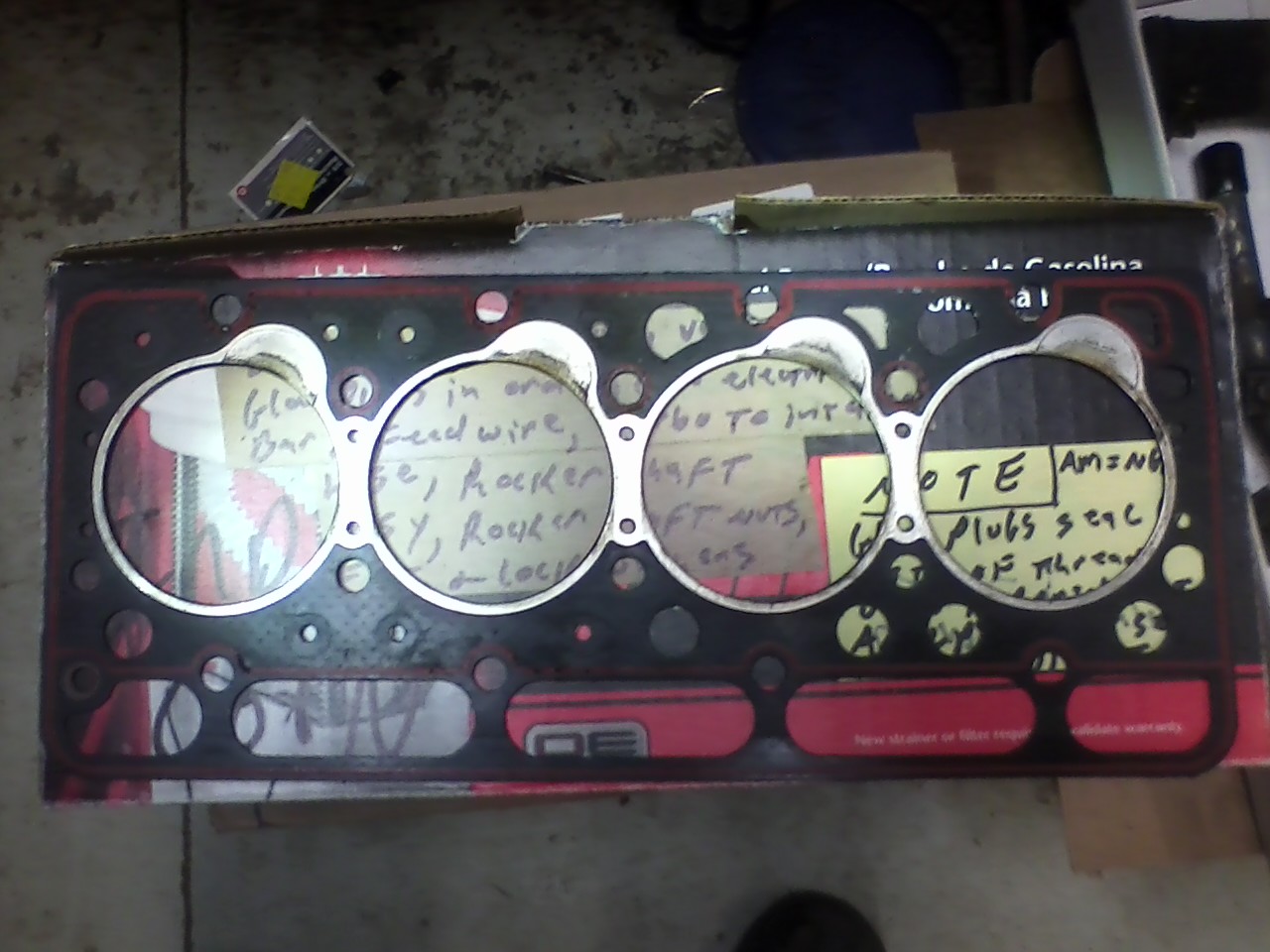

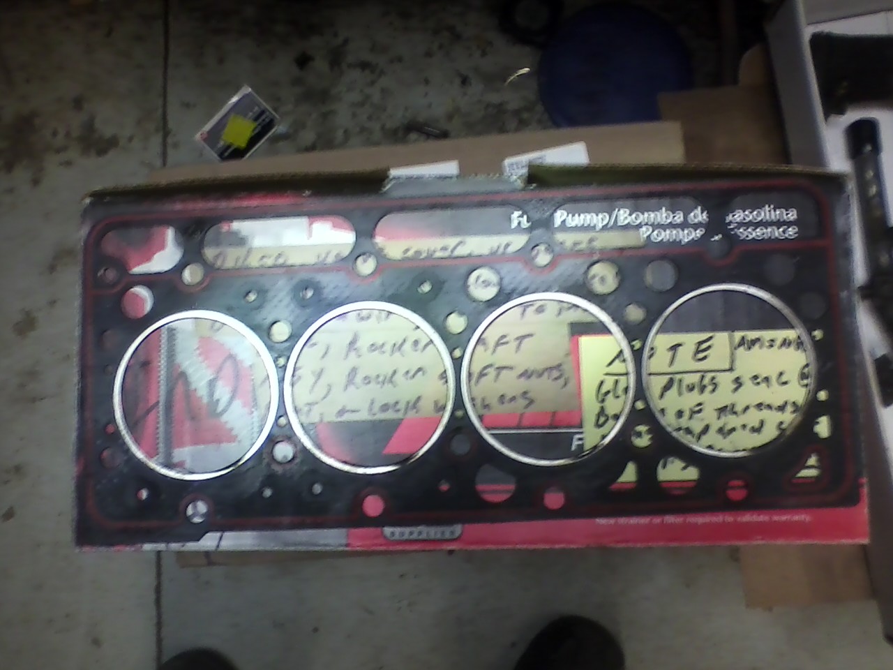

Well, there's a new and upgraded head gasket for the 4a200 series engines. It's MLS and you must use TTY bolts.
The NEW procedure for the head bolts is: torque to 28.92 ftlbs, step2. turn 90* in sequence, step 3. turn 80* more in sequence.....adjust valves and re assemble.
SO FAR working great ! INSTANT starts, less "knocking" and haven't noticed any loss of power ( the MLS gasket SEEMS thicker)....BTW, MLS head gaskets are the bomb from past experience, I was just suprized they now use them on cast iron to cast iron head joints.
here's the pics of all 3 head gaskets, top is e6500-03311, middle is 03312, bottom is MLS 03313, and the bolt change. OEM bolt next to the TTY bolt ( longer thread section)
Sorry, I forgot to remember the head bolt PN's.
When doing the final "yield" 80*'s, using my "beam" torque wrench, I noticed the final clamp load was between 65 and 80 ftlbs.
DO NOT use this as a spec thinking one can bypass the TTY fasteners, I was just making an observation of final clamping force.
If you do one, you will FEEL the bolts stretching during the yield process.
Thanks for all of the replies and suggestions. It's nice to know that kioti found it nessesary to upgrade these gaskets to MLS, obviously the old designs were failing pretty regularly ( just a GUESS on my part)
