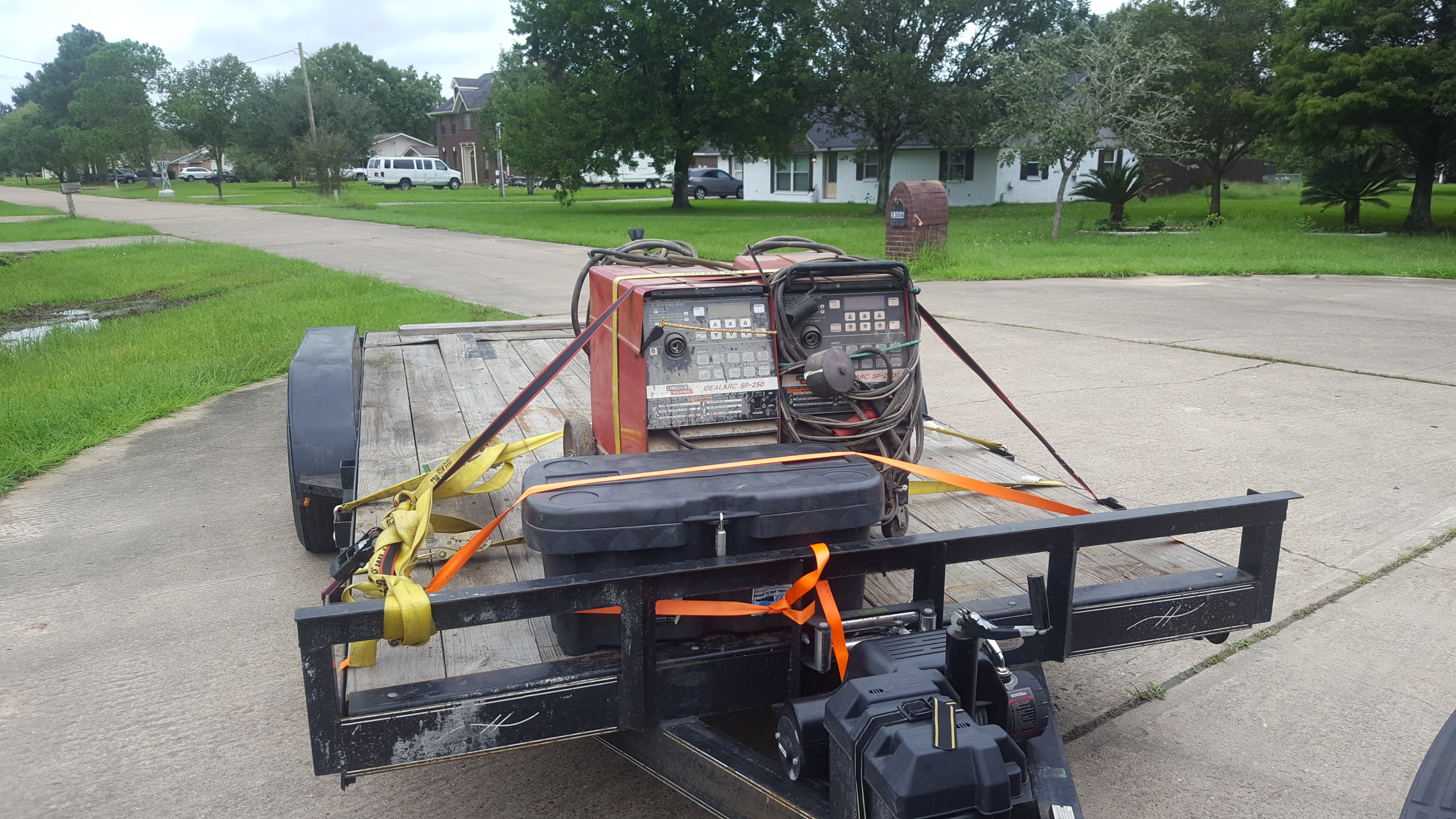

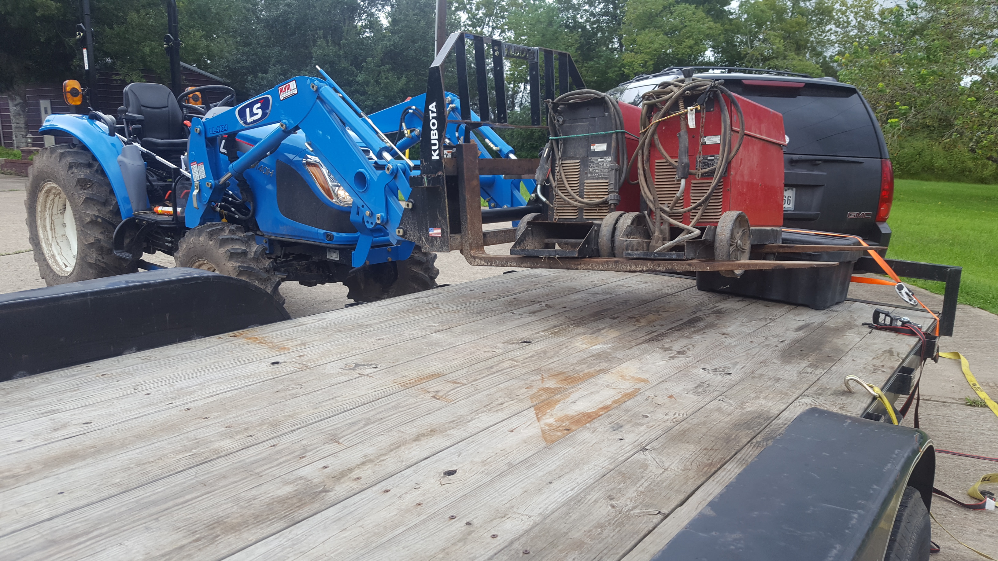

Anyway. Got to get to bed. Up early tomorrow to hopefully finish the panel I'm building so I have time in the evening to crack open these two welders I bought the other day for scrap price and see if I can make at least one good one out of two broken ones.

so, did the welders work out? :)

Your story is inspiring, and has a lot in common with my own story. Thanks for asking about the MIG welders; I got them both running, as far as I can tell running as they should. I've sank probably $500-$600 into them so far, but most of that was gas bottles, wire, consumables. They required very little repair. On one of them the plastic spooling mechanism is at the end of its life and I'll have to fabricate a new spooling system as the plastic parts are no longer for sale. Don't want to detract any further from your thread, so here's a thread I made about the welders.

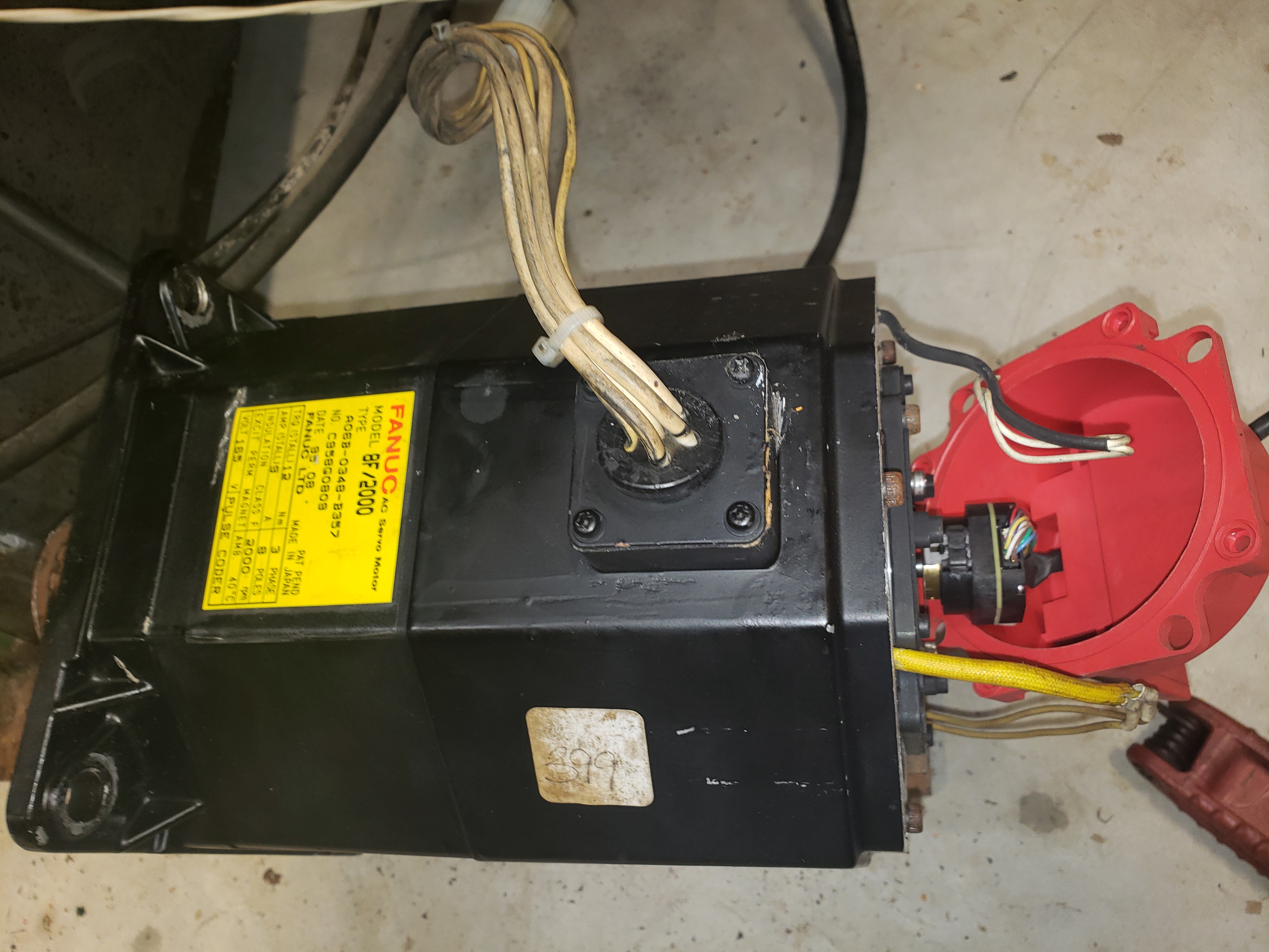

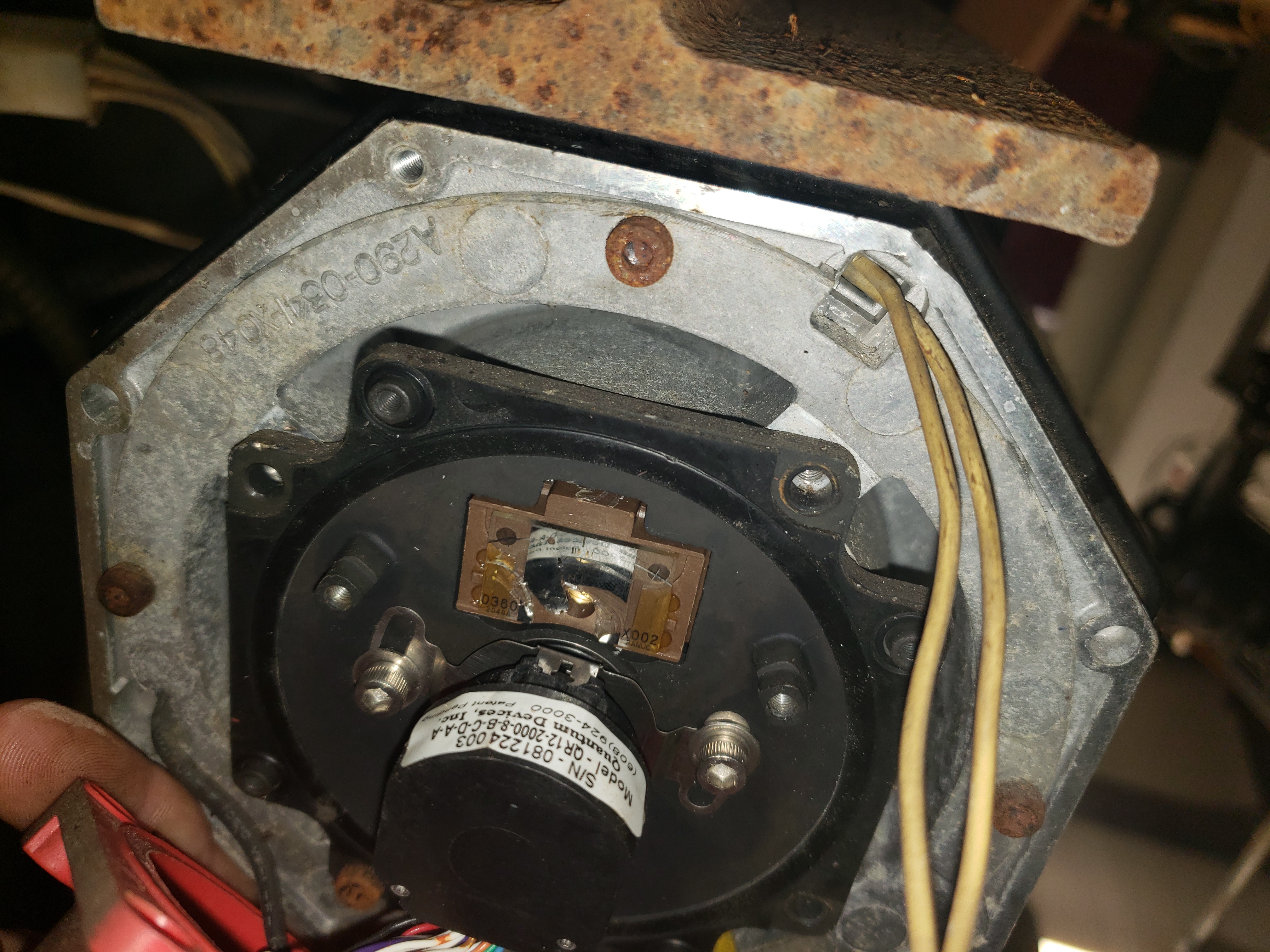

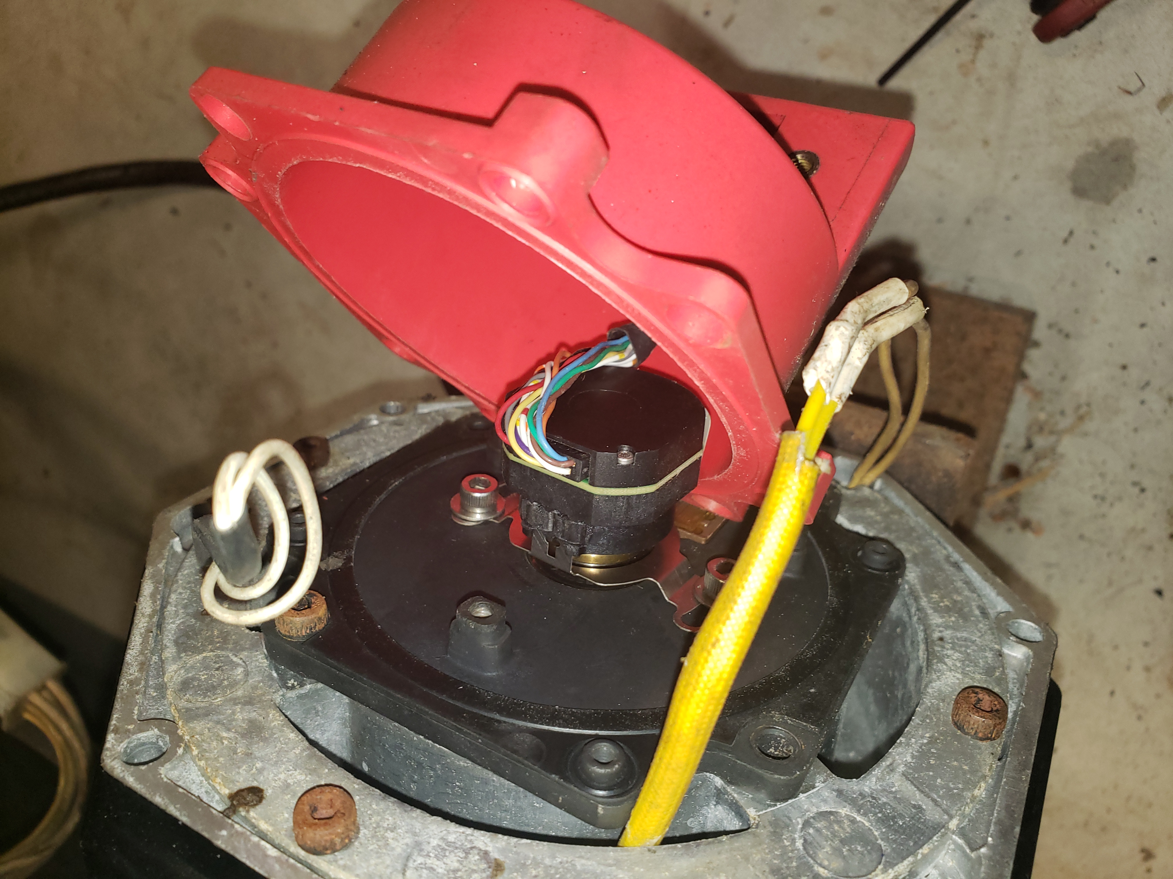

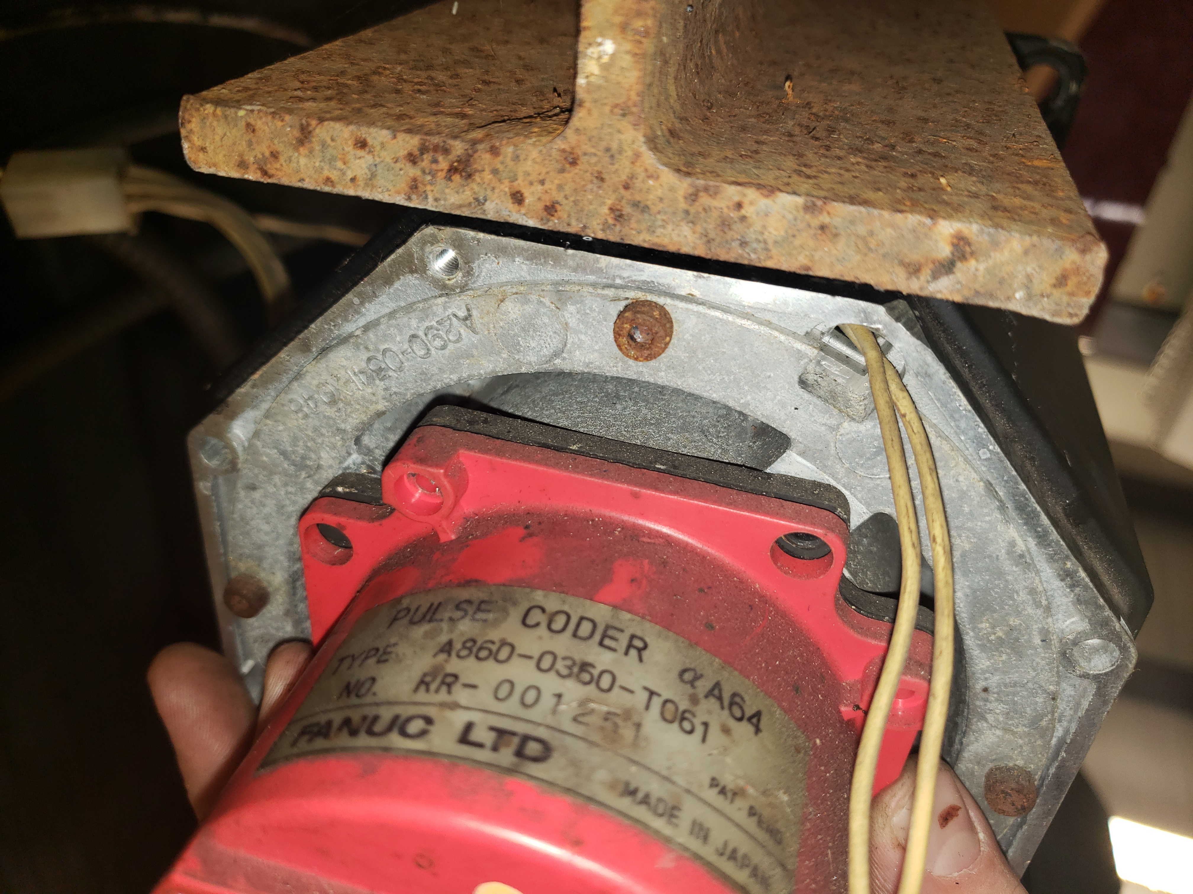

. bought a brand new fanuc robot module at HGRINC.com for 50 bucks, took the upper two axes off, simply bolting a spindle on it would make a nice, tiny, polar coord milling machine, looks like about a 8" cube could be done with a lot of rigidity...hassle is its got alpha encoders and ive yet to find a way to read them...arduino will handle the 1.024Mbaud rate(77bit stream) but the rotor position inverts at reverse
Sorry- 'alpha' and 'beta' are just family names fanuc used- they are a proprietary serial encoder- outputs the gray code for magnet position. but in a weird serial bit pattern, then theres strings for alarms, velocity, position count since last update, and God knows what else...havent played with it for years, but its a screaming 77 bit pattern of 1's and 0's that sure dont make a lot of sense...
Hey sorry not forklift related but I'm tearing my CNC apart and overhauling it. I found that the X-axis servo (Fanuc) has an alpha encoder. Curious how the last guy made that work, I pulled it apart and found this cute little guy hiding under the red cap. Thought you might find this useful.
