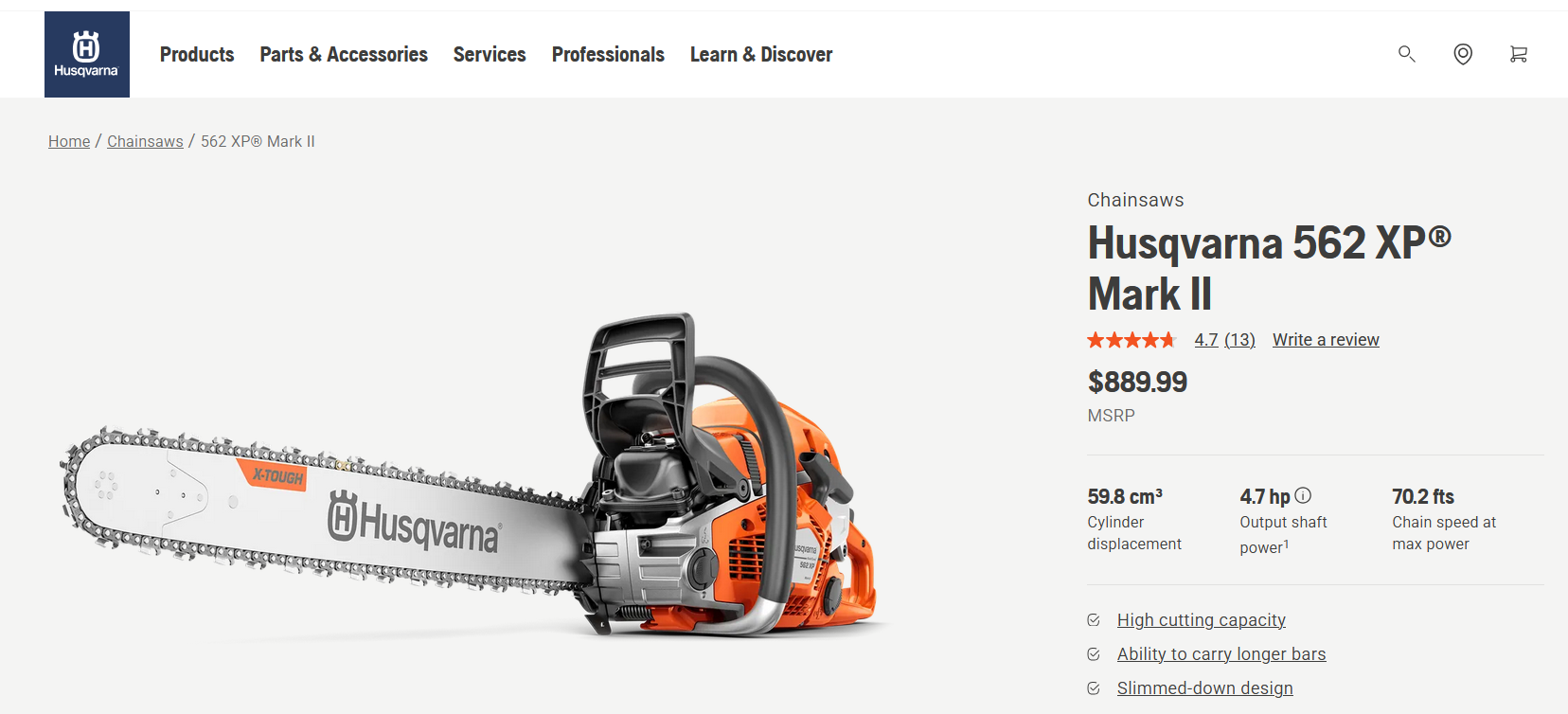

My logger has settled on the 562XP as his go-to saw. He really likes it.
I guess the whole 20" bar thing is what made me assume the 261 was 61cc saw. I think a typical bar on a 45cc saw is 16" or 18". I run 18" on mine. 20" I think is pushing it, and is a better fit for perhaps a 50 to 60 cc saw. But it also depends on how much of the time you are actually using all 20" of it. I have an 18" bar on my 346xp for the occasional times I have to cut something that requires the whole bar, but it's really infrequent. It just saves me from breaking our another saw for a cut or two. If I'm regularly cutting something that size I use a 62cc. With my 45cc saw I'm typically limbing or cutting 10-12" longs.
The 261 is a 50cc saw and a good one at that, punches above its cc class but running a 20” in big oaks taxed it and I wanted to be able run a longer bar. Put a 28” light bar on my 562 and it rips. Saves my back too.

I run Husky 562xp saws (long story why I have three of these but that's what I ended up with) with 18", 24" and 28" bars. I cut mostly Maple, hard wood, with some Hemlock and Alder here and there. I cut for personal firewood: usually downed stuff. Cut about 5 cords per year (my average based on firewood use). I've cut UP IN tree clumps, cut while on top of mostly downed (still slightly elevated off the ground) trunks (scooting on top of and cutting branches), cut on-ground and all sorts of cutting and this saw has been excellent in its power-to-weight performance, and while I'm getting up their in years I can still wield these saws for long periods of time. 18" bar on one of this makes it unstoppable (especially on my ported saw). I don't use my 24" bar much as it was for a job many years ago and I didn't know at the time whether I could pull a longer bar. Discovered that one of these saws could pull a 28" bar and I will use it on Cottonwoods; it's better to have the bar tip sticking out of the wood than totally buried in the wood. Been using a 562xp for nearly 14 years now: early version, mid version and the latest MK II [really nice!].
Tips for success:
- SHARP CHAIN (never cut with a dull chain as this will over-tax the saw; I learned this the hard way)
- Give your saw [and yourself] some break time (I seized one saw by running in very hot weather and running non-stop with a 24" bar buried in wood- up to 48" trunk- I was an animal and could essentially outwork machines!)

I haven't found ambient temps to be the issue with any of my Huskys. The MK II 562xp actually starts extremely well: Husky has made significant improvements in this saw. Early models had a compression release and Husky later dropped it as the saws were experiencing too many problems from them (air leaks). They fall kind of between a small, easy-start saw and a larger compression-release saw so one has to accept that one is going to get a slight workout when first starting them dead cold. I'll note that all of my saws tend to fire off fairly quickly as long as I follow the correct starting procedure (fairly standard across most saws).
